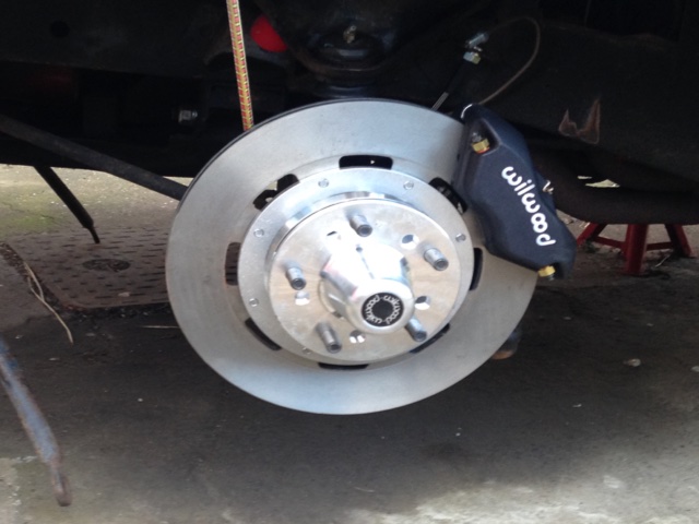

Yeah, it's a wilwood kit supplied by magnum force, I've checked the order number on their website and I ordered the right parts. Also checked the parts list and all the correct part numbers are there.
The brackets can only mount in one position, the disc does bolt to the hub ( goes to garage to check fitment of disc ) I hadn't noticed ( or realised ) before but there does appear to be two ways to bolt the disc to the hub. Guess which way I bolted it :oops:
It looks like by bolting it to the hub the other way round, the disc will be about 6mm closer to the caliper bracket.
I'll give that a try and report back.
Thanks Blue, your knowledge and ability to think things through logically may have solved the problem :thumbright:

you can put the disk on the front or the back of the some hubs when its just the spline on the studs that holds the lot together
its always the way I think it won't be when I take off the wheels but then you spot a section to whack a screwdriver in to separate the two and you know you are on the right track.
maybe just aussie hubs
I have confused myself in the past thinking something is terribly wrong when it wasn't new modern ones with a little allen bolt are easy in comparison slip over do up little bolt
Posts: 14523
Sounds like that's it then. I've fitted a few Wilwood kits over the years and never had any problems, they have good quality control I reckon. If they are still using the screw on dust cap with an O ring, make sure you grease the threads and only very lightly tighten it. They can be a bugger to get off in the future otherwise and grips don't half make a mess of billet ally...

Got both discs switched round and bolted to the hubs the right way ( this time, I hope ). Should be able to try them on the car again over the weekend.
Yes, the dust caps are still the screw on with O ring type, thanks for the tip, I'll get some grease on the threads and make sure I only tighten them finger tight.

Problem solved :D
With the discs swapped around everything lined up as it's supposed too. Another job ticked off the ever decreasing list
