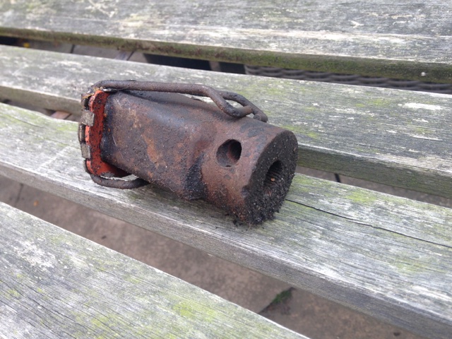

Here's the pics Miles

Cheers Nige, it looks different to mine. I have no clamp around the top and I think mine is also recessed. Might b year specific, although I reckon the internal bushing thingy is likely the same

Nige, any idea what that thingy is called?
Rebel
Posts: 2978
Post by Rebel »
It's a steering coupler :thumbright:

Is this the 'thingy' that needs to be replaced?
http://restorationpartssource.com/store ... einfo.html

Miles it's also known as a "Pot Coupler" and I bought this rebuild kit for mine from this seller
http://www.ebay.com/itm/382165125852
Would have offered you mine as I've not used it yet but it's in Scotland with the Charger I'm afraid :)

MilesnMiles wrote:Cheers Nige, it looks different to mine. I have no clamp around the top
IIRC the spring clamp around the top was an official mod that was done after the coupler was opened at any time for servicing/column removal as the Crimped on top cover sometimes popped off as Recrimping didn't always work second time around.
You can see in Nige's photos the tabs holding the top cover aren't bent correctly and wouldn't hold the top cover on hence the spring mod.

MilesnMiles wrote:Is this the 'thingy' that needs to be replaced?
That's just one part of it. The link shows the seal or lid if you prefer, the dirty orange bit on top of the coupler in my pics.
As ScottyDave said above, you can get a rebuild kit for them. The bits inside mine are from a rebuild kit. Regardless of the actual design of your coupler, I would imagine the internal parts will all be the same

Posts: 9610
there is also a reason that its a sliding coupling
it allows for flexing of the car
no slide, and the top bearing in the steering box takes the strain
