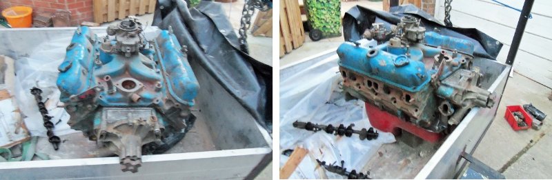

If its a early 318(steel crank,no weight on damper)its internal balance.neutral flywheel ok.
If its later(after 71,cast crank,offset weight on damper)its external balance.neutral flywheel NOT OK.
All though the only way to know really,is to pull off the sump pan,look at the crank,these are old engines,and sometimes parts have been swapped for the wrong parts,Hope this helps :thumbright:
TIB3300
Posts: 631
Location: Sheffield
Re: Cortina MK3 V8 MOPAR
Post by TIB3300 »
DaveB wrote: Wed Nov 01, 17 8:20 am If its a early 318(steel crank,no weight on damper)its internal balance.neutral flywheel ok.
I bought the engine as bits in a box's this is what I have :?

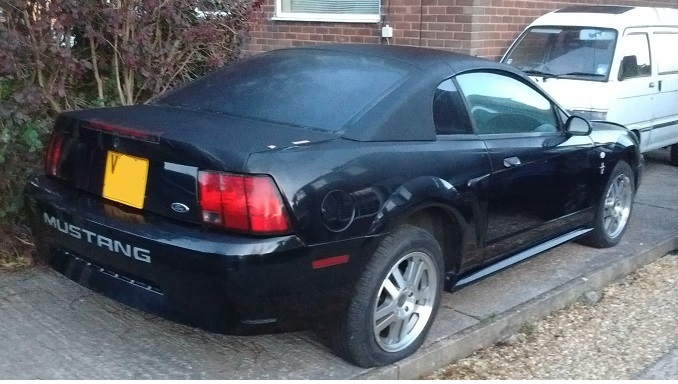

This is my donor car a 1999 Mustang for the rear axle and box,plus whatever goodies I can use :thumbright:
Rebel
Posts: 2978
Post by Rebel »
Loving the sound of what you want to do. However, I'd be just taking the whole drivetrain out the mustang and putting it in the Cortina. You'll have all the running gear ready to go, still a challenge to do but at least the engine, box, propshaft and axle will all work together and be balanced correctly for each other.
I'm not saying it can't be done, or that you shouldn't do it. I'd love to see it completed and wish you luck with it but I'd be putting the 318 in something else
'68 Dodge Charger
‘75 Ford Ranchero
'93 Toyota Hilux Surf
YouTube - Double Zero Garage
Posts: 14582
That would make far more sense, small block Ford is a much neater package to transplant and no need to adapt the transmission, it's a no brainer unless you like to make life hard for yourself!

Rebel wrote: Tue Nov 07, 17 11:57 pm Loving the sound of what you want to do. However, I'd be just taking the whole drivetrain out the mustang and putting it in the Cortina. You'll have all the running gear ready to go, still a challenge to do but at least the engine, box, propshaft and axle will all work together and be balanced correctly for each other.
Thanks Rebel :thumbright:
TIB3300
Posts: 631
Location: Sheffield
Post by TIB3300 »
Blue wrote: Wed Nov 08, 17 6:17 am That would make far more sense, small block Ford is a much neater package to transplant and no need to adapt the transmission, it's a no brainer unless you like to make life hard for yourself!
"more sense" "no brainer" "make life hard for yourself"
What some of you don't seem to understand is, this is not just about putting a V8 engine into a Cortina. Yes I could make my life much easier on myself . By going to see a friend of mine who has a 302 Ford in his Mk3 cortina and copying what he has done. But where would be the challenge and fun in that ? :scratch:
I Love to build and yes challenge myself, don't know why? Just do, :help:
Posts: 14582
By all means do it the hard way if that's what you want to do, just pointing it out that the end result if it's a success will be much the same.
