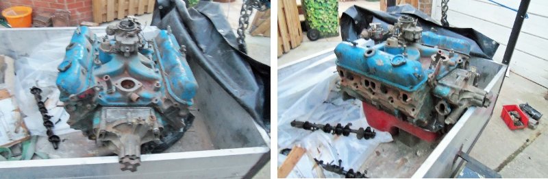

"externally balanced"
Yes I read about that got a little worried at first :pale: If the crank is balanced as you say internally and externally.
If I was to put a flywheel on to my engine from another engine? and if that flywheel was neutrally balanced this should be fine?
Re: Cortina MK3 V8 MOPAR
Posted: Wed Nov 01, 17 8:20 am
by DaveB
If its a early 318(steel crank,no weight on damper)its internal balance.neutral flywheel ok.
If its later(after 71,cast crank,offset weight on damper)its external balance.neutral flywheel NOT OK.
All though the only way to know really,is to pull off the sump pan,look at the crank,these are old engines,and sometimes parts have been swapped for the wrong parts,Hope this helps :thumbright:

I bought the engine as bits in a box's this is what I have :?
