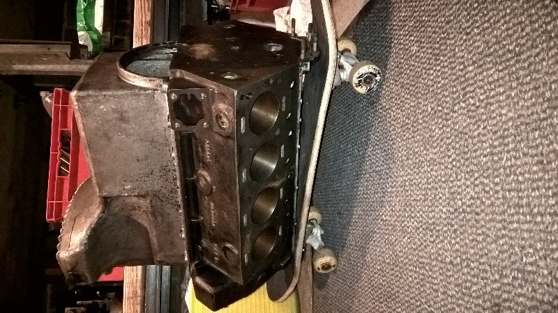

So I'm picking up a Daimler hemi on Monday.
I'd intended Mopar power originally but this has come up at a good price, it's looks to be in great condition and, well it's a HEMI 8-)
I know these motors have a lot of potential, I'd love to go blown / injected/ methanol route. Obviously I have a lot to learn!
Does anyone have any experience of these motors?

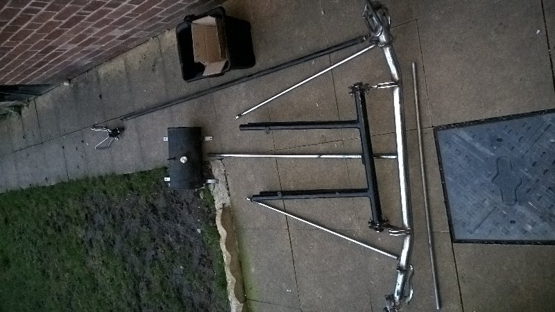

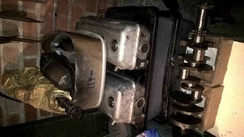

Posts: 8368
Re: Nostalgia blown Daimler Hemi slingshot
Well things are progressing! I'm gathering a nice little collection of parts already...
