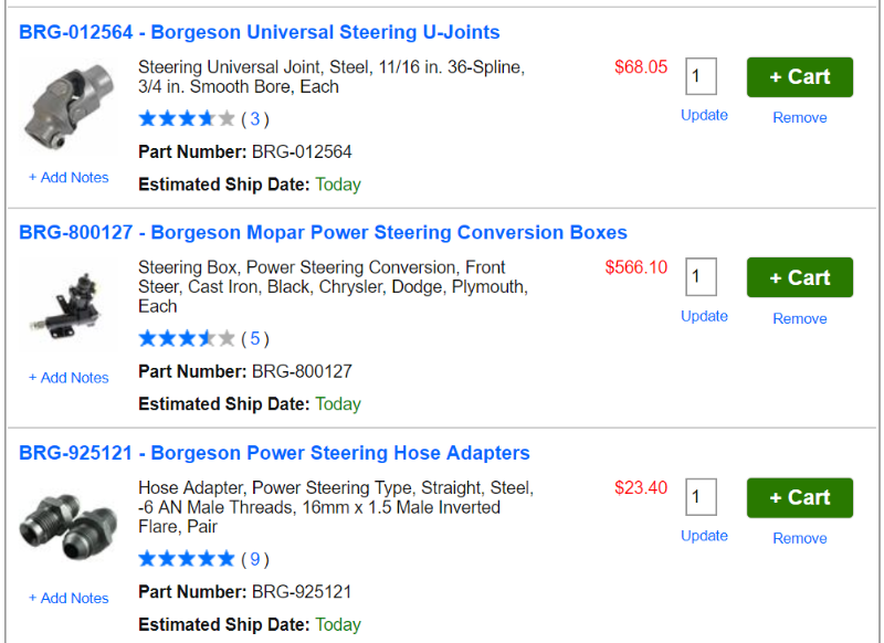

After lots of reading Bogesons modern box is a no brainer !
I even like the driver's review a bit heavy and no more 1 finger parking!
The cheapest way i can see of doing it is cut and shut steering column. (i bet you could do it in the car in place)
I did this mod already onto my standard steering column as the original Chrysler UJ thing is Bananarama!.
AN- Brained hoses to pump but I already have these.
Box is 11/16 in. 36-spline
Box Fittings are 16mm x 1.5m Flare
Summit shopping list below but will have to wait a while for me as financial haemorrhaging with Jade.

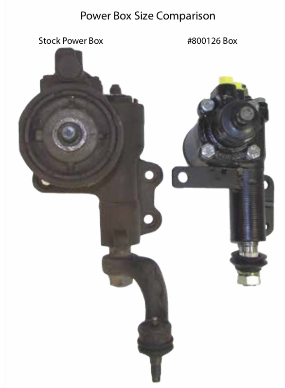

Re: Firmfeel steering ?
- 817AD500-8833-4B98-A087-127735BFB2C5.jpeg (59.3 KiB) Viewed 4184 times
OOh... Look at all that lovely clearance !
THere's been a lot of discussion over a few years on Moparts about the Borgeson box.
Some people have no issues, some experience issues either with the 1)axis alignment or 2)clocking of the pitman arm, and the steering column.
The mounting ears/brackets are welded onto the steering box. I'm sure it's strong, and professionally done, but I still don't like the thought of it..
I heard a rumour that Borgeson were working on a custom outer case to accept the internals, which would eliminate any welding issues.
If you're considering using a Borgeson box it might be a good idea to speak to Bergman Autocraft who sell the product and stand behind it.
