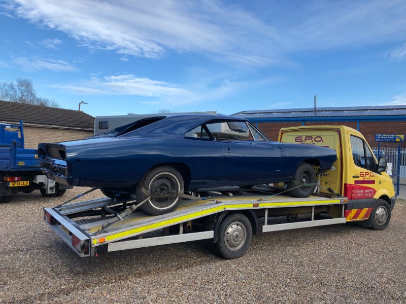

dads mate Gary picked up the car and took it it Mark's for 5 days

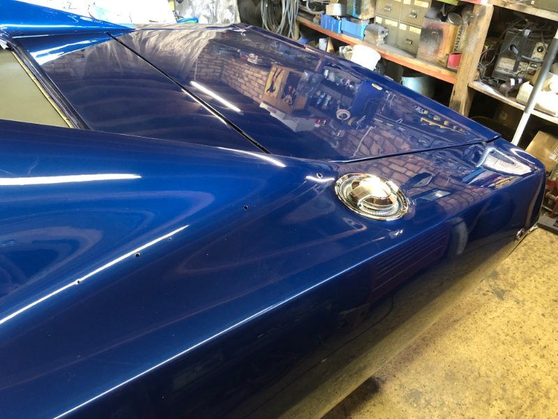

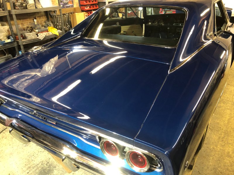

got a call from Mark asking us to come and have a look at the car . we wasn't sure if this was good news or bad . pulled into his yard and the cars standing out side . a very dull dark day but the paint looked amazing . had a good look round and very pleased . looks wet like he's only just finished but Mark insisted it still needs buffing
Re: 68 charger project
Posted: Tue Oct 29, 19 8:49 pm
by ROB
a couple of days latter and were back with Gary to pick up the car
by the time we get home the suns out and that blue is stunning in the sun

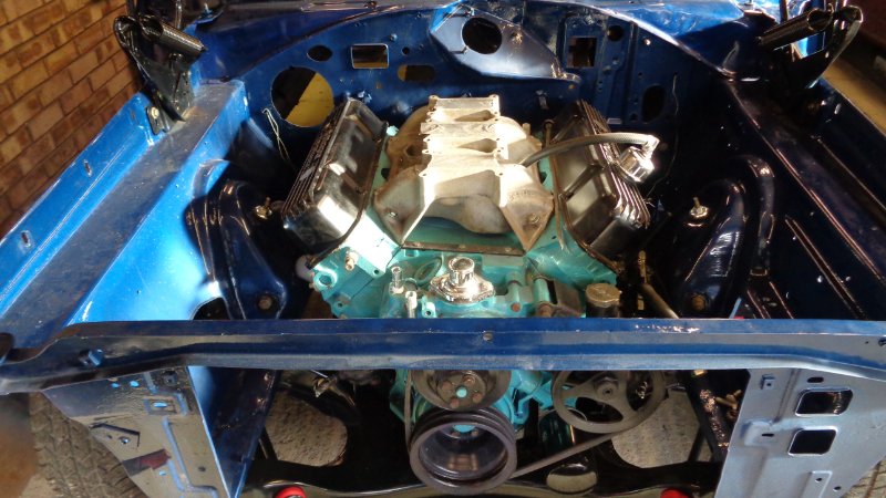

wings and hood off. engine and box in
chrome starts to go on . still buying more stuff as we go along , bits we originally intended to clean or refurbish now look out of place against all the other new stuff

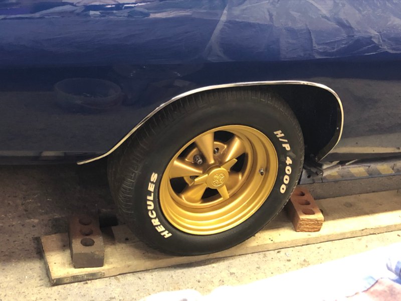

we had a set of crager ss wheels in the shed, the chrome was shot so dad got them blasted and powder coated ( still open for debate on chose of color ) need to get it outside and stand back and have a look

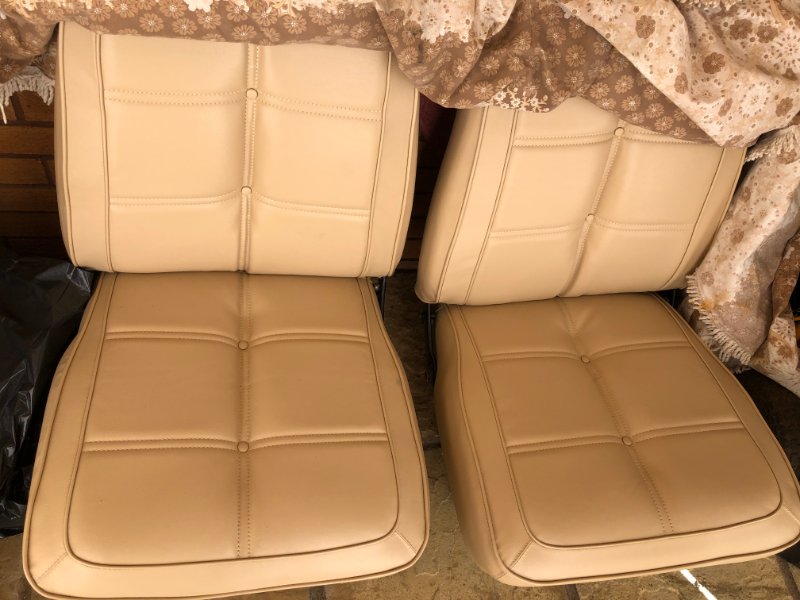

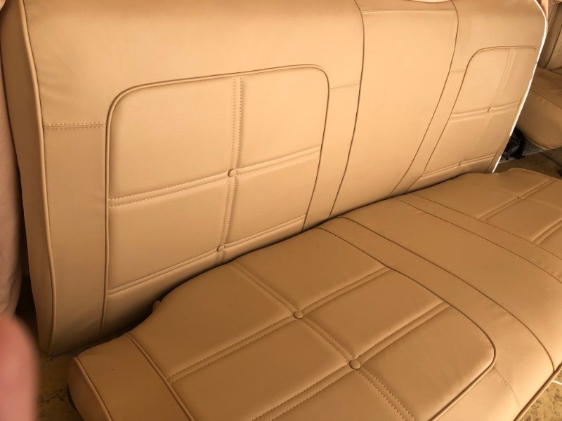

when we purchased the car it came with a set of legendary tan seat covers , door cards and carpet . the seat foam had turned to dust so we had to get new.
gave the seats and covers to a friend how upholsters for a living

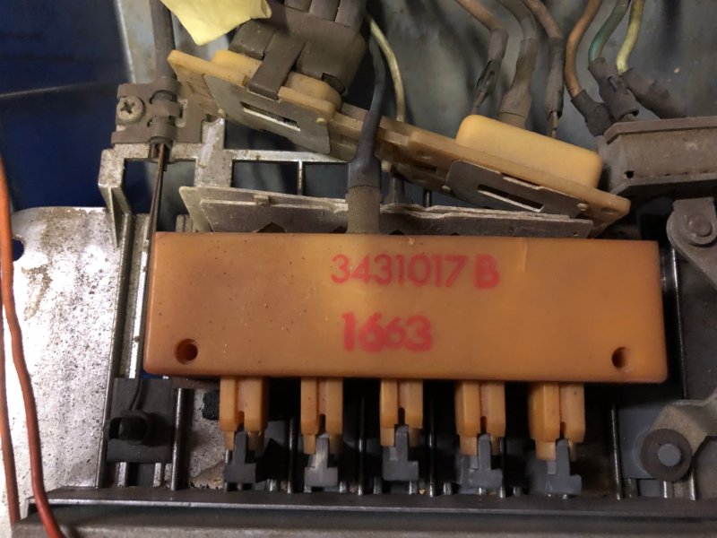

with the dash all stripped out time to remove the clocks and wiring ,took them home with me so i had something to play with between visits to dads ,

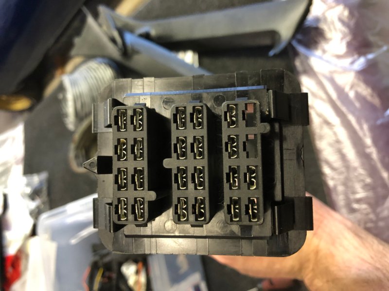

checked the wires over and found the bulkhead connector was showing signs of wires getting hot and melting the plastic so decided to order a new bulkhead connector and new wire terminals . soldered on the new terminals to make sure of a good connection
, new bulbs and fuses and rap the harness

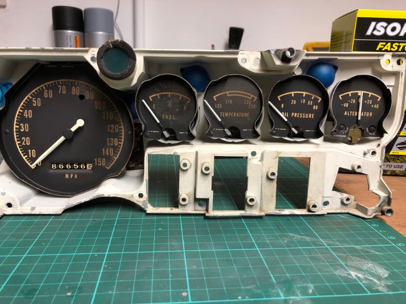

the clocks looked a bit grubby so ordered a set of transfers for the faces , fiddly job but worth the effort .

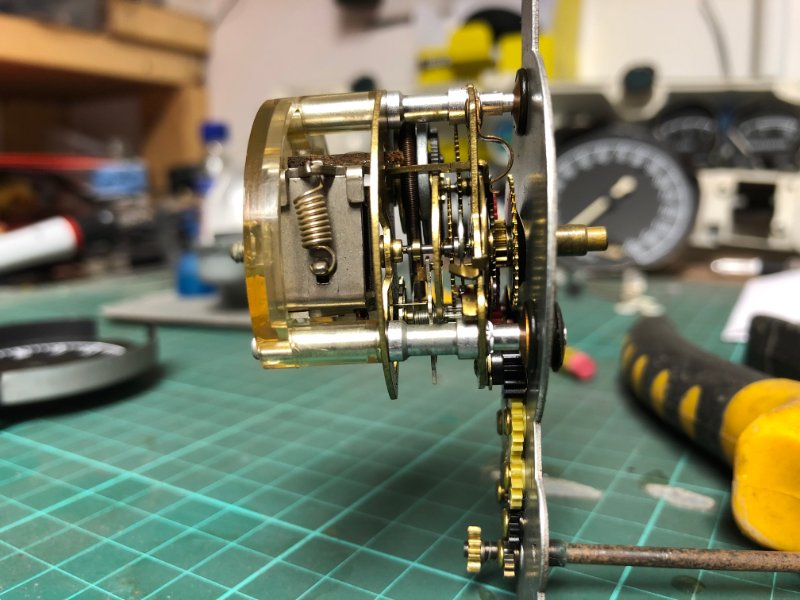

the speedo would stick when tested so the spear out of the clocks we got from Dave was put to use
the clock was not working ( surprise surprise ) striped that down and got i moving
the heater control had fallen to bits so something else to replace
a new head light switch and dome switch , spray the fascia black and with a steady hand got round the edge of the clocks with some liquid chrome paint pens
