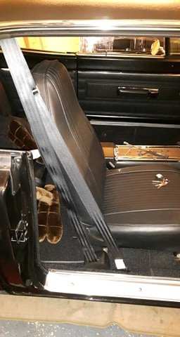

Yesterday I installed one of the seat belts Drew got for me.
Like everything these days it was not quite as straight forward as the instructions that came with it suggested.
It came with a lot of hardware for cars that never had seat belt provision at all and the instructions reflect that.
However when it came to mounting the inertia reel to the Plymouths standard floor mount it wasn't going to work.
The answer was pretty simple. I just had to twist the top mount and lap catch around on the belt so I could mount the inertia reel the opposite way around to the way it comes.
Fit is OK except in two areas:
First is the short buckle strap that mounts to the driveshaft tunnel being a bit to short. The stock mounting holes are way back so unless the seat is way back the buckle is behind the seat. I have long legs so my seat has to be back anyway. But a shorter person would have to weld in one of the supplied plates to provide a mounting point further forward.
Second is the old problem of the shoulder belt riding too high on the shoulder and rubbing the neck. It needs one of those things Dave999 was talking about. Maybe when this virus thing dies down I will see about getting a pair.

Nice. Exactly what I need to do (but likewise, with the Dave-drop-links - almost feels like a group buy).
Why are there huge-brown-furry-clown-slippers in the rear footwell ?

That is the 5-foot stuffed Roadrunners feet that came with the car.morgan wrote: Mon Mar 23, 20 9:29 am Nice. Exactly what I need to do (but likewise, with the Dave-drop-links - almost feels like a group buy).
This is not a bad belt system for $215. Much cheaper than reproduction stuff.
