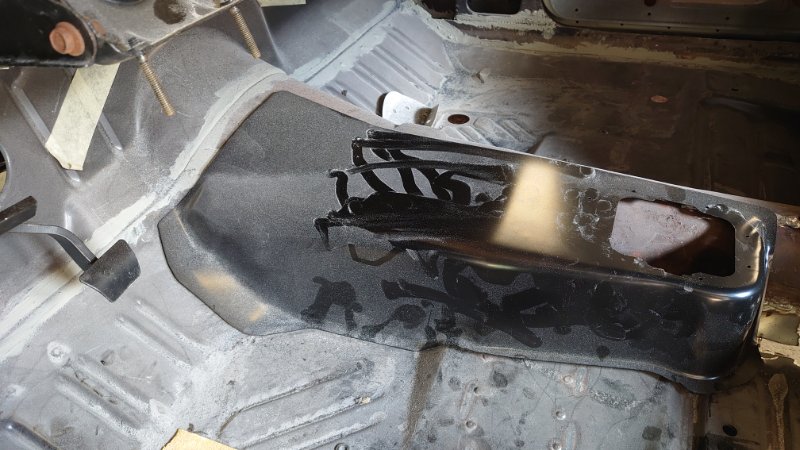

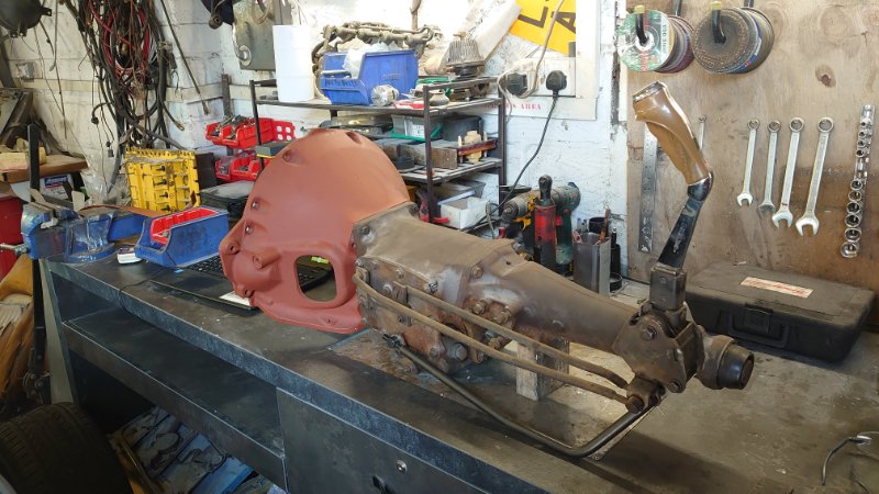

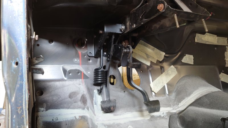

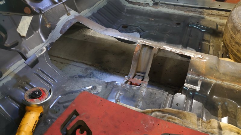

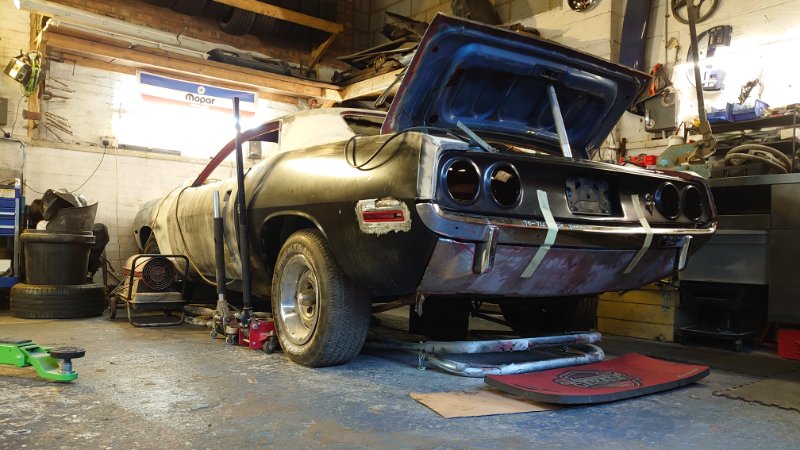

Not much in the way of updates at the moment. I've managed to get the 4speed tunnel mounted and welded in place, and the parts for the transmission finally arrived. Dan at Brewers performance was incredibly helpful with sourcing a bell housing and the necessary hardware to get it mounted. I'm still waiting on a few parts for the clutch linkage but there's stills plenty to do before it all goes together.
The boot floor is 99% complete but the rear quarters and rear valance are still taking a while for me to get to a point I'm happy with. There's been a lot of cutting, trimming and panel beating to get the gaps nice and even but with so many different panels having been replaced, you can imagine, it's very time consuming getting it all to a point I'm happy with.
Still, some progress is better than no progress right?
