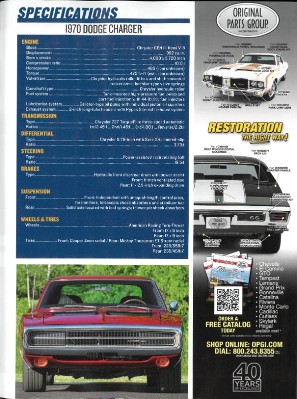

Hi Morgan,
Saw this article in the latest Hemmings Muscle Machines and thought of you...
:-k
70 Charger gen3_4.jpg (141.35 KiB) Viewed 945 times

Post by morgan »
Thats interesting. He used a 727 gearbox so didnt cut any tunnels about; needed a manual valve body.
The ECU etc seem to be aftermarket and available. All under bonnet (some of the breakers yard engines are mated to the donor car and come with all sorts of dashboard gubbins to make it work).
