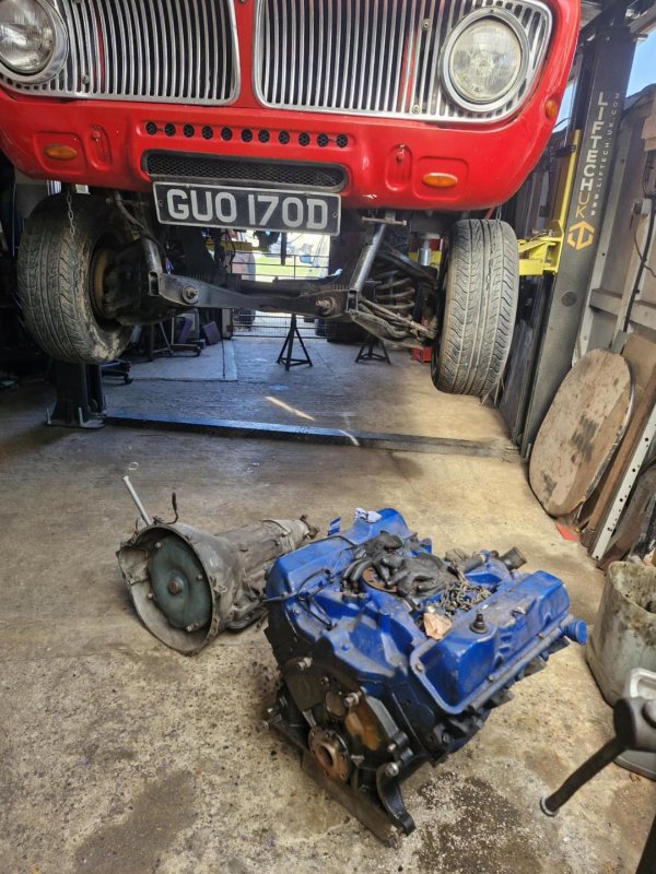

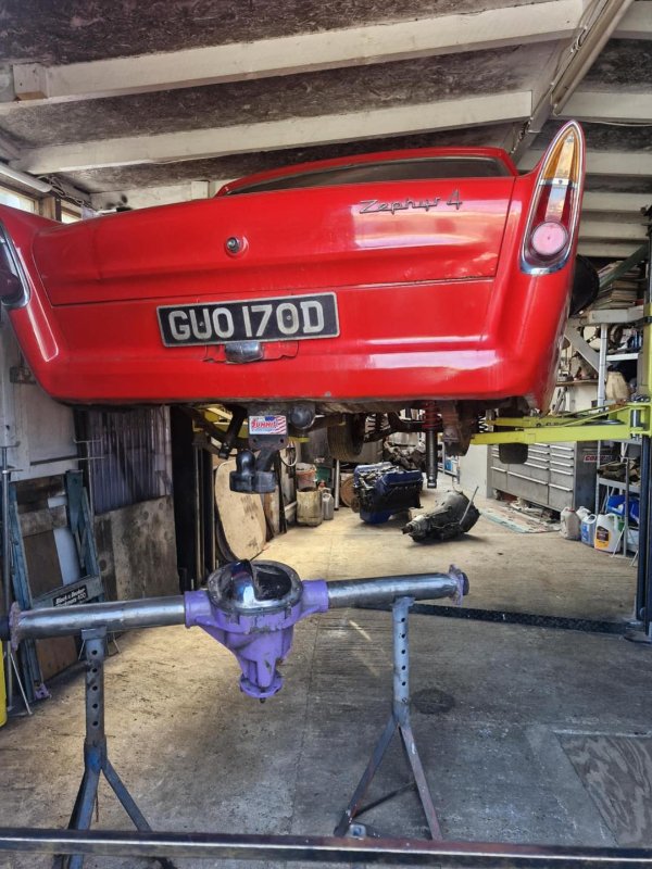

so far we dropped the exploder axle off of the zephyr, removed the discs, calipers and halfshafts followed by the seals and bearings from the casing. next we marked and cut the needed 2 7/8" from the long side allowing a second short side halfshaft to be used. this is a common swap for mopar a bodies in the usa (i did it for my valiant) as with 2 short shafts it ends up almost exactly the same width as a very expensive a body 8 3/4 axle. plus you get 31 spline 'shafts, lsd and disc brakes as stock, what's not to like. while we wait for the new bearings and seals we'll get the flip front off and stored so we can get on with mocking up the engine and box.

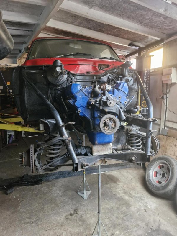

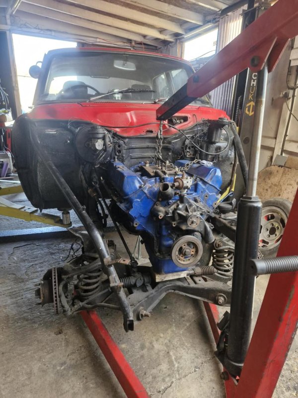

we did some more today, the engine and box are bolted together after sorting bellhousing bolts (sbc head bolts, lol). the flip front is off and over the road and lastly the engine and box are sat in place levelled up waiting for the new mounts to arrive. the gearbox crossmember will need altering (for the 3rd time) but that's par for the course so not a problem.

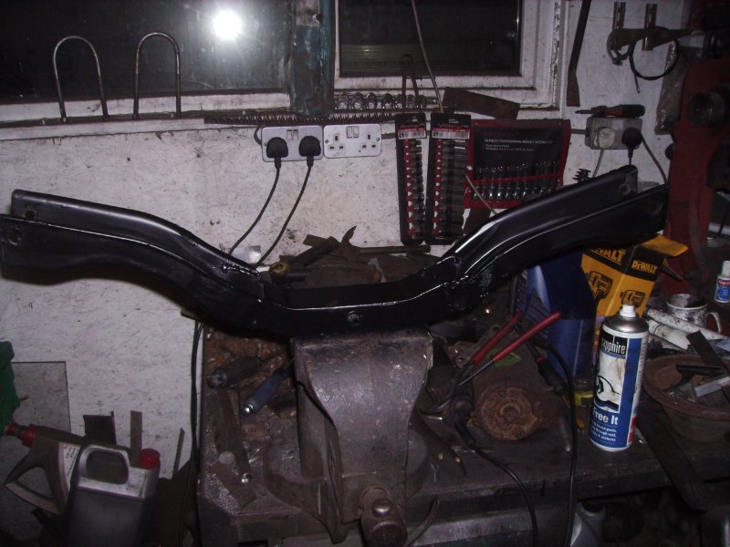

about all that could be done while waiting for bits from the states is the gearbox crossmember. so a new centre section made from 2mm sheet with a tube welded in the middle was spliced into the ends of the old/original zephyr crossmember to marry up to the c6 mounting. nothing exciting really, that crossmember has had a zephyr 4 speed box, an fmx, a c6, a th350 and now another c6 but a different mounting. poor old thing's had a hard life, lol.
