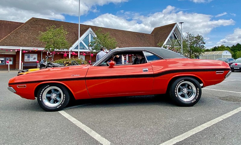

Pat Rooney wrote: Mon Feb 20, 23 9:39 pm Can anyone tell me if MMA members get a discount at North Hants Tyres?
Not to my knowledge but they will be a bit cheaper if you pre-order and collect at the Swap meet at North weald.
I have 275 x 60 x 15 on the back of the Cuda and as ever the trick is getting the back-spacing right... and the right rear springs of course!!!

Re: Wheels and tyres
Posted: Thu Feb 23, 23 2:30 pm
by Stu
That’s a monster of a stance, Pete. :rr:

Just mount the tyres with the white letters on the inside of the rims, that's what I did on mu 'Cuda.
Posted: Fri Mar 10, 23 1:05 pm
Good stance Pete.
Was thinking of superstocks on the back of mine.
Posted: Fri Mar 10, 23 1:36 pm
by Pete
Thanks.
I have 275 x 60 x 15 on the back, and 215 x 70 x 50 on the front to balance it out a bit.... plus the Super Stock springs.
Extra heavy Torsion bars on the front and HD ARB.

My 6 Pak Super Bee at the Nats - but with "Big and Littles" on it and - as ever - Superstock springs.
Coronets can take a very wide wheel and tyre on the rears if the off-set is right. These are 8.5" ARE's but with a 30 x 12.5 tyre on them.
Pictures stolen un-shamably from Sean Middelton, hence the Proto credit!
