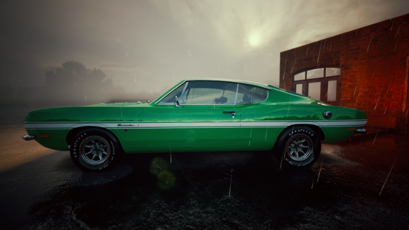

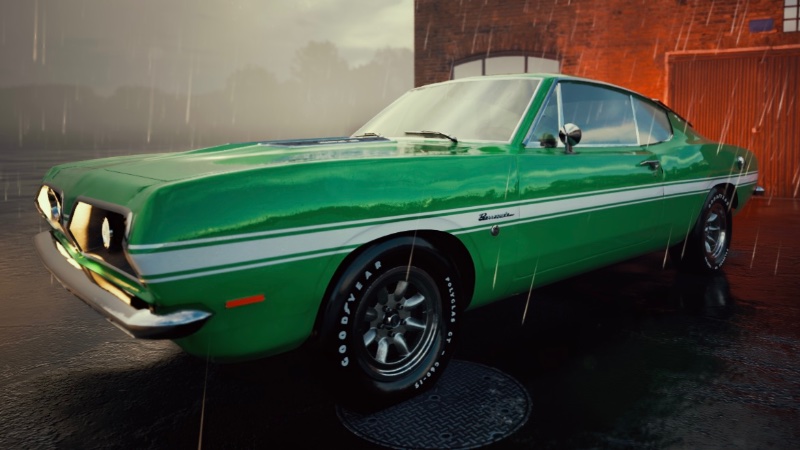

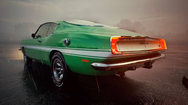

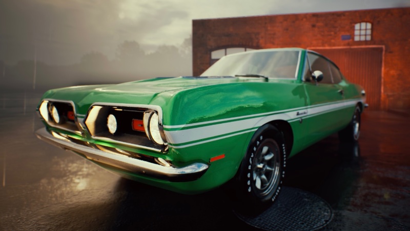

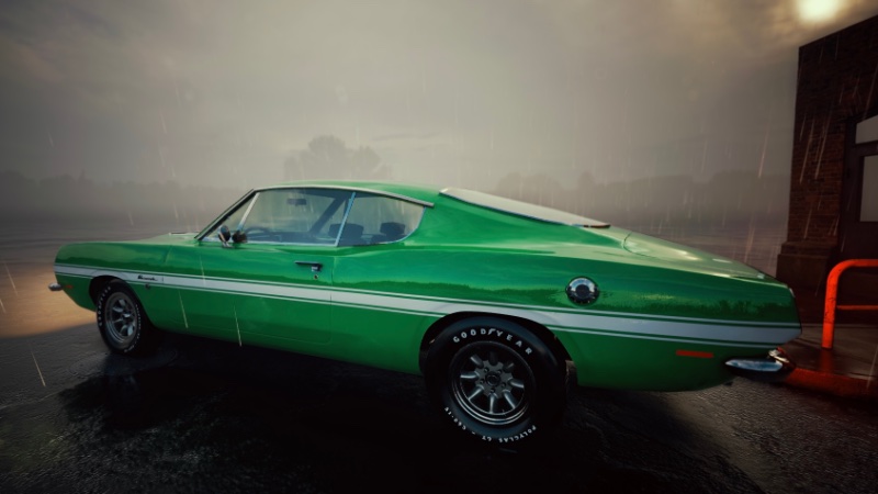

Up front I think if I can make it work my ideal would be a 7” rim for the vanity reason that the spokes on a 7” Minilite finish inside the rim rather than creeping over it which I prefer.
Minilite provide full size sectional drawings of the rim with the offsets and backspaces marked on, so I think the safest thing to do would be to construct a jig from these with the tyre cross section as well and physically test in situ. As you point out on paper and in the flesh are very different so measuring and testing first will be essential to spare my wallet.
Sorry for being a saddo, but here’s some more renders I did to see how the Minilites would look, oh and a speed stripe for fun😀
