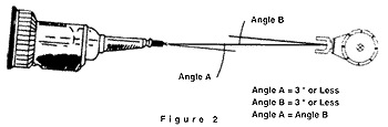

Dana manual prop alignment
db wrote:http://www.how-to-build-hotrods.com/dri ... angle.html
Lots of good techy stuff on this site
Dave wrote:I go by this little drawing.
- 3033_462.gif (3.24 KiB) Viewed 20661 times

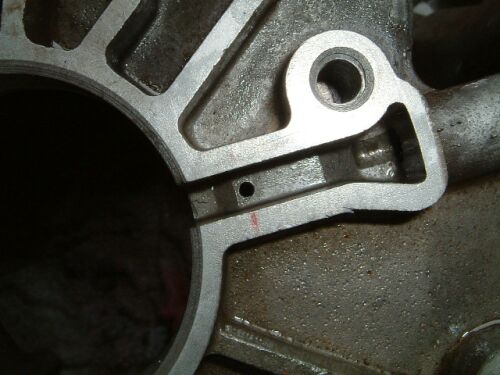

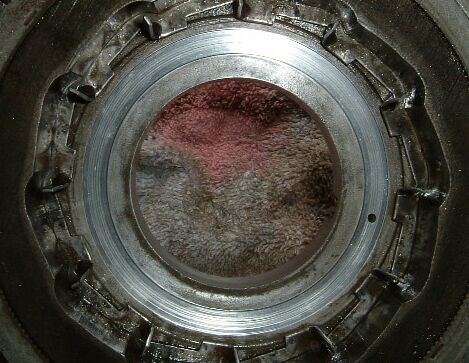

727 gearbox
The front port is the oil from the converter out going to the cooler, and the rear port is the return from the cooler going in to the lube circuit.
Size of thread in gearbox casing is 1/8 NPT
The factory oil lines are 5⁄16-inch pipe
- Dave-R
- Posts: 24752
- Joined: Sun Apr 18, 04 11:23 pm
- Location: Dave Robson lives in Geordieland
- Contact:
If you ever have the box apart, drill a 2mm hole through the case just inside of that rear return port from the cooler. This will oil the back of the overrunning clutch, keeping it cooler and stopping it from wearing into the back of the case.
If the overrunning clutch ever fails your transmission will explode.
