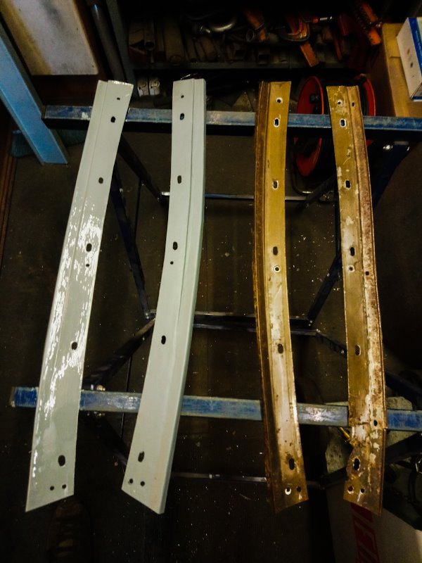

Here we are, this here is one of the A-post gutter pieces that fits to the underside of the post and is actually the worse of the two.
Thought there'd be no chance of easily finding replacements so decided to try making them and might aswell start with the worse one.
don't think it turned out to bad, it aint perfect but reckon its an improvement on the original.
Posts: 1680
Re: Lots of Love Needed (A Tall Order)
TaDa had a couple of hours in the cave on Saturday afternoon and made the opposite piece, have to say I'm pleased with how they turned out. Hopefully they will fit.
