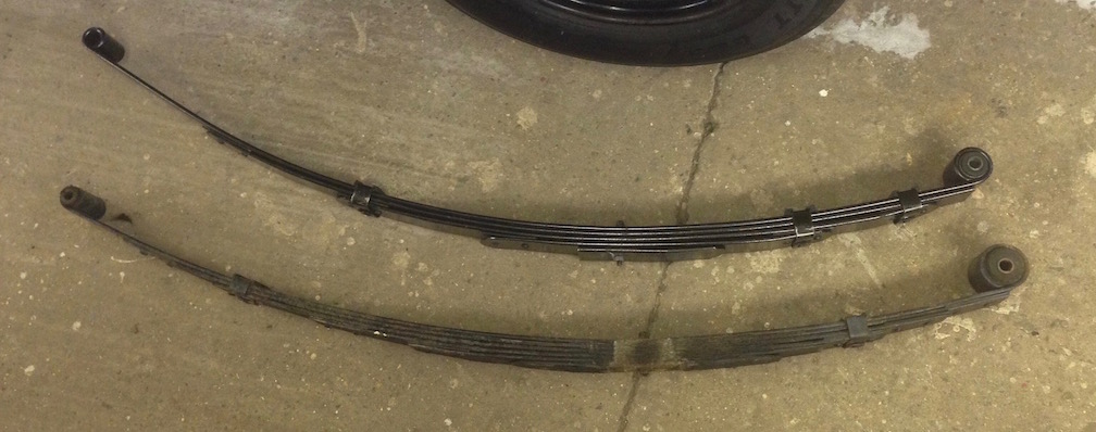

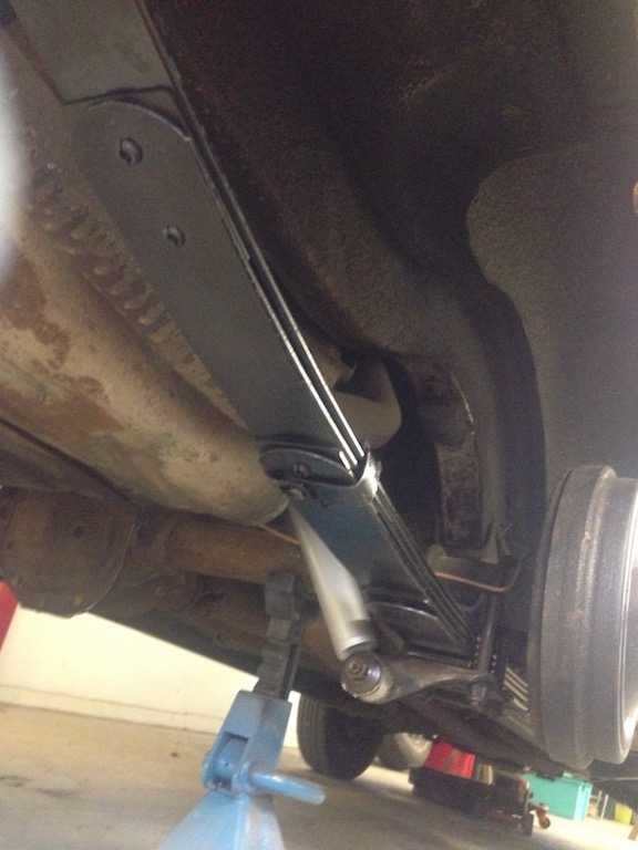

Fitted a pair of "002" & "003" super stock springs as fitted to the Hemi A bodies. You can see how much these differ from a stock spring, it's not just a higher ride height. As this is a street car I used KYB shocks instead of the usual longer drag shocks. A pair for a Dodge Dakota were long enough with just the tube to press out of the top bush and a couple of washers either side and they bolt right in. I didn't buy the cheapest rear spring bushes, instead I went for AC Delco which I thought would be decent quality, they are too loose in the spring so don't buy those....

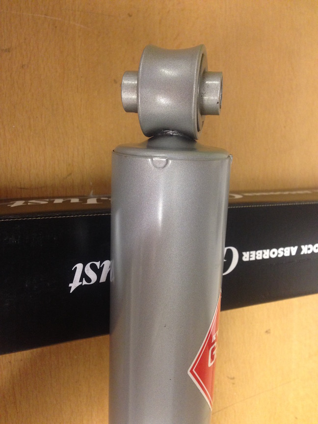

Out of interest Blue , how did you get to the Dakota shocks ?
:read2:
Posts: 14647
Mancini list a KYB shock for use with S/S springs, when I checked their part no. that was the original application so I ordered a pair from Rock auto when I was getting some other stuff.

All I did was use a hydraulic press to push out the tube, removed the shock stud from the car and pressed that in instead with a couple of washers each side to take up the width. Job done no need to use a different bush, the tube and the stud are the same diameter.

I guess the Dakota shocks were an inch or so longer?
Posts: 14647
More like about 3" longer, the standard shocks are way too short.

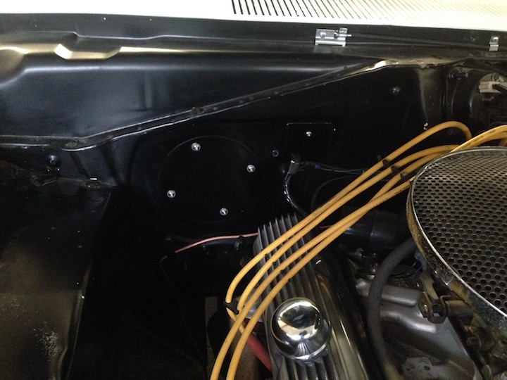

I tried, I really did but it's just no good, heater delete is the only way forward...
Posts: 22248
That Radio looks heavy.
You can see which way this build is going.....
Posts: 1684
:lol: :lol: :lol: :lol:
It does look a tad on the weighty side don't it???
