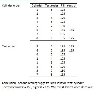

This mornings fun was 'compression check' - basically following some long and VERY useful conversations over 'what else to do while engine is out for rear seal' (you know who you are; thankyou ! ) it was suggested a compression check would be a good place to start.
After all, engine has had 'a life' and had a lot of 'sniff' so a compression check would give me an idea if rings were hanging in there...
Interesting results actually - learned quite a lot this morning.
1) Learned that there are loads of variables for converting compression ration to PSI readings - so really its a 'ballpark thing'. Obvs the higher the compression ratio the higher the PSI. Its more about an even spread.
2) My observations suggest that as I worked through my readings fell by about 20psi - I have concluded that as the smell of fuel increased (and the rings got wet) the pressure dropped slightly. In fact I retested the first one at the end and the drop was just that - 20psi between reading #1 and #2.
I remember from my rotary days, once you flood a rotary engine you just cant get it to start - they have no compression if 'wet'. Assume this is the same phenomenon.
So - results dont look too bad. Its all squashing. :) (Although not 'within 10%' - but there is fudge-factor ambiguity here. Will run control tomorrow.)
Conclusions -
- All cylinders hold pressure.
- Highest was 175psi (195 dry)
- Lowest was 155psi
Compression ratio ~10.5ish:1

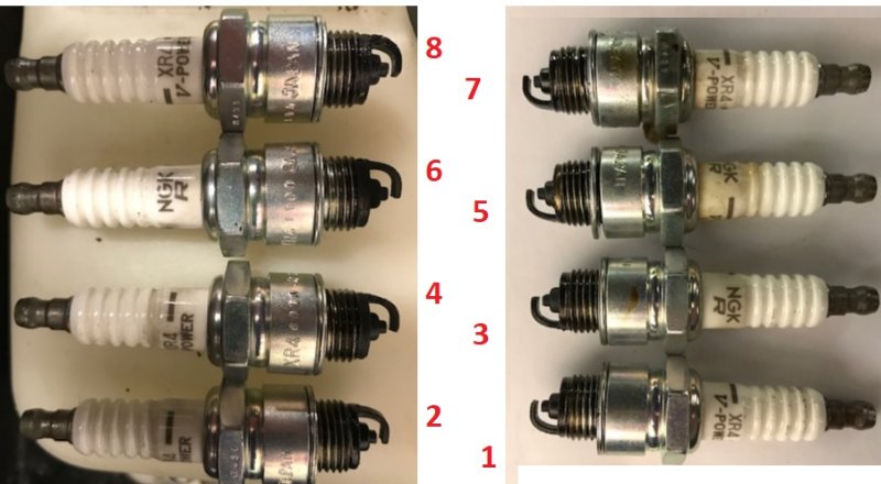

Oh, and one for you plug doctors.
500miles ish. 350 motorway, 100 tooling about, 50 being nailed :)
Look a little dark to me; rich. #8 and #6 a little cruddy.

EDIT - Well tested #7 and 5 again after 8hrs rest. (dryish). 185 and 175 respectively. (up 30/15psi respectively). I think the conclusion is that first tested gets the best reading. The lowest last time matched the highest this time. So it seems that 'dry' they will all do 175/185. I am happy.
