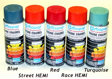

I think you will be disappointed with the one on the left, it's the same as the one I had and it was nothing like the lid on the can, it's a lot duller, test it on something first, It might be the 2 cans I had where duff. :cry: let me know, then I might order some from USAutomotive.
Posts: 14007
Thanks Del. We will test it but I reckon we'll need to get something that actually says 'Street Hemi' on it, and preferrably with an official Mopar logo on too!
Got this pic off the mancini site - presume this is what Geof Hauser would supply? I'll let you know what we end up with...

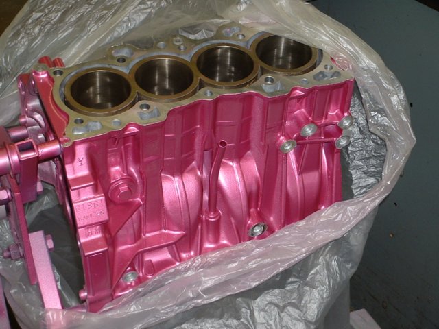

Pink Honda? Say no more :roll: :lol:

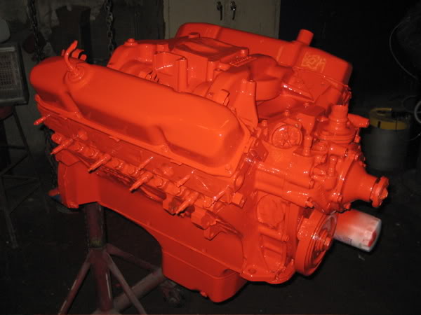

That 440 looks the dogs Andy, wish ours had that much paint on it.
Hauser's, BTW use GM orange :P
Wonder if JC could supply us with some Street Hemi orange? :-k

Back on the paint briefly...
Itook these mainly for Derek to see, but thought I'd post them here in case anyone else is interested.... :sleepy2:
The throttle bracket was painted with the remains of the pukka Chrysler street hemi orange aerosol (the one on the right at the top of this page), and a scrap bit of metal was sprayed with the VHT 'Chrysler hemi orange'.
I took a pic outdoor in the daylight thinking it would illustrate the difference clearer, but the indoor pic with the flash may be better for that:
(i wasnt awake enough to think of arranging the brackets in the same 'on the left' or 'on the right' position as the aerosols, but hopefully ypu recognise a throttle bracket from a scrap bit of metal :? )
outdoors - VHT on the left, Mopar paint on the right
indoors - Mopar paint on the left, VHT on the right
Hopefully you can see how much more dull the VHT is. If I could open the hood on the Polara I'd compare it with the earlier race hemi orange, but from memory, this VHT looks similar to that.
Surprising how different it is from the later street hemi... :roll:
Posts: 7545
Just as I thought, cheers Rob.
