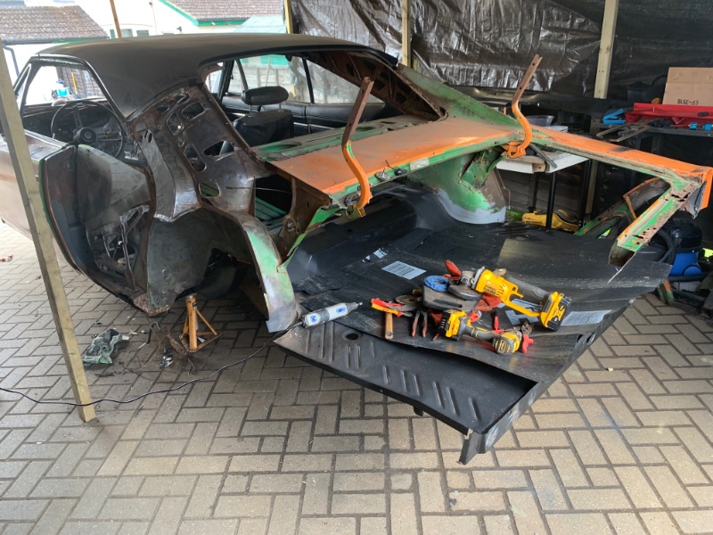

So while all this has been going on in the back round I have been dealing with some bodywork issues, rectifying imperfect AMD panel stamps, stripping and refinishing the engine bay, restoring parts that will be re used amongst other jobs. Honestly it feels like it never ends but looking back over pictures surely helps to appreciate how far it’s come…..

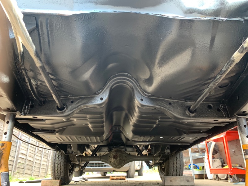

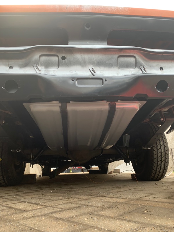

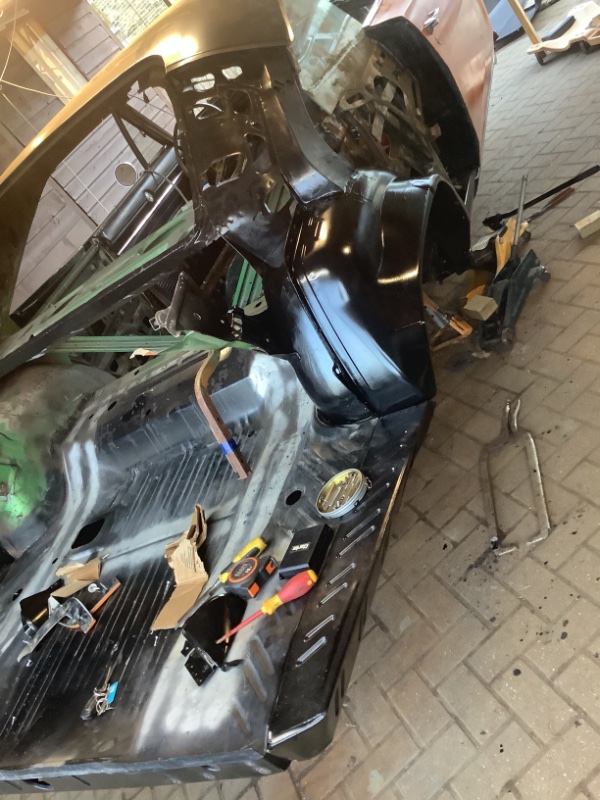

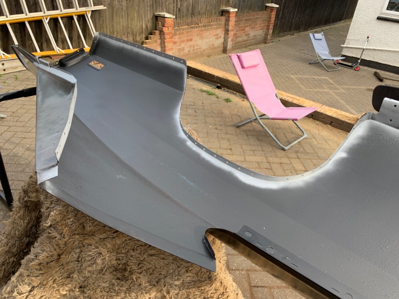

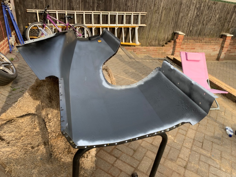

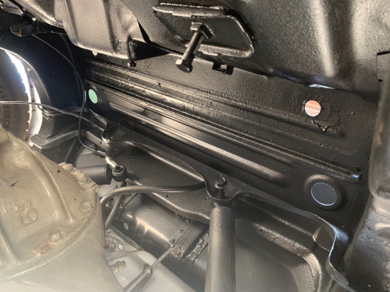

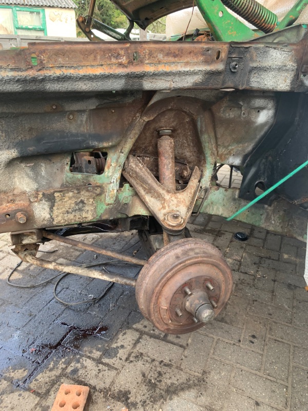

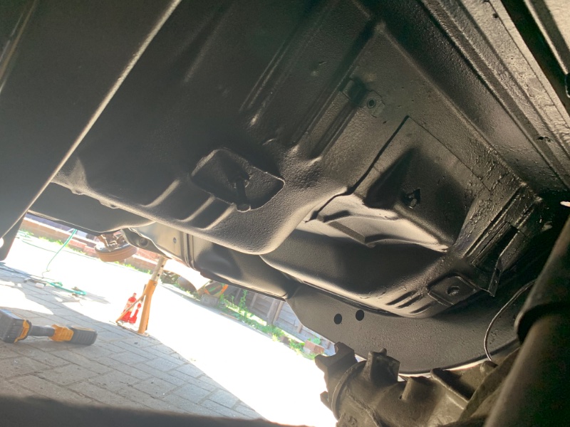

I have sealed and finalised the underneath. It was important to be that underneath was well protected and looked good. I looked at a lot of underbody protection positions and I didn’t want anything that stayed ‘soft’. I also didn’t want anything too clumpy and thick. So in the end, although worked out a bit pricier that it needed too, I went with Upol 2k raptor. I also used this on the inside of my rear quarters and other chassis areas. This stuff is awesome and also looks nice when it’s cured. It is very durable and I am happy with my decision here. I absolutely love how the underneath of the car has come out.

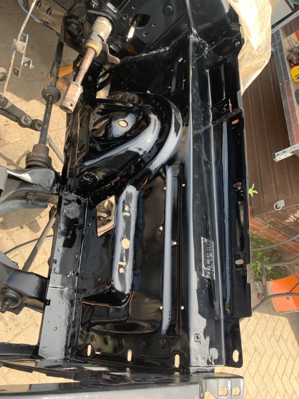

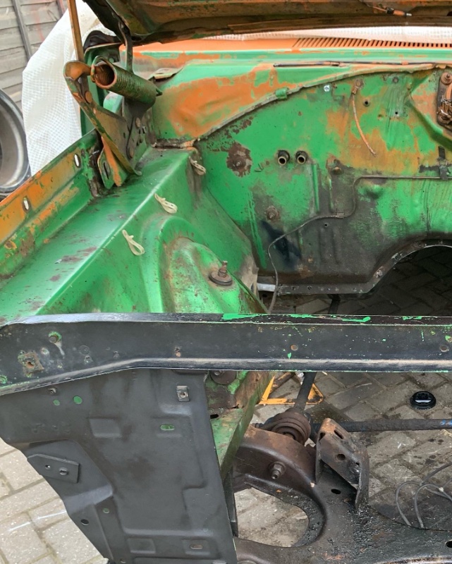

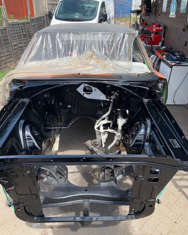

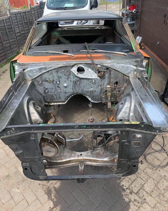

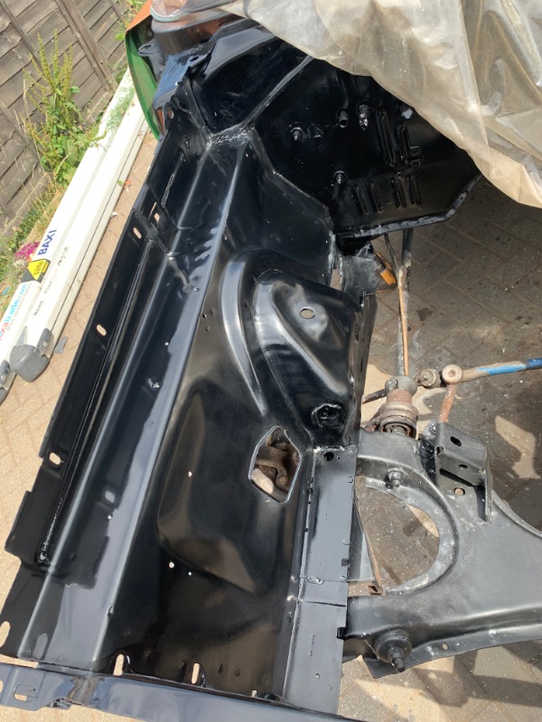

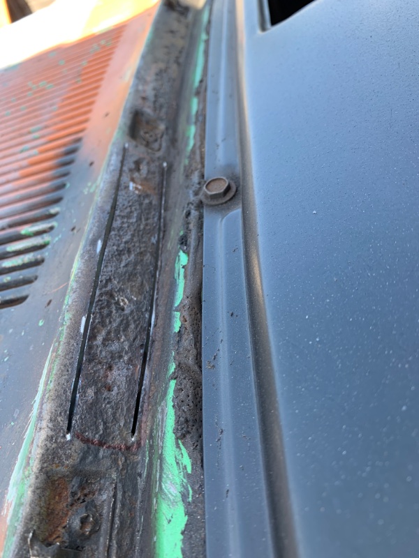

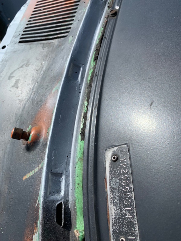

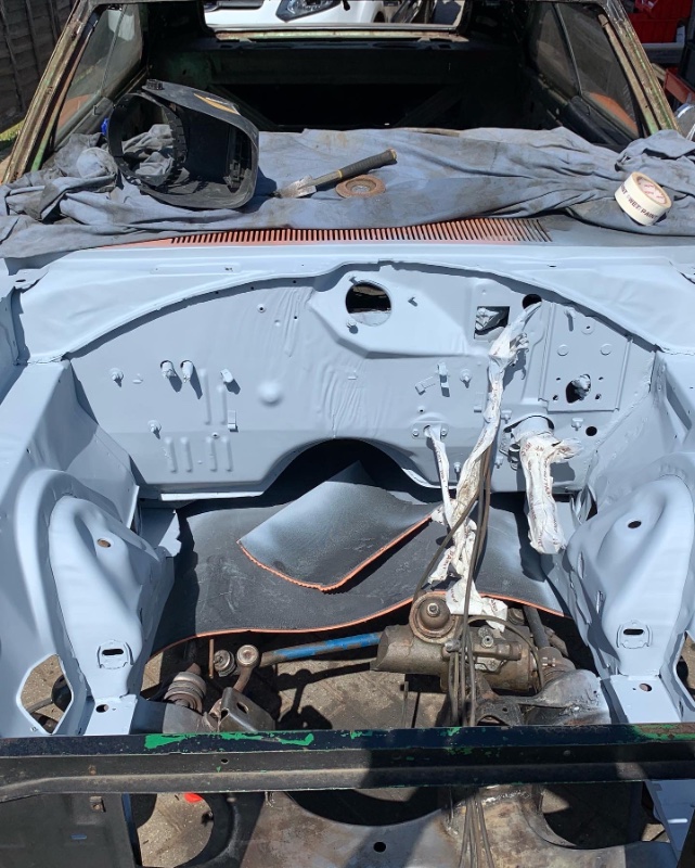

I spent a week on stripping and priming the engine bay. The monotonous and ball breaking work here was not fun. I needed to remove all of the old paint and primer. I went through orange, green black and primer. This car has been many colours in its life, and even at this point we don’t know what her colour will be (I can’t seem to finalise a decision here, it’s like chasing a mice in my brain) and as I need to move on I have painted the engine bay black. I used black base coat and 2k lacquer. This is how I painted most things in the past and have never had a problem. Leaves me with a good durable finish. Wet and dry 1000, 1500, 2000. Flatten, Polish, wax paint done. It came up great. I didn’t filler over the stamping ripples from factory, they are original and do not bother me. If I go with the original F6 green, the engine bay will stay black. That’s just something il have to live with. Sorry about the order and rotation of pics, Iv done my best to give some idea of the work involved/before and after…

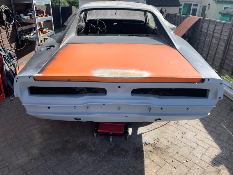

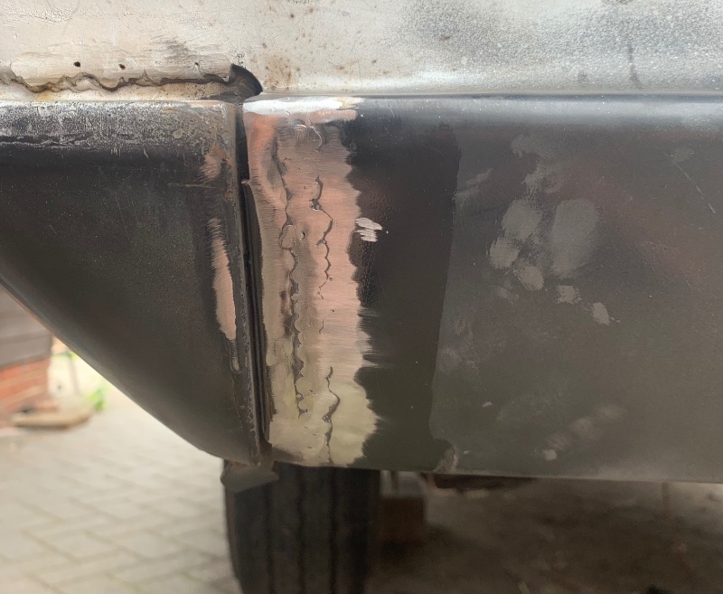

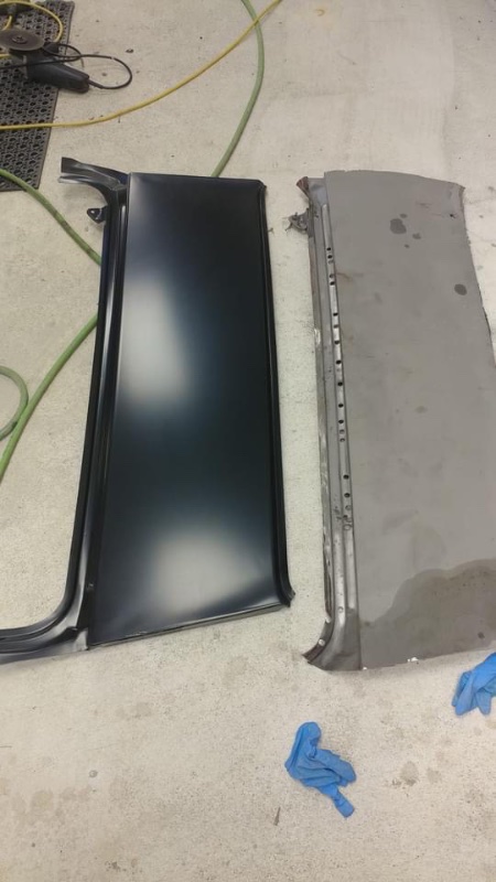

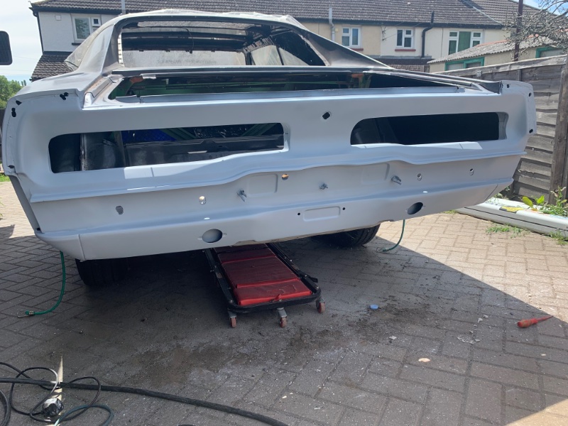

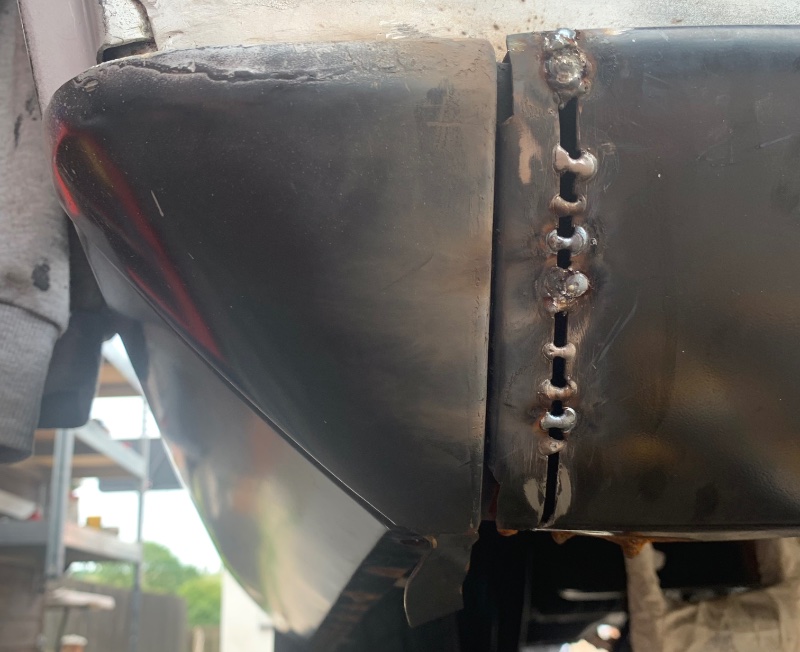

So on an factory “original” charger, the valance corners are (mostly) ice and tight to the rear valance, however I often see on cars that have had panels replaced, this gap seems to be bigger. I wanted to get these valances as tight as originals so a little cutting and welding was required… sorry about the crappy pictures here I didn’t think to take a before pic agh!
However the coroners now sit nice and tight amd I am very happy with them!

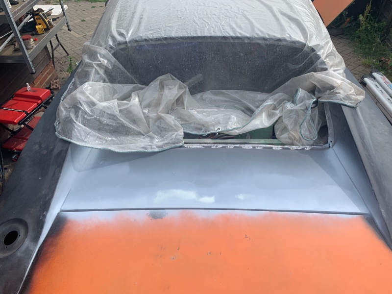

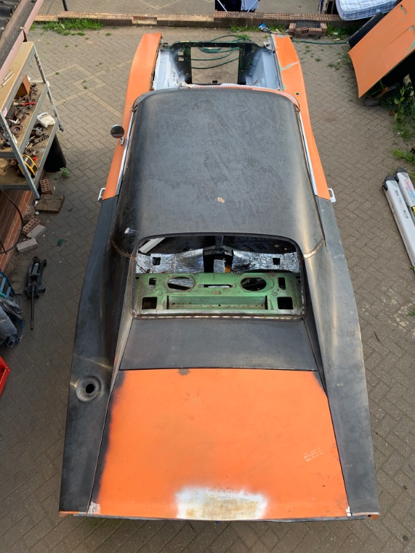

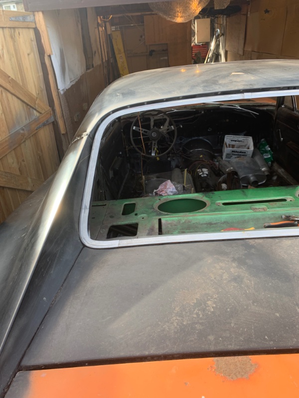

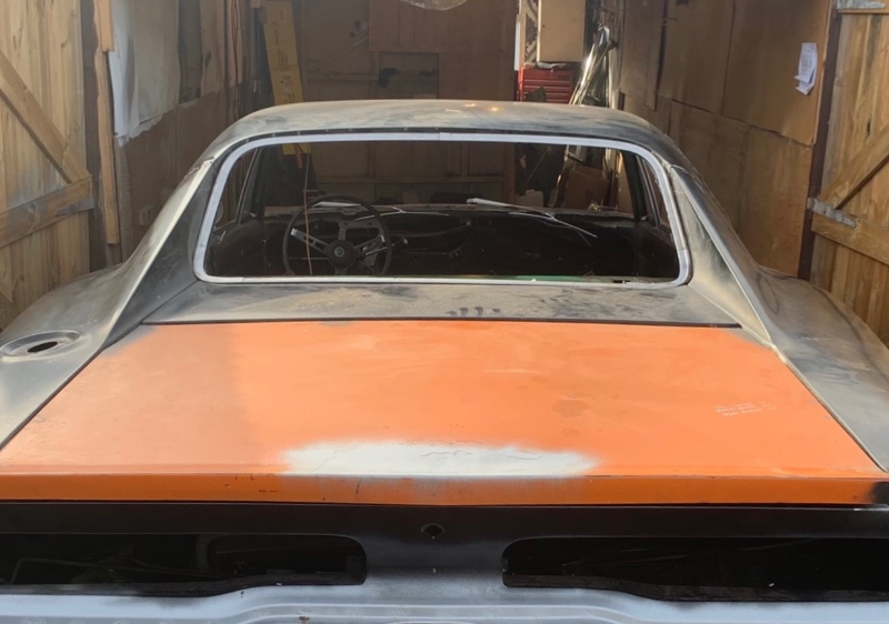

Next up, I felt the need to do some upgrading on the deck filler panel. The AMD version seems to be more “rounded” along the edge when compared to the original. This always bugged me. When many of you guys see me at car shows staring for hours at your cars and wondering what the crazy lunatic has been staring at for 20 mins, these are the kind of things I’m looking at!
I addressed this by painstakingly adding weld to the edge, weld a pellet, blow gun to cool, and repeating the process over and over until I completed and then bring back to replicate the original. At this point I can hear your thoughts and I know you think I am crazy, but now that I have brought it to your attention you’ll understand what I mean. Little things like this bother be much more than the fact the underneath is not painted body colour. I really don’t know why but I think it’s because paint can always be re addressed but panels need are there to stay.
Pic below is not mine and not the best for comparison, but I hope you can see the AMD deck filler is a Lot more “rounded” at the edges, where as the original is a much sharper stamp.

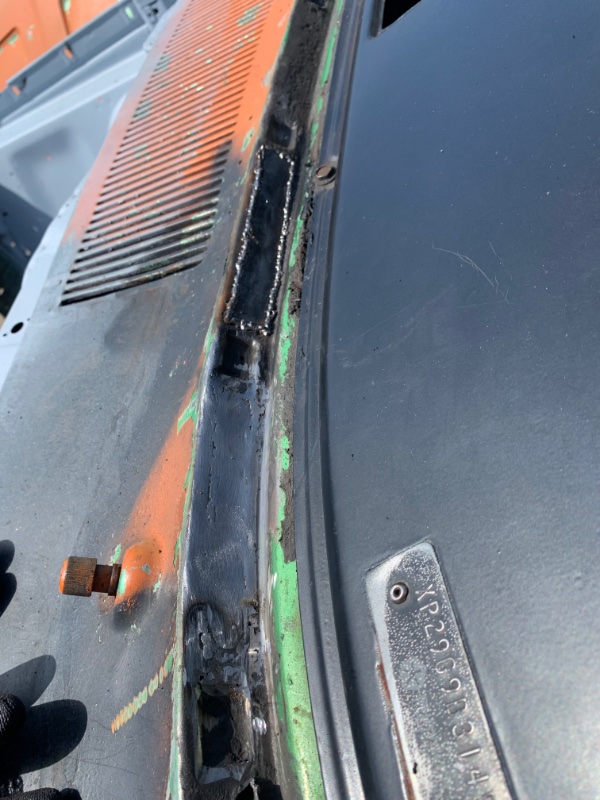

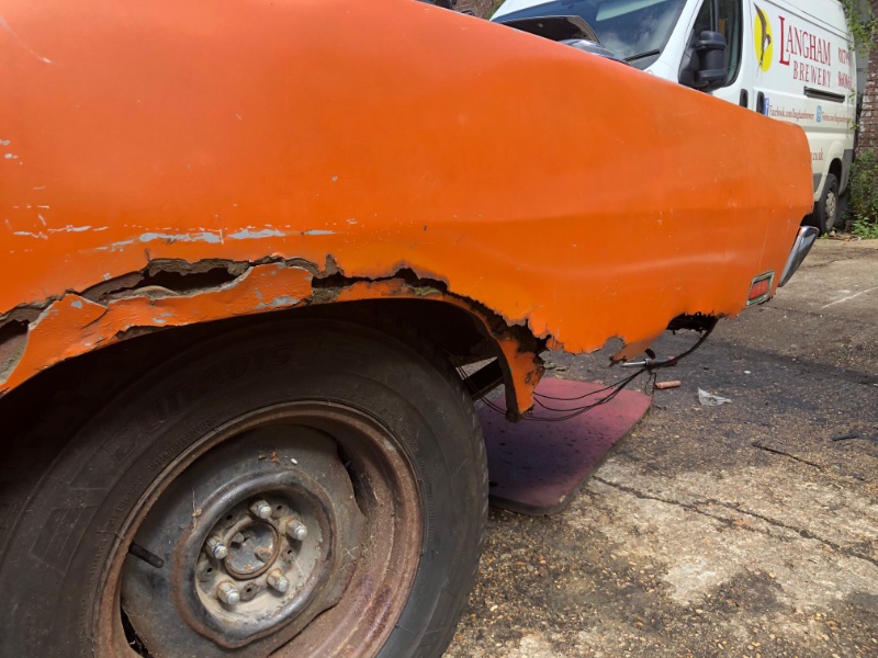

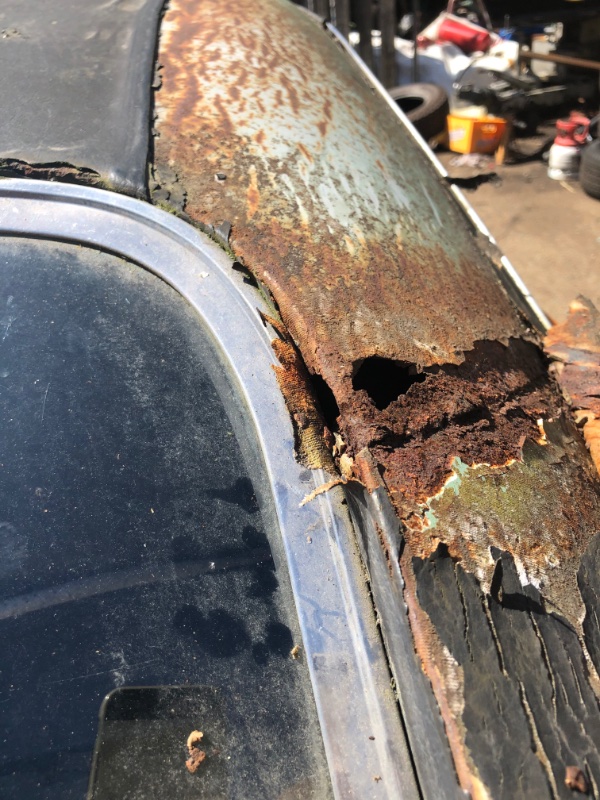

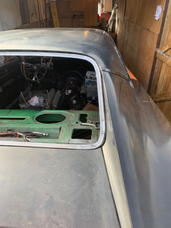

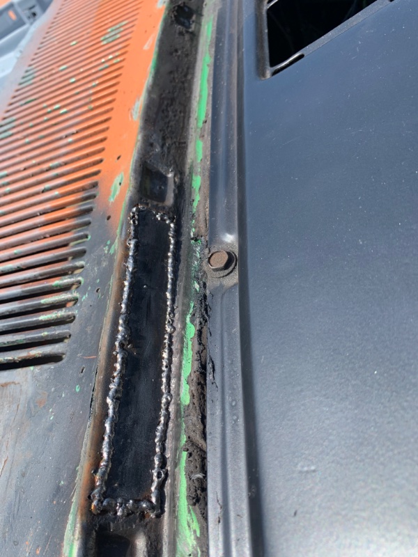

Also addressed some window channel rust issues:
