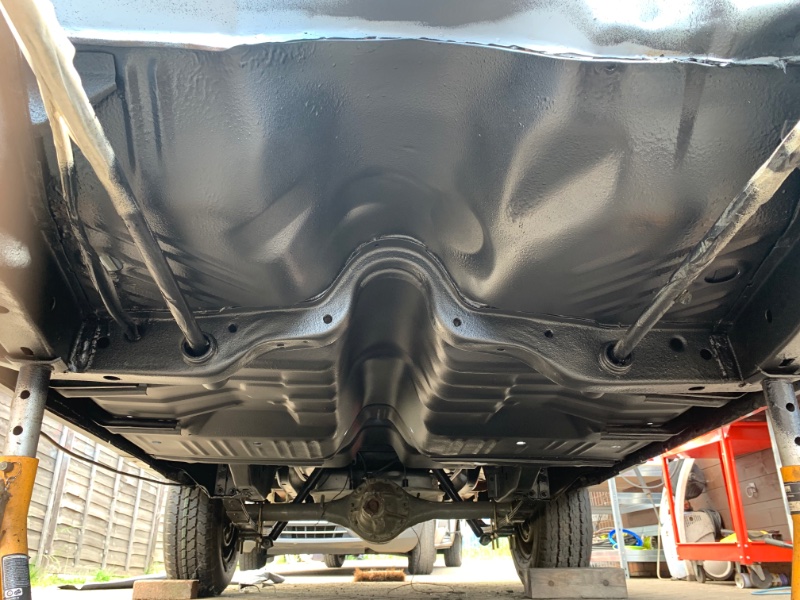

I have sealed and finalised the underneath. It was important to be that underneath was well protected and looked good. I looked at a lot of underbody protection positions and I didn’t want anything that stayed ‘soft’. I also didn’t want anything too clumpy and thick. So in the end, although worked out a bit pricier that it needed too, I went with Upol 2k raptor. I also used this on the inside of my rear quarters and other chassis areas. This stuff is awesome and also looks nice when it’s cured. It is very durable and I am happy with my decision here. I absolutely love how the underneath of the car has come out.
