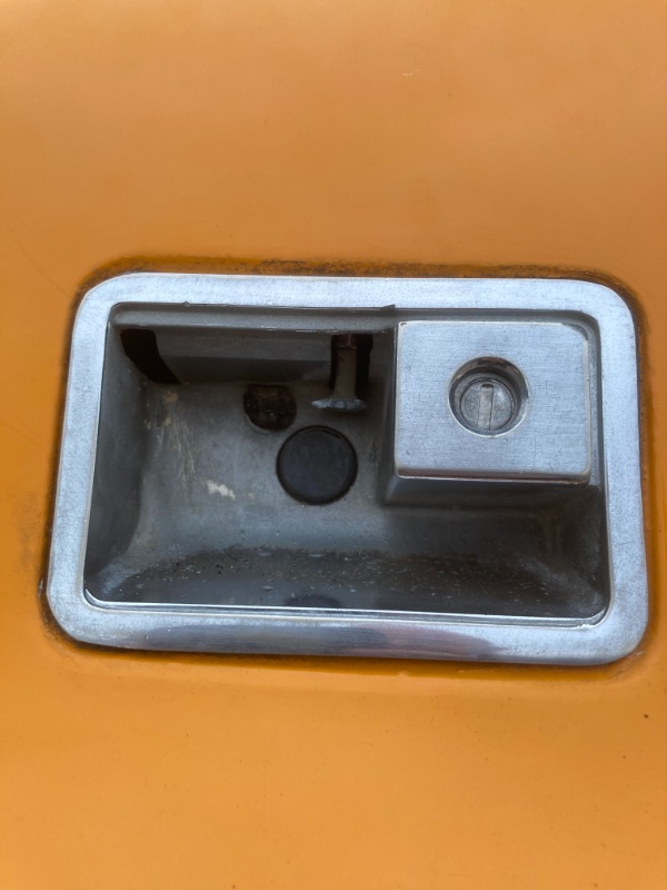

Had a truly awful weekend and today was going from bad to worse, so decided to park project ashtray and escape it all by going for a drive. Took the Challenger out of the lock up, left it running for a minute while I chucked my car in its place and locked it in the unit. Went to get back in the car and the door handle literally came off in my hand. You couldn’t make it up. A lock up full of tools and couldn’t get in to get them because the key to the lock was on the car keys, sitting in the ignition of the Challenger whilst it idled away, blocking up the entrance road… FFS… :banghead: :angryfire: :roll:

Yes, called out the cavalry who arrived with long nose pliers and managed to get hold of just enough metal to be able to trigger the latch. Went for a cruise anyway after that to blow out the cobwebs and frustration. Just had to remember to unlock the passenger side and put the window down before I got out to unlock the lock up again. :roll: :thumbright:
