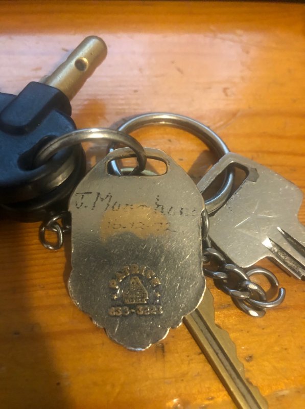

Did a bit of facebook detective work and tracked down some of the history of my car, potential history....
posted up my keys/ keyfob on facebook with a rerquest for info
it has J moorehouse engraved in the back with a date
needless to say found a guy with an article about my car and another who said he knows of a moorhouse familiy resdient in Parkes NSW for many years.

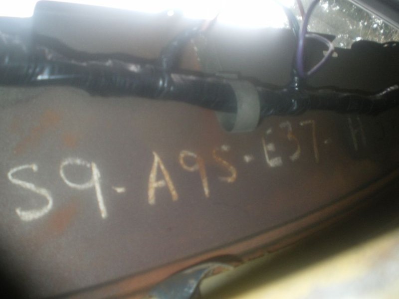

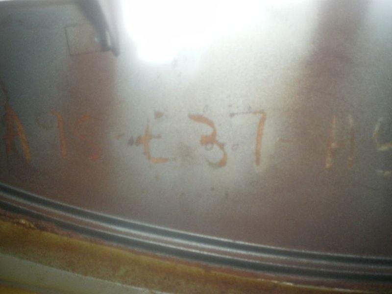

- Build sheet Options chalked under dash E37 is wrong car never had the Race motor

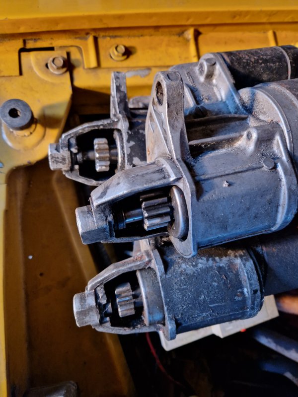

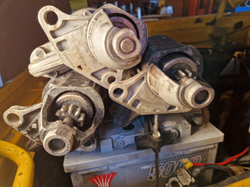

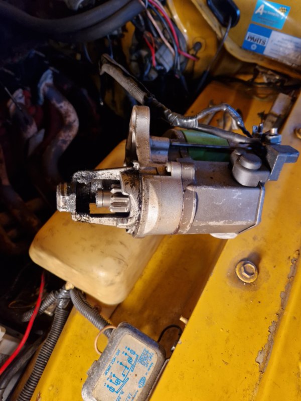

stripped it to take it out...
but then felt that lunch was a better option and failed to continue with the work
But did take some photos to illustrate the differences in Australian starters for Matt, after pulling my mini starter i was taken with how mini it was in comparison with the orginal..
its covered in oil due to rear main seal problem... which is to be fixed when i take out the motor
starters shown
35mm pinion for 727/smallblock combo works in US car as well. big pinion gear has a lead section under the gear (Right) its further away so it looks small....
27 MM pinion 10 tooth wide pinion gear front to back. works on hemi 6 3 speed hemi 6 4 speed 318 4 speed 318 on 904 318 on BW35 1971--> (middle)
25 mm pinion 9 tooth. bit broken. easy fixed, the pinion should not be that far forward, when at rest. narrow pinion gear works on the same as the 27 MM pinion (Left)
the 27 mm pinion is offset OUT from the centre line of the crank to allow the bigger gear to work in the same place as the 25mm one
my mini starter had a 35 mm pinion for a magnum 318 in a dodge truck US. and i swapped it for a 25 mm pinion 9 tooth so it worked on my car.
this would also work on a US street hemi Gen11 on an 833 the ones that had the unique direct drive starter.
when looking at the ends of the starters
Right is the 35mm US style pinion
middle top is the 27MM aussie note how thick the flat side of the D end is on this one
left is the 25 mm aussie
starters shown

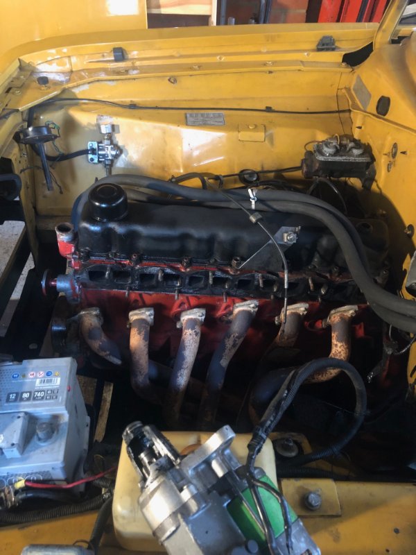

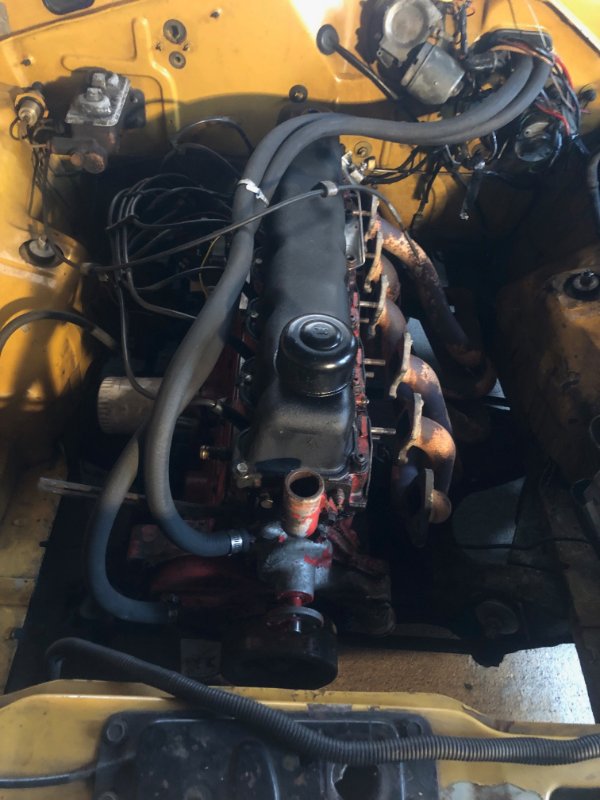

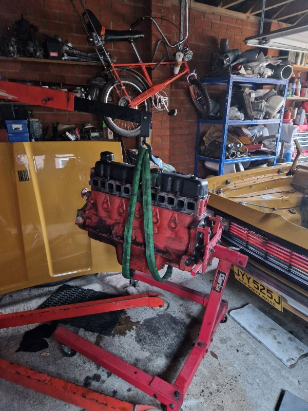

i'm feeling slightly battered. must be 8 years since i last rolled around on cold concrete
Rear main seal
lets see if i can get the crank out without taking off the head.
and whaddya know..... applying stand to engine when on crane rather than trying to crane the engine over to stationary stand is much easier
dave
Rear main seal
dave

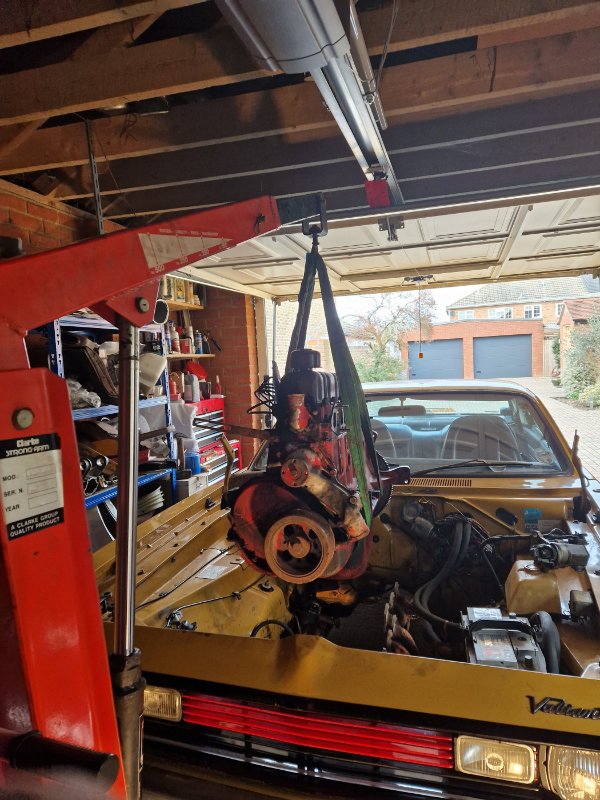

Took bloody ages to transfer my lump to the stand off the crane this time. Had to Jack the crane up to get the stand in close enough.
2001 Dodge Ram Van
2001 Dodge Ram Van
Re: Dave999's Aussie Charger
well this is what i have always done. messed about trying to line stuff up....
so this time i just jacked the crane up high. (I have the headroom in this garage. previoulsy i was making grooves in the ceiling)
bolted the stand fixture to the engine
then hung the rest of the stand on it and swung the lot round, gently as i lowered it so the stand didn't sit on the crane legs
why oh why haven't i done this before..... ????!
dave
dave
- ScottyDave
- Posts: 1681
Because we can't see the simplest things once we've over complicated it in our heads.
dave? over complicate things? never!ScottyDave wrote: Mon Mar 13, 23 10:51 am Because we can't see the simplest things once we've over complicated it in our heads.![]()
the messing about was reduced 100 fold no rolling the car back further and having to shove it back up the slight hill, minimal pushing of a great big pendulum around on clarkes, plastic "stone magnet" castors it was just toooo easy...
just goes to proove cold, knackerd, beard scratching in the garage for long enough, and eventually i get with the program
some of you do this multiple times a year i aim for once a decade
its a light ish engine and my crane although ancient and knackered is rated high enough at that mid extention point....longer car and bigger (all cast iron engine might be a risk.
i don't want to gloat but i've been putting my stand on engines for years mate. i think where you're the king of research i may be king of finding the easy way to do things, if sometimes a little unconventional. i worked for my dad running his haulage company workshop for many years and always looked for the easiest way to achieve the same result. dad said i should've been one of those time and motion study blokes.
