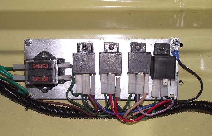

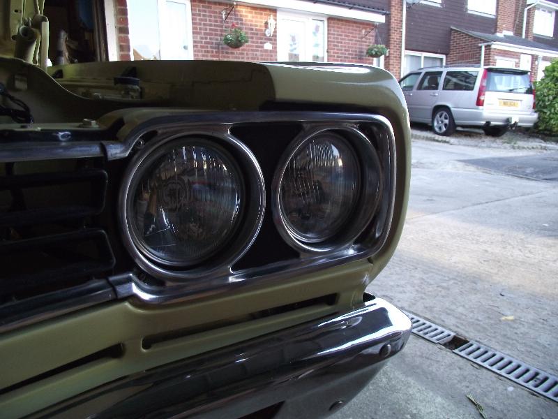

new headlights, not sure if i need to use a relay i have wired through the standard switch.

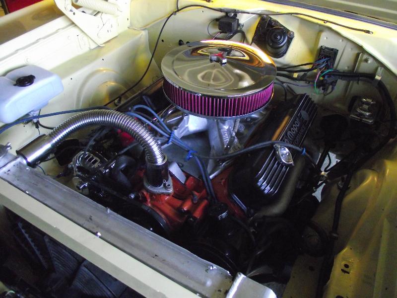

new air cleaner i have resprayed the valve covers black didn't like them orange

Post by Matt74 »
Hi Nick, your car is looking good.
I used a relay on my old charger as the switch was getting very hot. I had no problems after it was fitted. I think most people would recommend that you fit one.

Mopar Matt wrote:Hi Nick, your car is looking good.
yeah need to run separate relays , to take the amp draw off the head light switch , best way is have one relay for headlights & one for main beam

relays, relays relays, dip and main for the headlamps .electric fan and one for the dixie air horns. ran them through some fuses for safety.

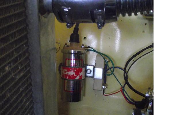

i moved the coil and ballast resistor to the inner wing. made it easier to wire the electronic ignition pickup in the dizzy,

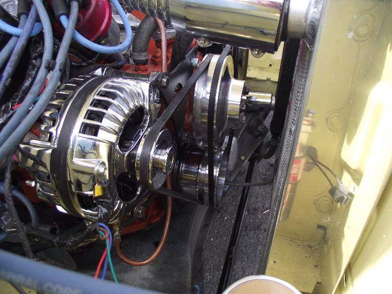

super shinny billett pulleys. i have power steering. anti roll bar was fitted . the boot was cleaned out and sprayed with stoneguard.(will spray same as car when i get some paint mixed.

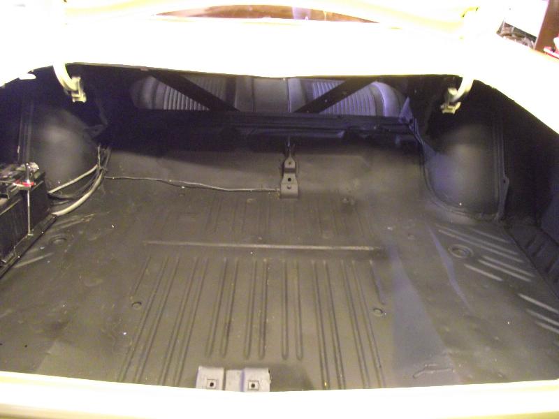

Post by Anonymous »
battery fitted in the boot and the boot was cleaned up and sprayed.
