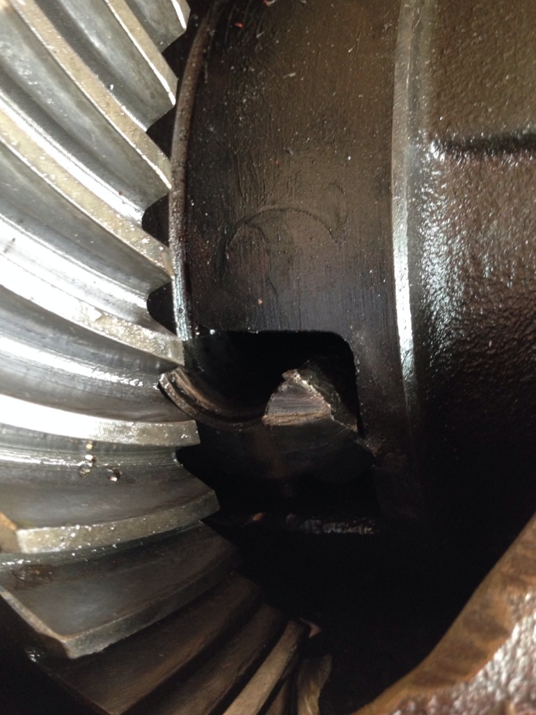

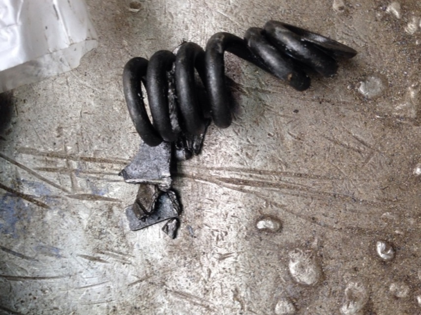

Tried making a start on the car this weekend but didn't get very far, started assembling the rear disc set up, went to install the shafts, spun a shaft and the diff locked up, pulled it in bits again to see lumps of metal all in the bottom of the axle and a spring from the locker all bent out of shape, so dropped the diff off with George Chiles for him to strip and inspect, I had a spare complete axle with 3.91 gears and a locker so robbed the diff from that, to then find the shafts are too long for the casing! (Install one shaft push the other in it pushs the other shaft out, pulled the shafts incase they were in the wrong side both exactly the same length, but tried in the other side, still the same, :? They're about 1/4 inch a side too long, so think I'll get them machined down as there is 3in of spline, a bit annoying but hopefully will get it sorted this week and get the car roling again

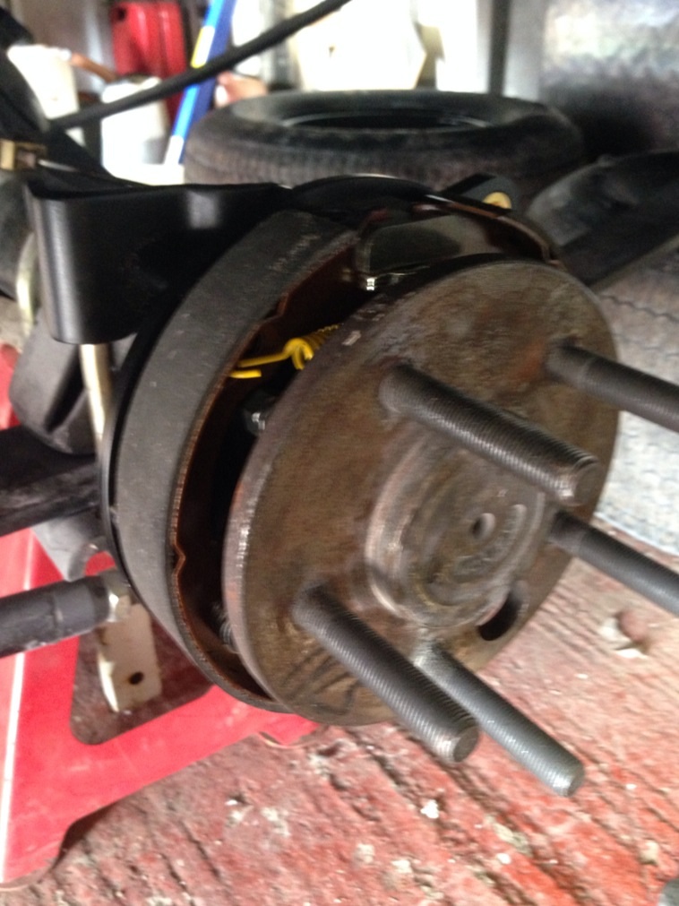

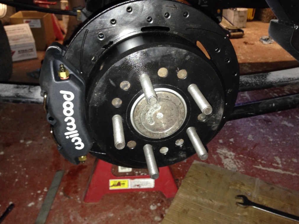

Got the diff all sorted now, shafts in and brakes all fitted, what a diddly job that was, hope I never have to pull the shafts again
Park brake assembly
Park brake assembly

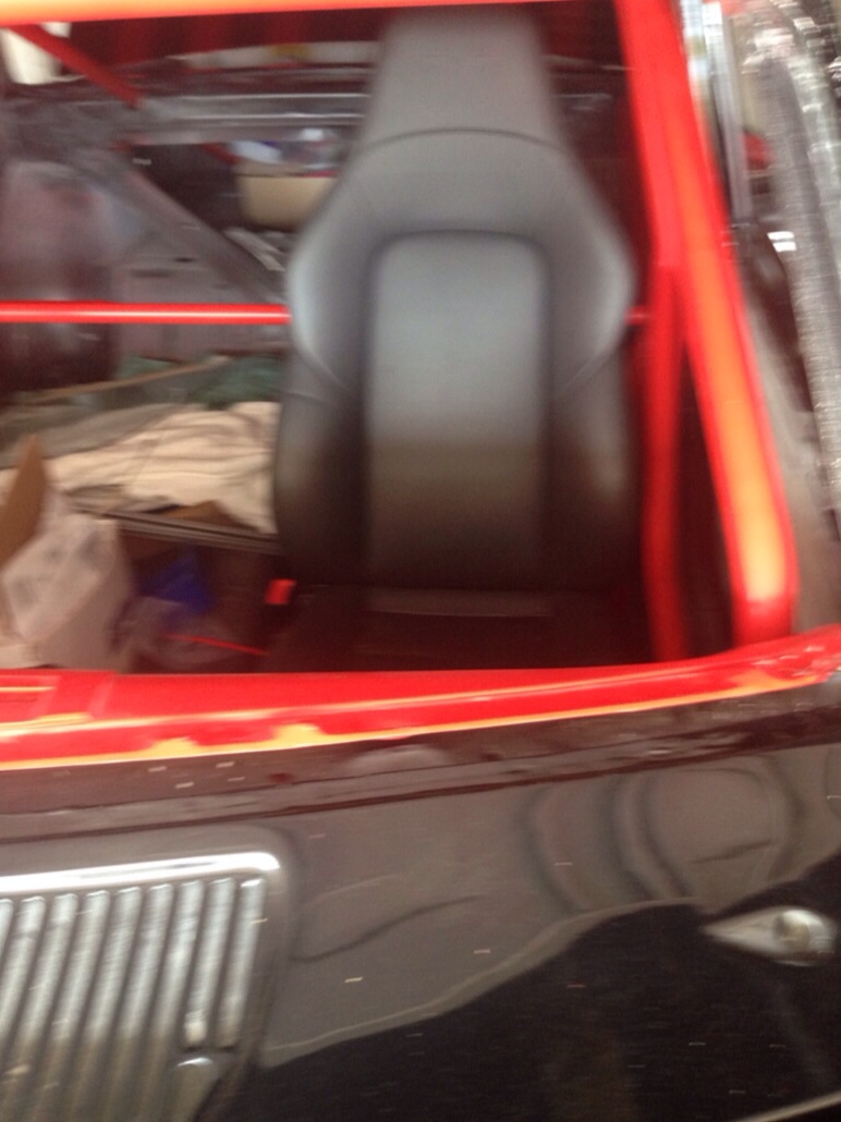

Still moving on steadily with the car, had the headliner fitted yesterday, and got the new seats all mounted up, decided to use a pair of seat from a crossfire as much more comfortable than the a100 seats, got them temporarily wired up and got all the adjustment working, just need to drop them off for re-trimming
Seat rested in
Seat rested in

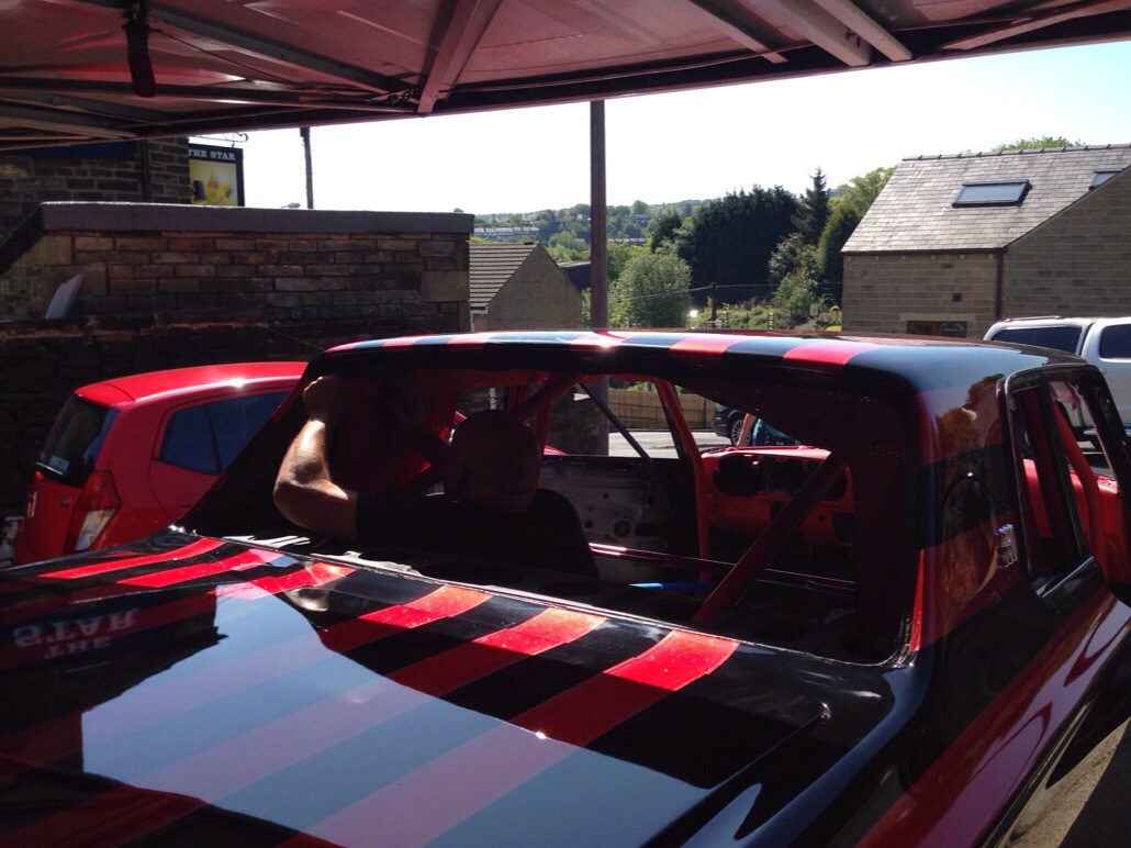

Bob fitting the headliner

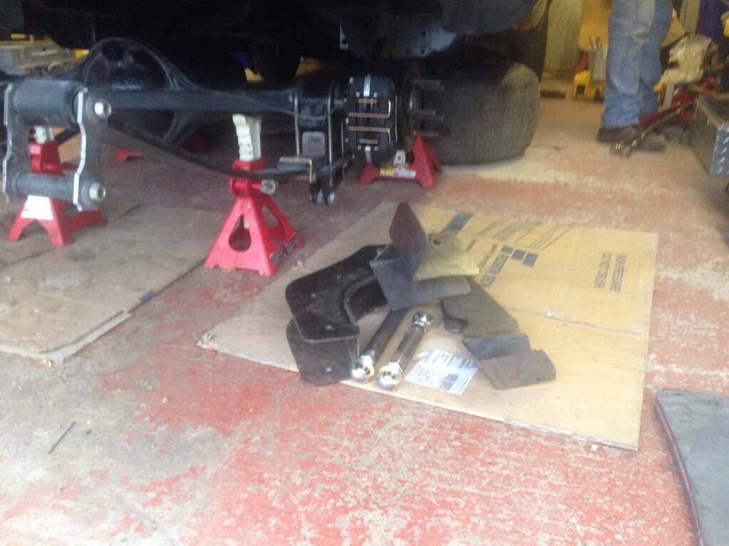

Well that's been a bit longer than I thought, finally getting back on with the car after doing bits on the house and a wedding in Cuba, after much thought I decided to go to a 4 link rear so I could get the car nice and low but without using lowering blocks, so after much research I went with the Magnumforce bolt in kit as I wanted to keep the floorpan and chassis rails intact, today I've removed the axle and caltracs and over the next couple of weeks I'll be installing the new 4 link kit
