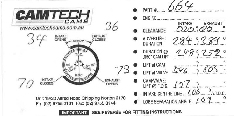

well i run this in my hemi 6
3.45:1 rear end
1st 2.46:1
2nd 1.78:1
3rd 1.27:1
4th 1:1
a similar cam from the same manufacturer for 318 exists but is 2 further up the list of mild- wild when applied to a 318 v8 with a plenum based inlet
company has just shut down so i can't find the specs.
i while back i posted up some stuff on dynamic compression ratio and a link to some software... really handy
if you can't find it i'll dig it out again
cam card.jpg (65.89 KiB) Viewed 3686 times
