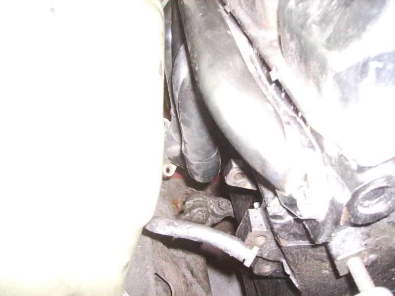

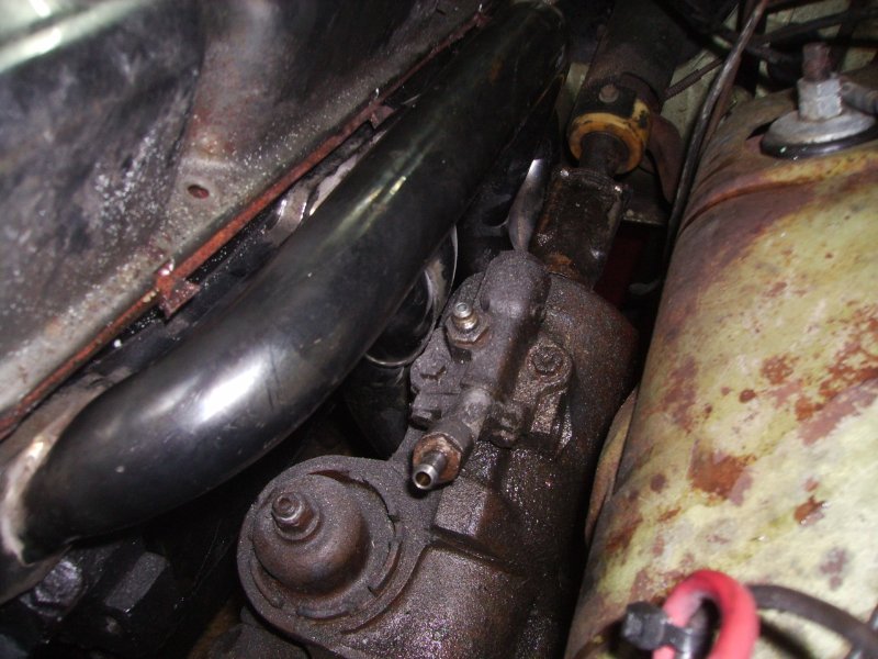

been out to the garage this evening, first chance all weekend but hey ho. tonight's job was to get the headers in place to finalise the motor placement allowing me to make the new mounts. i dropped the passenger side in first and bolted it up. that was the first problem. round to the driver side and that one wasn't going in from above or below. ok, tip the motor over for clearance i thought. still not enough there's a pointy casting halfway along the block sticking out. so, out with the sawsall and that's gone then. sorted? er.... no. bugger the other header has to come back off so the motor can tip over further. finally with all that done and the steering on lock (thought i'd have to drop the centre link for a while) it went up from below :thumbright: . lastly i sat the motor back down and refitted the passenger header.
it's close to the steering box but i do have power steering so i kind of expected that. 1/4" is enough anyway as the motor will try to pull up that side under load so increasing the gap.

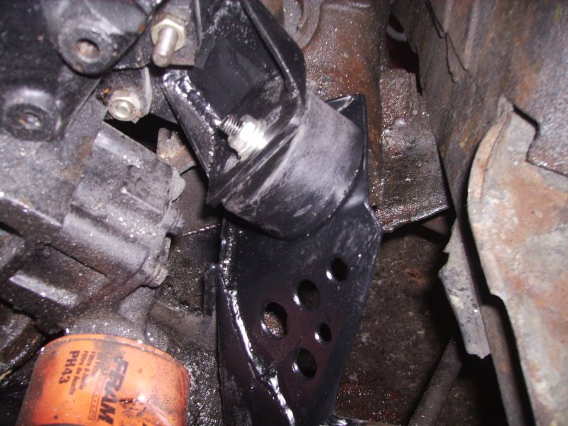

today i made/remade the motor mounts. i started on the driver side by cutting and re angling the old mount from the ford pilot. i added some bracing and then bolted the new h/d escort rs2000 mount to it. next cardboard templates transferred to some 1/8" plate were welded in place under the mount. a couple of bracing pieces and some black paint and that side was done. the passenger side was a bit easier as the pilot mount only needed a slot adding and a new slotted hole further forward on the k member and it was done too. i did raise the motor another 3/8" as the drivers side header didn't curl nicely round the steering box like it should. a bonus of this is the bottom of the sump is now about an inch higher than the bottom of the k member so i can deepen the sump (and pickup) for more oil capacity when it's off.

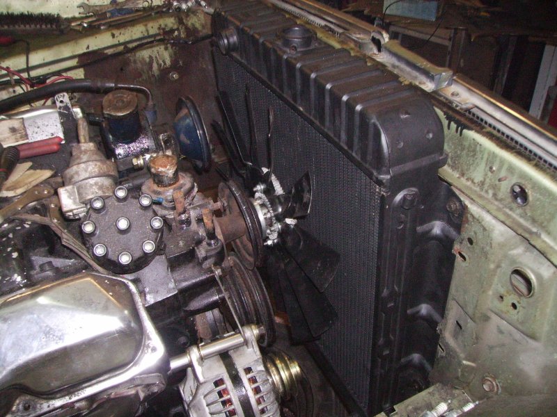

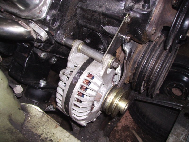

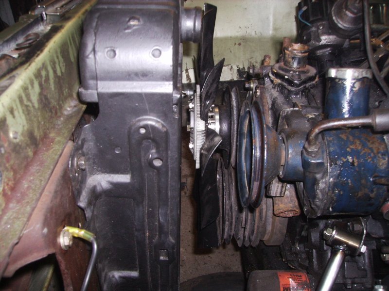

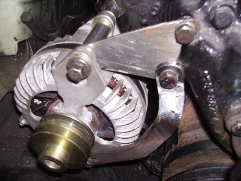

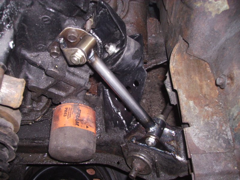

got some more done today. first i made the torque bar (like a torque strap but tube), then before i refitted the p/steering pump i trimmed the 2 bosses back 1/8" (3mm to you youngsters) where the pump bolts up to better align the pulleys. next i made the brackets for the alternator, as coincidence has it the 2v pulley lines up with a 2v part of the crank pulley too so i can use 2 alternator belts. that's good as i've had a rew where the belt has to be bow string tight to stop squealing. lastly today i fitted the mopar/jaguar xj6 hybrid fan and the radiator. i've got almost an inch from the fan hub nut to the rad' so that's better than i expected. i had to trim the bottom of the core support for rad' clearance so i'll add some steel rod to the cut edge for strength when it's blown apart.
all in all quite a productive day despite the cold.
