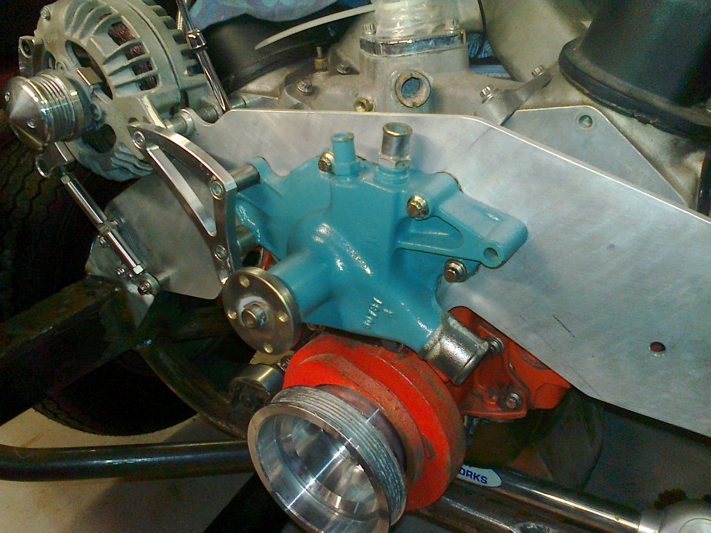

Baccccc- 1st pic is my existing pump, is the 2nd pic the one i need? The casting looks the same apart from the bottom hose exiting on the side i need, and a couple of extra bolt holes on the ends!
- http://www.summitracing.com/parts/AAZ-58-180/?rtype=10

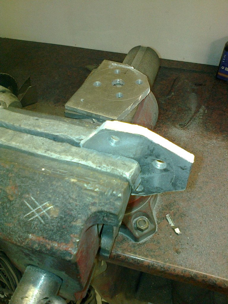

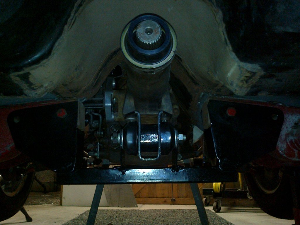

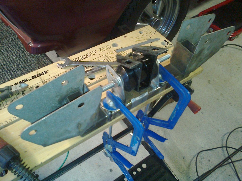

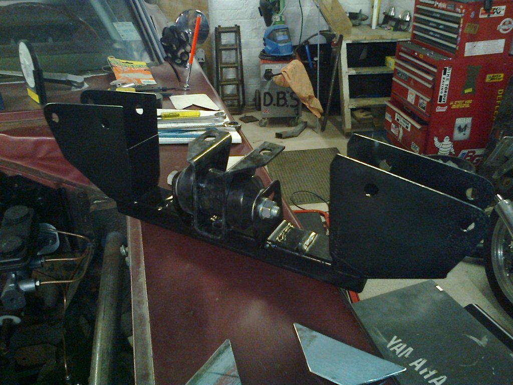

Trans poly bush assembled, plates made ( i found a handy plate with holes in the right place!) and welded to trans crossmember. Now derusting (1/2 at a time cos tank isn't big enough

- Trans mount ready to weld 01.jpg (157.62 KiB) Viewed 1128 times
- Trans mount, brackets drawn 01.jpg (168.34 KiB) Viewed 1128 times

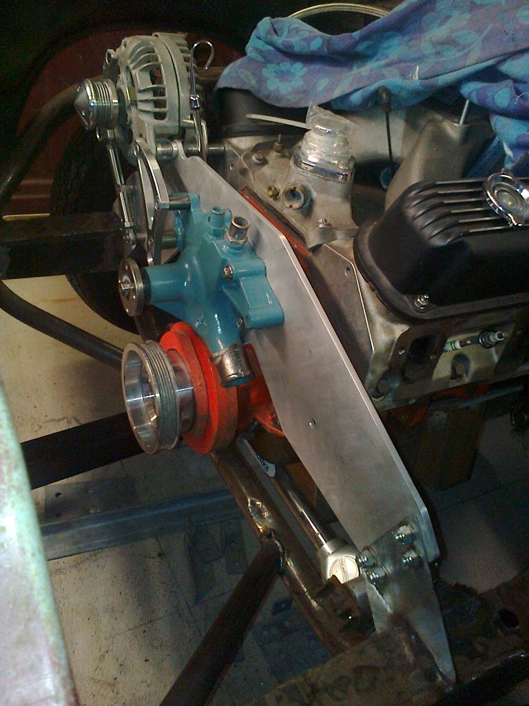

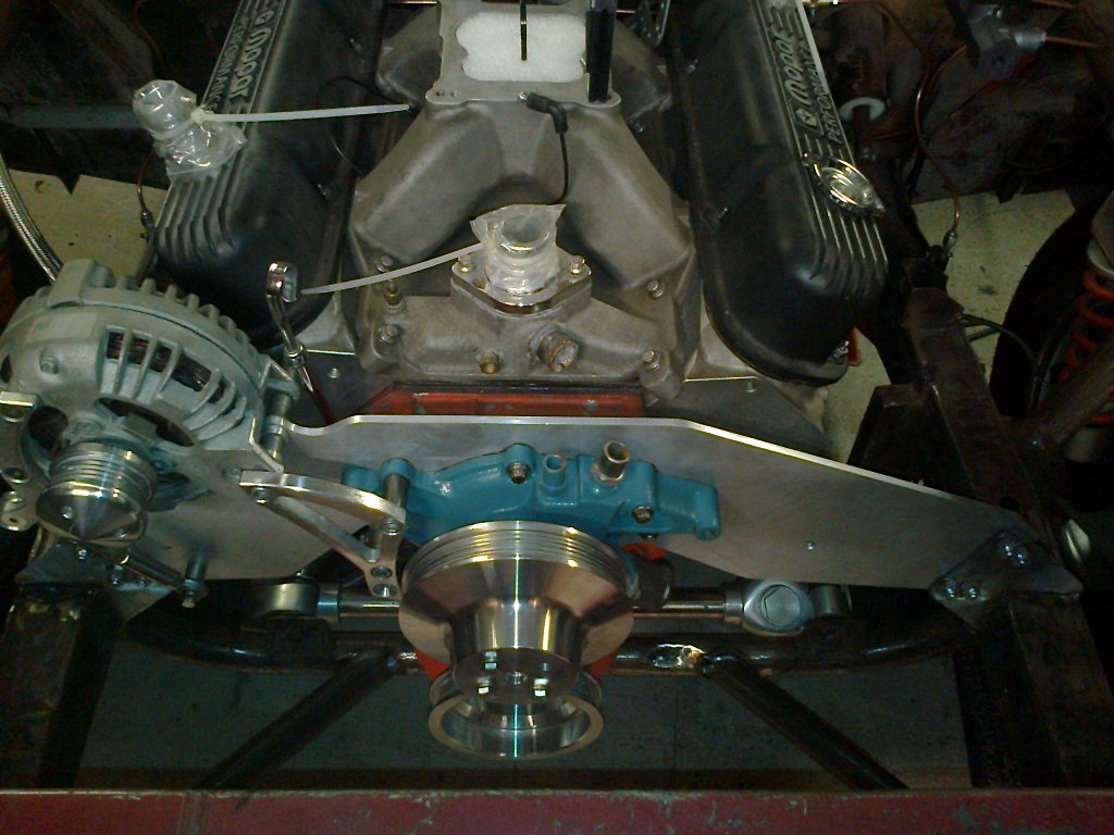

So, The ally rad i ordered about 4 years ago came out the box for a test fit and the bottom hose is on the wrong side
It turns out that the early pump is on the right side
I can buy a pump but it's another £60 out of a fast-shrinking budget
Amazingly Wolfman wanted to do a straight swap so 2 days later i had the right pump in my hand for the price of postage
So, I bolted it up... or tried to...
The iron casting is much thinner so now the pulleys no longer line up, if i move the alternator back in line it'll hit the rocker. The crank pulley spacer i spent a couple of hours making is redundant, the alternator spacers i spent ages on no longer fit, the rad pipe fouls the motorplate and the bolts are all different lengths
Well i've 'adjusted' the motor plate so that's now fine, found bolts that fit and worked out where the alternator will now sit. I just need to get a spacer made to stand the pump pulley 1/2" off the pump drive.

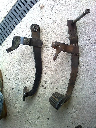

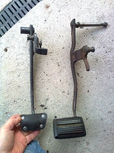

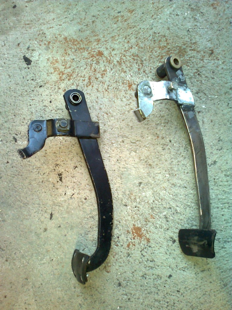

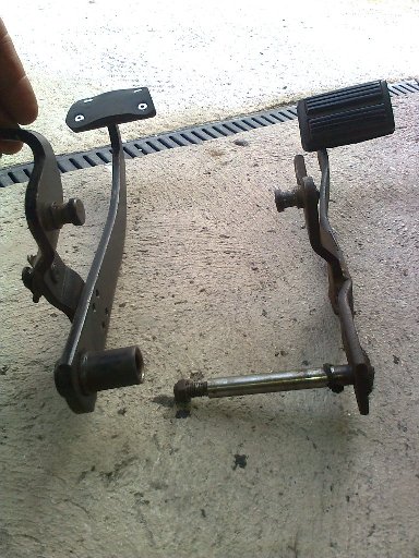

I've also been making my clutch pedal, thanks to Ade for donating an A-body one as a donor and thanks to Anton for the loan of a correct B-body one to copy.
You can see the differences in the pics.
I've flattened out the main lever, Made the rod pivot out of a cut-down bolt which i'll weld in along with the spring pivot which the old pedal donated.
The cross-piece was tricky cos of the thickness of the steel and all the bends but a blowtorch, lump hammer and vice got it sorted!

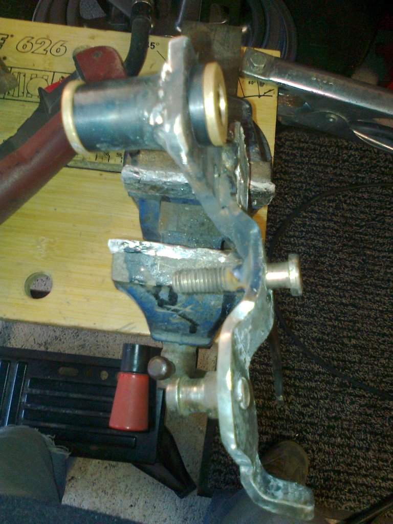

The pedal pivot i'm getting 'engineered'- Instead of roller bearings we're going for oilite bronze flanged bushes. He's turning a sleeve to suit and will then weld it into the pedal. It might be done today...

- Pedals 3.jpg (63.81 KiB) Viewed 1051 times
- Pedals 2.jpg (76.74 KiB) Viewed 1051 times
- Pedals 1.jpg (78.96 KiB) Viewed 1051 times

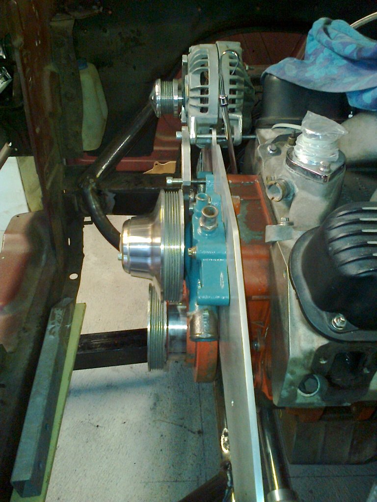

- New water pump pulley misalignment.jpg (148.09 KiB) Viewed 1051 times
I don't think so, it's just the angle of the picture; in fact you need to do the opposite and space the bottom pulley out to match the motor plate thickness.....ANTON wrote:Paul
Just put a ali spacer behind the water pump pulley to correct your belt issue and then you save all your alternator spacers and bottom pulley spacer.
No Anton's right Pete. I HAD spaced the crank pulley as you suggest and had all 3 pulleys nicely aligned. THEN i swapped pumps and it all went titsup
HOWEVER, after a big push today, THE MOTOR IS ACTUALLY HUNG ON THE MOTOR PLATE
I spaced the crank pulley out 1/2" (actually needs another 2mm but hey...) I was gonna see my pet engineer to get a spacer made, no-one's gonna see it so in the end i did it with my trusty grinder.
I've also fitted the timing plate from Bacceroo
and found enough bolts to fasten the whole lot down.
I'm very happy with how it's all turned out, at some point i'll make nicer alt. spacers & paint the pump orange.

Some precision engineering...
I didn't have any 12mm plate so i made 2x 6mm.
Once again the goddam bolt are now too short...

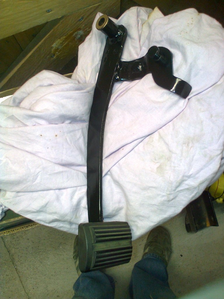

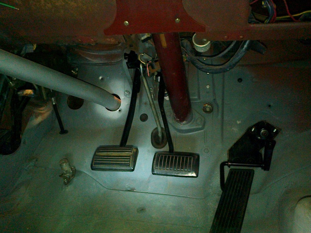

Another big push today, I now have a WORKING CLUTCH!!!
Terry, my engineer mate, made the pedal pivot last night.
He welded the tube into the pedal then pressed in the oilite bronze bushes.
I welded the rest of it together and gave it a blast of gloss black.
- Clutch pedal fitted.jpg (138.14 KiB) Viewed 959 times
- Clutch pedal finished.jpg (123.42 KiB) Viewed 959 times
- Clutch Pedal welded.jpg (196.29 KiB) Viewed 959 times
- Clutch pedal welding.jpg (158.67 KiB) Viewed 959 times

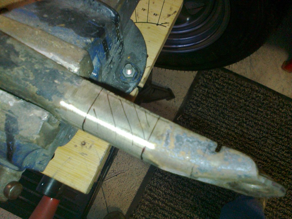

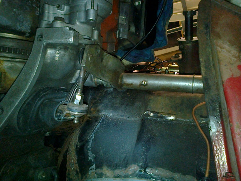

Next up was the Z-bar.
From my trusty Kellogs pattern i hacked up a bit of 2x2" box and with some serious heat bent it into shape. It needed bit of tweaking to get it snugly into place and level, then it was out with the welder again
It's not as close to the brake pipe as it loks, by the way

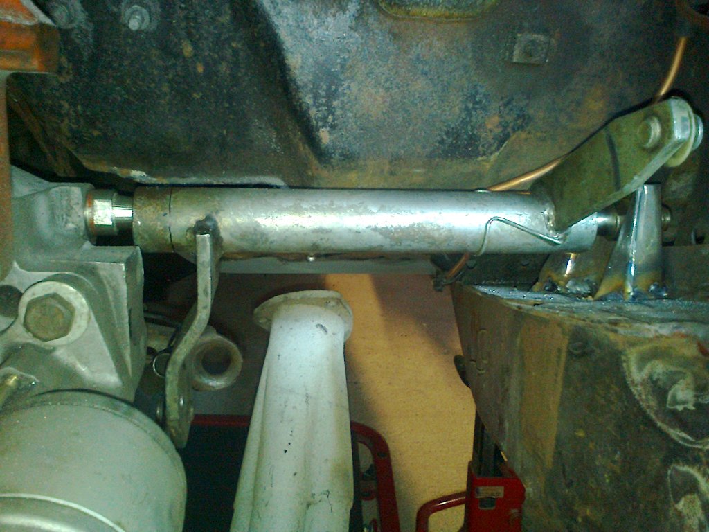

Once the Z-bar was in, i could measure the clutch fork properly. I needed to chop 1.5" out of it.
After welding the two halves back together I plated over the open side to beef it up a bit.
It sure was nice to finally assemble all the bits, press that pedal and feel the clutch operate for the first time
- Clutch fork, boot, rod and Z-bar fitted.jpg (152.96 KiB) Viewed 949 times
- Clutch fork welded and braced.jpg (129.37 KiB) Viewed 949 times
- Clutch fork mod.jpg (144.54 KiB) Viewed 949 times
