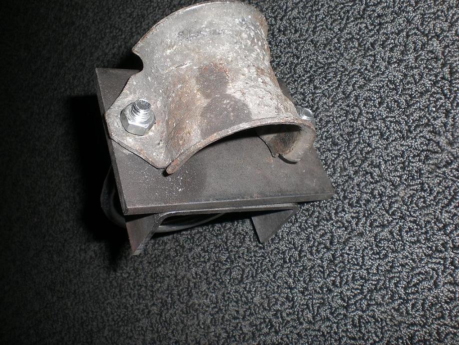

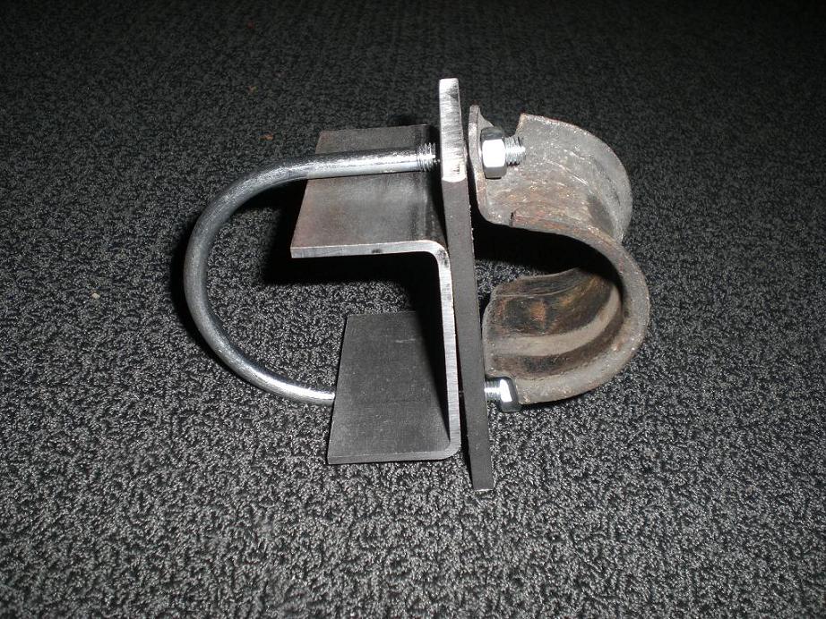

I started work on the anti roll brackets today and I got the brackets made that hold the anti roll bar to the axle. Once I do a trial mock up I will be able to make the brackets up that take the tie rod arms and them I should be able to get it all powder coated and that will be job done.

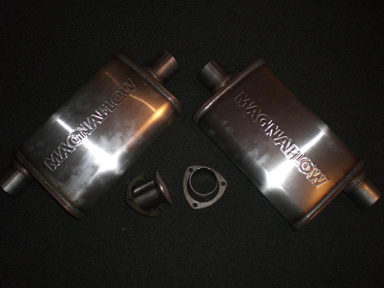

On Saturday I took a drive to Reel Steel to buy some exhaust pipe reducers (3inch header to 2.5inch exhaust) and while I was over that way I also went to a exhaust place (Profusion) near them and brought some Magnaflow silencers. My plan is to build my own Stainless Steel exhaust system from the headers back. Today I pick up the 3 metres of straight pipe I need from a company in Brixton (Solid Fabrications) and hopefully the mandrel bends I need will arrive in the post tomorrow and then I can cut and weld it altogether and end up with a full stainless steel 2.5inch exhaust system which should give my car a great new sound.
No restriction in these
2.5 inch Stainless Steel Magnaflow Silencers

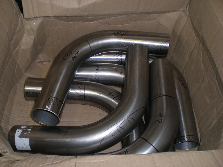

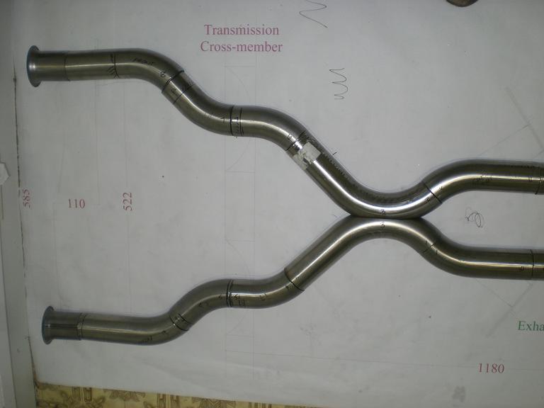

All the mandrel bends arrived yesterday so last night marked all the cuts that were need and then I did them this evening after work. Tomorrow I'll tack it all together and the do a test fit on the car before I final weld it. I order to save money I brought all 90' bends and cut them in two and then had two 45' bends. As you can see I am lucky enough to be able to do full size CAD drawings so I can do the mock up on paper and not under the car.
I have even included the transmision cross member on the drawing

Box of 90' mandrel bends all marked up

Very nice are mig or tig welding?

I will tack it together with a mig welder with stailess wire and if a friend will lend me his tig welder I'll tig weld it together once the test fit is done.
