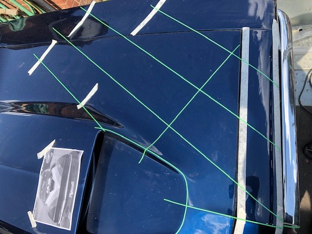

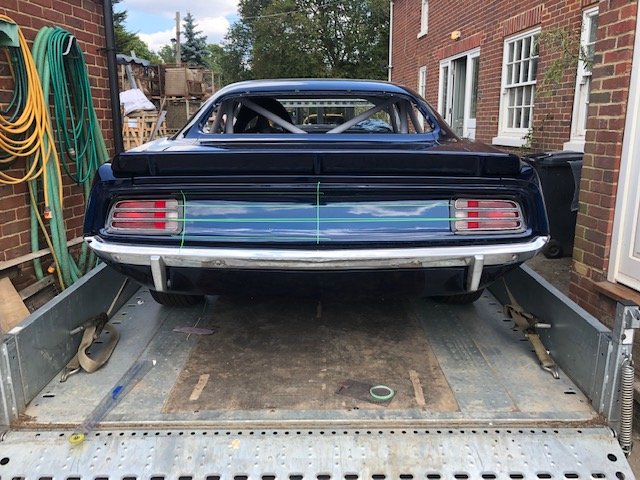

Yes here's the marking out ! I'm making the stripes a slight V-shape to match the panel contours .
- IMG_3867.jpg (98.96 KiB) Viewed 2694 times
Also been marking the bonnet for stripe treatment like the #42 car (artistic licence...). Lots of time spent comparing photos to get the proportions right.
- IMG_3865.jpg (71.1 KiB) Viewed 2694 times

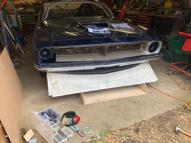

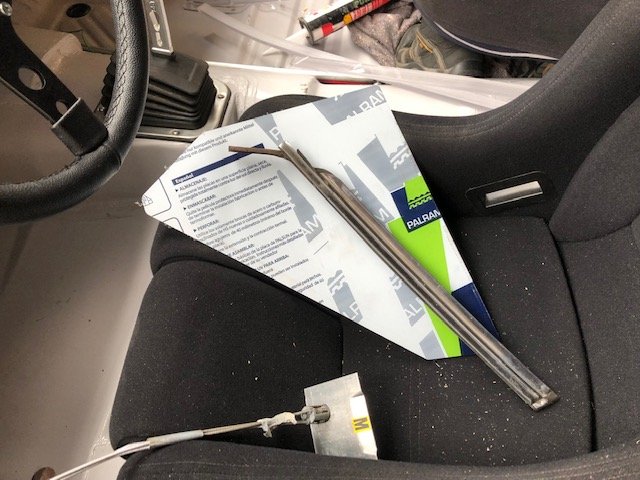

Thats the way, card template, then cut in ali. We rolled an edge to stiffen it and its still on there 5 years later. Made some very small braclets from folded ali that we riveted to the spoiler and made tabs with holes that pick up on the sidelight / indicator screws. This held it sufficiently and used all existing fixing points.
Top edge self tapped into the valance aperture where the trim goes, using the trim clip screw holes.

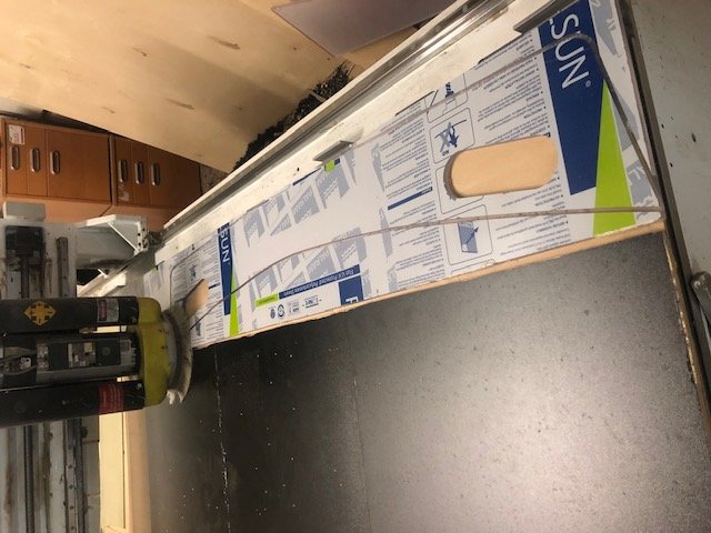

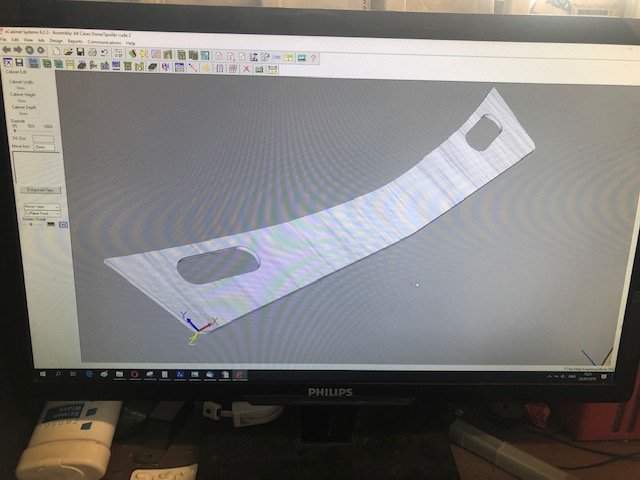

Bit more spoiler progress
Got the wooden template then drew it up in CAD
- IMG_3905.jpg (50.56 KiB) Viewed 2650 times

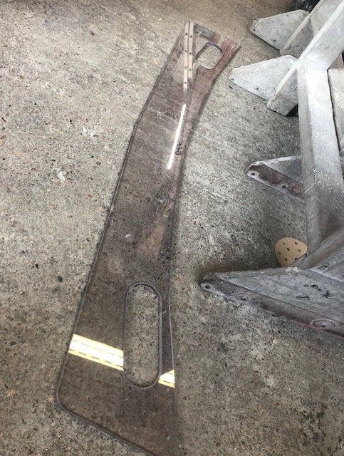

CNC'd it at work from 12mm Polycarbonate -handy offcut
- IMG_3901.jpg (70.22 KiB) Viewed 2650 times
Rounded the edges over with hand router
Ready to be painted tomorrow.

Matt, that spoiler looks ace. I didnt use CAD, I did sharpie and old Amazon boxes!
I look forward to seeing it and comparing spoilers, might be another commission for you.

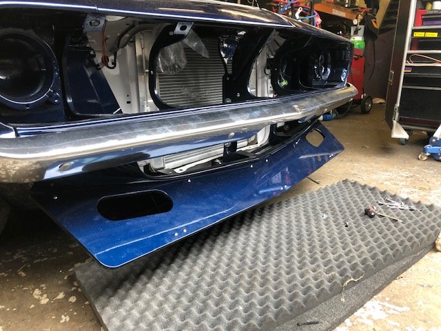

Spoiler fitted.
- IMG_3908.jpg (91.23 KiB) Viewed 2553 times

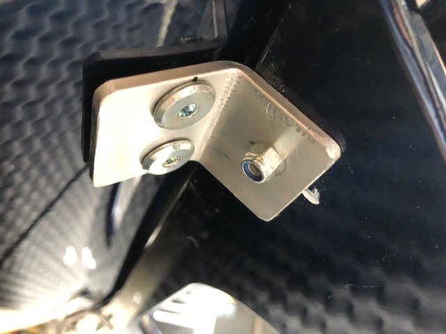

Six brackets for upper edge are held into the valance using two rivnuts each. Working well
- IMG_3909.jpg (52.48 KiB) Viewed 2553 times

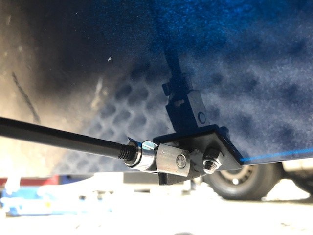

The lower edge is braced back (currently in three places) to the rad support - which unfortunately flexes a surprising amount. Might have to go all the way back to the K-member instead.

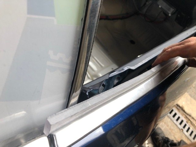

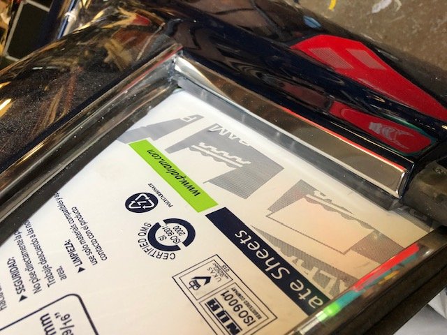

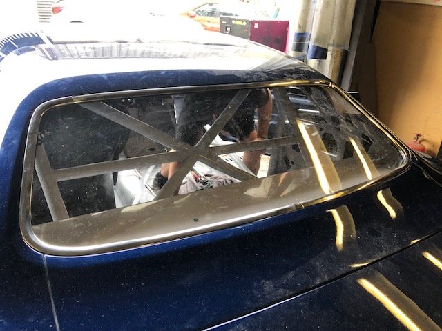

Rear screen cut from 4mm polycarbonate . Screwed into the body using 6mm plastic spacer blocks , butyl tape in the join, then PU sealant round the outer edge. Rear trim fitted after much trepidation - fit is fair, but at least I didn't mark the paint.
- IMG_3911.jpg (77.34 KiB) Viewed 2553 times

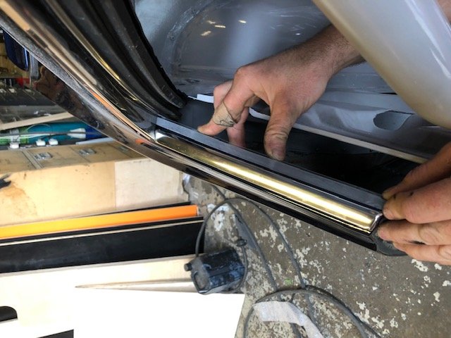

more polycarbonate cut for side windows, and some long 8mm thick spacers to maintain correct window position at lower edge.
- IMG_3913.jpg (76.63 KiB) Viewed 2553 times
- IMG_3914.jpg (71.98 KiB) Viewed 2553 times
- IMG_3919.jpg (48.76 KiB) Viewed 2553 times
- IMG_3920.jpg (83.47 KiB) Viewed 2553 times

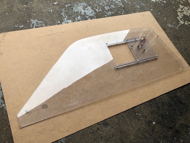

Door windows test-cut from scrap. Slider also designed and cut at same time. Slider is placed quite a long way back on the pane, but I wanted an unimpeded view of the door mirror.
- IMG_3928.jpg (71.38 KiB) Viewed 2553 times

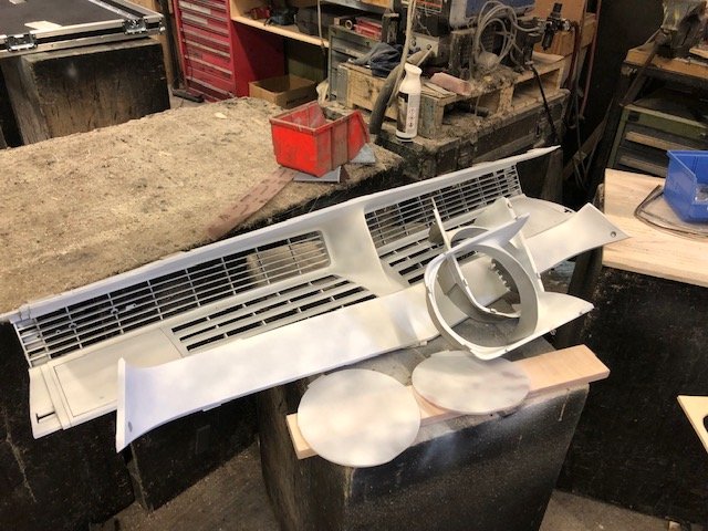

Grille etc in plastic primer waiting for black topcoat

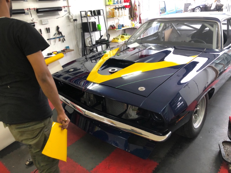

Stripes off to a good start
