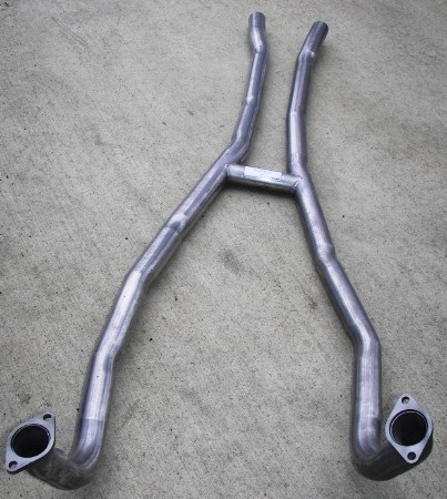

Also spent a bit of time under the car on Sunday, getting the exhaust sorted.
The plan was to see what we need to do, or to get done, to get the various bits we have into a useable system.
The front section (from the cast manifolds to the mufflers) that was on the car before all this started, was getting pretty rusty, and was originally made by Pipe Craft in Essex to fit to the 70-71 cast manifolds that we had on the car.
Looking at that part of the system now, I find it hard to believe a professional outfit whose sole purpose in life is/was to make exhaust systems, could have made such a poor job of the bends & welds!
So when we saw an Accurate front section to suit the manifolds we now have (68-69) on ebay (thanks to Miles on here for the heads up
), we jumped at it and got it as the only bidder.
Offered it up and it fits fine around the starter, torsion bars & prob but was a bit close to the kickdown linkage, so we've modified that to give about 1/4" clearance (see pic).
Surprisingly, the mufflers we had on the car fit fine with the new front section and the 'PipeCraft' over axle pipes that were on there before. They're not pretty either but will do for now. Certainly good enough to get it to the MOT. If we find it's blowing once we get it started and needs any major reconstruction, we've got Barry 'the bender' Grimes on stand-by to sort it out for us.
Gonna give the mufflers and the prop another lick of paint before we fix it all on for good, so I'll get some more pics up once it's finished.

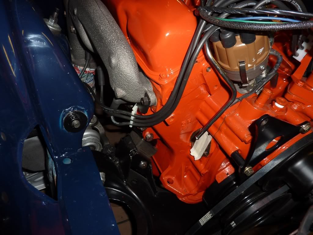

Gradual progress at Twinster Towers (Hitchin branch).
I'd have posted some pics of the brakes before now but my indoor-with-artificial-lighting shots are a bit dark to date, so I'll see if I can get the garage door open to shed some light, as it were

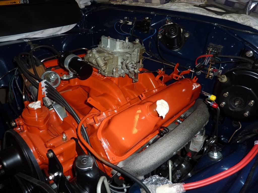

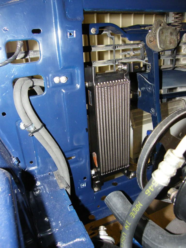

Trans cooler all sorted now, and now we have finally got some street hemi paint from Mancini's (via Ron Fenton, thanks Ron), we can get on and finish the engine bay stuff that we've been waiting to do

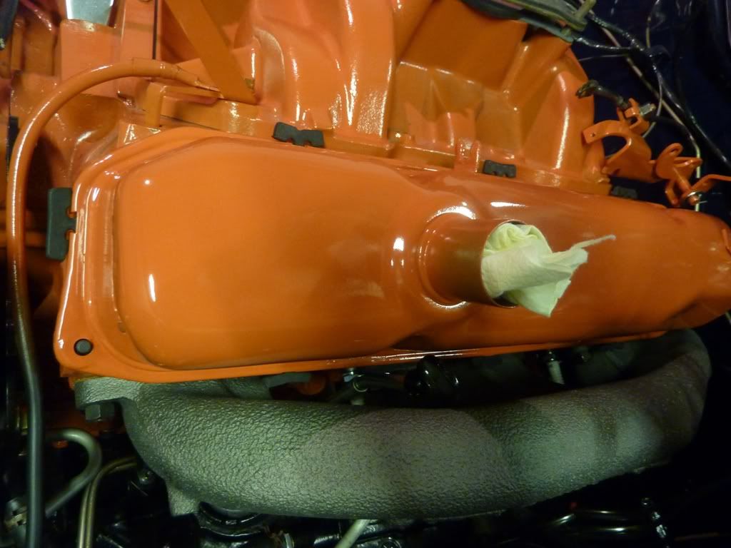

The valve covers needed a repaint too, as they were a bit thin when we got the engine back. Did that last weekend.

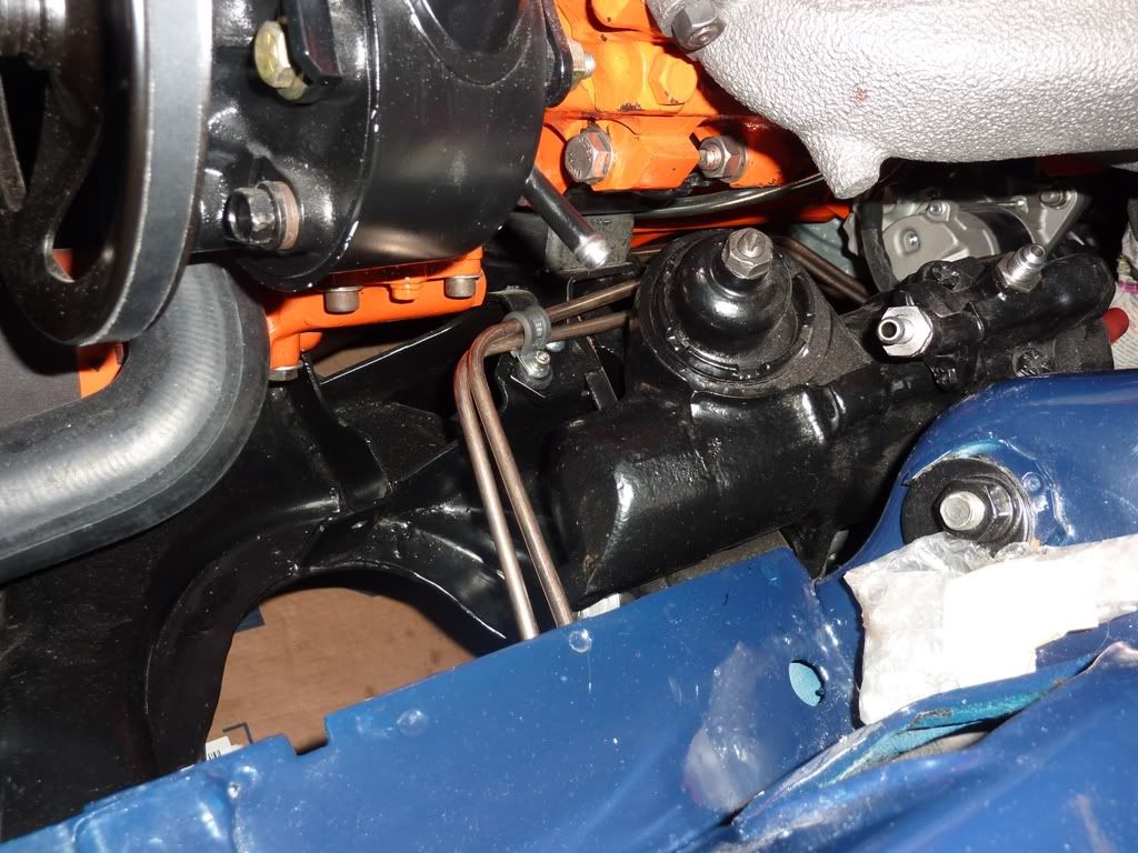

I've started tidying up the steering coloumn too so will get some pics of that when it's back together.
Nuts/bolts/washers needed painting as Paul K painted the engine parts before assembly, so Stu's now done the majority of those bits
Tabs still need trimming off the valve cover gaskets

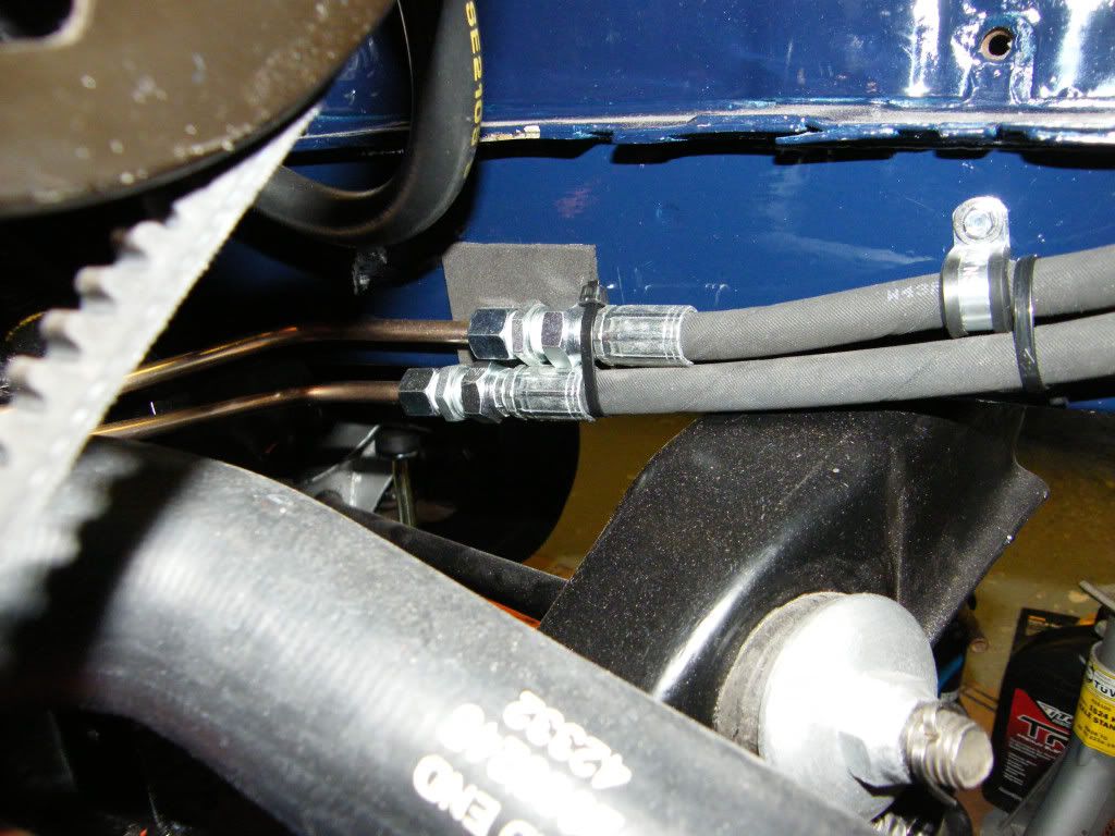

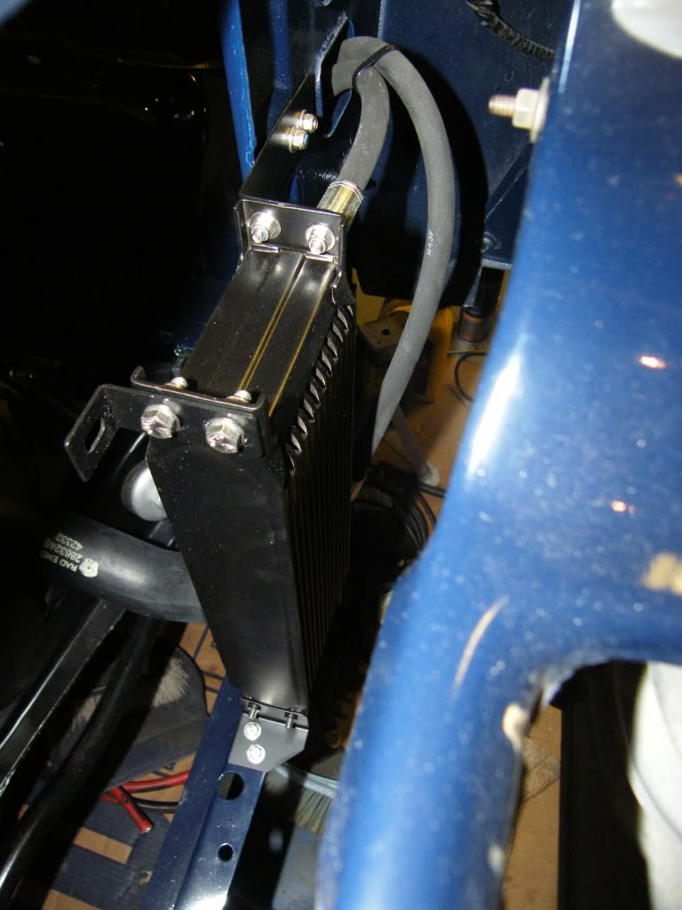

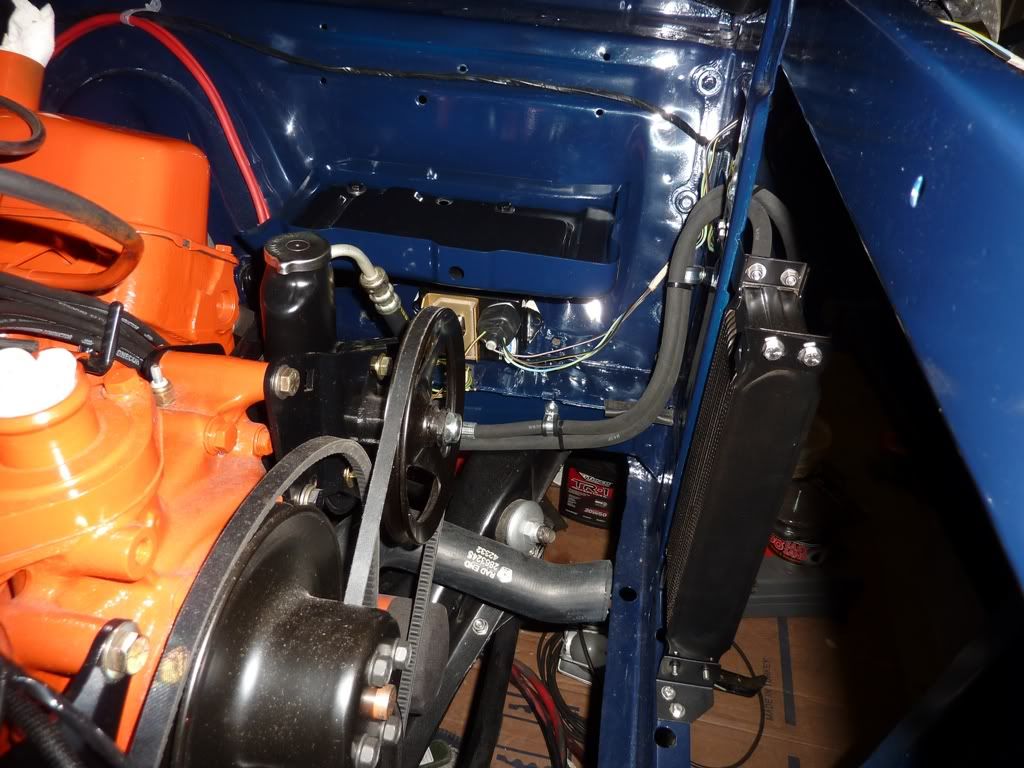

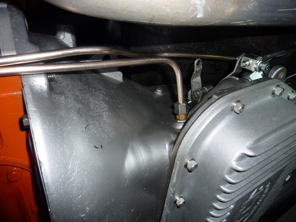

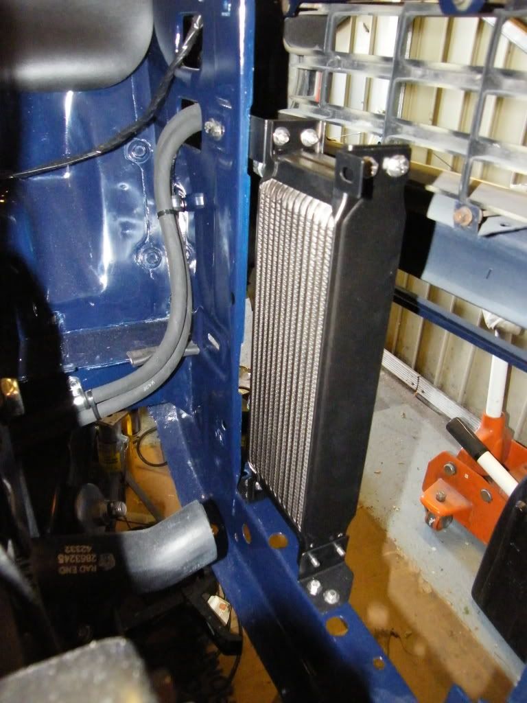

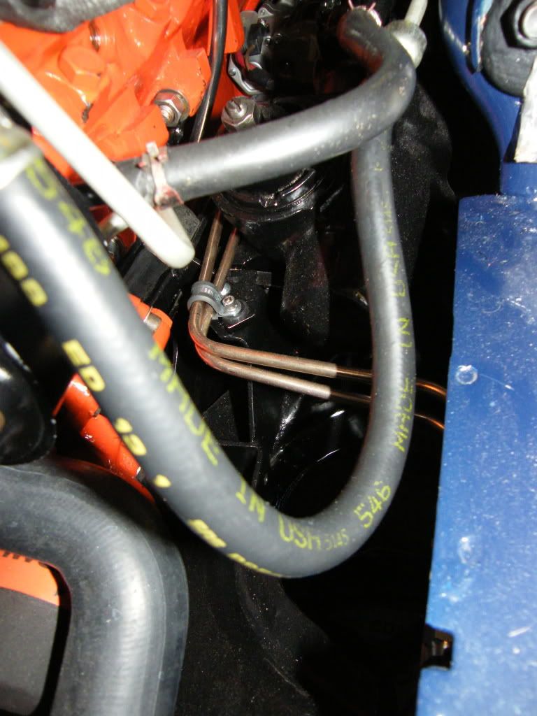

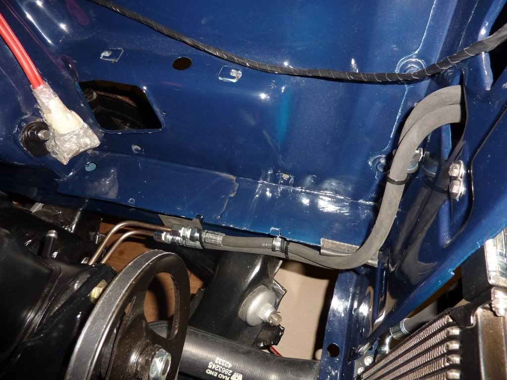

Speed Flow trans cooler with pukka rubber hoses & home-made hard lines
Transition from hard lines to rubber hoses should be hidded when battery tray is refitted to stock location (been in trunk since '87

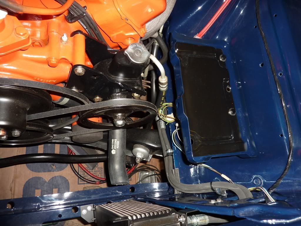

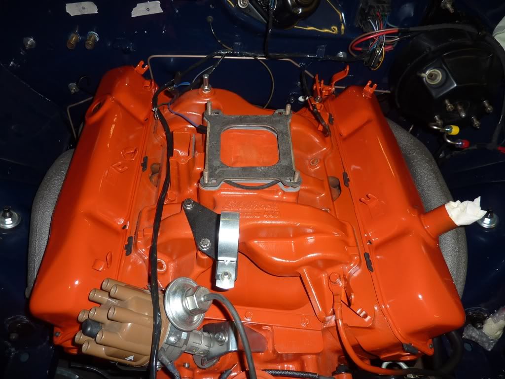

Been pondering where to fit the FBO 'orange box' (that's actually black
). Think we've decided on just below the stock ballast resistor pos'n but wherever we put it, it will look out of place as the car didnt have one (orange version or otherwise) originally and the gold coloured/plated bit sticks out like the proverbial sore wotsit.

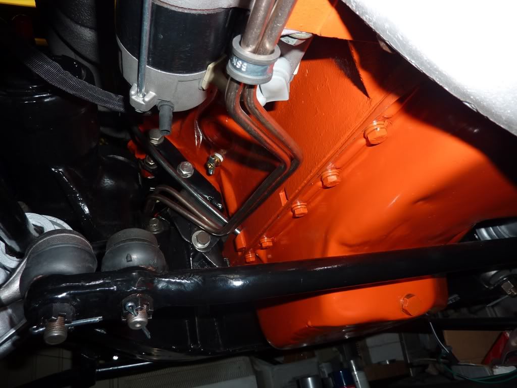

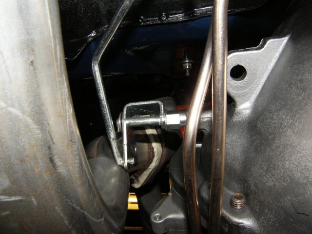

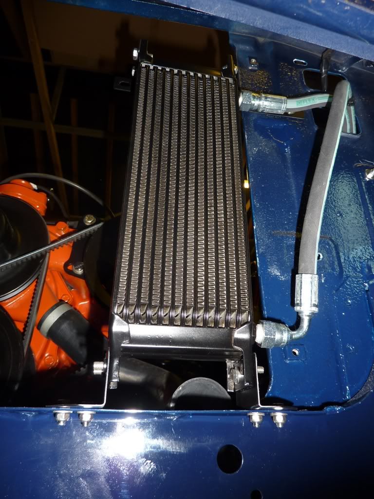

Few more trans cooler pics, inc the hard lines from the trans:

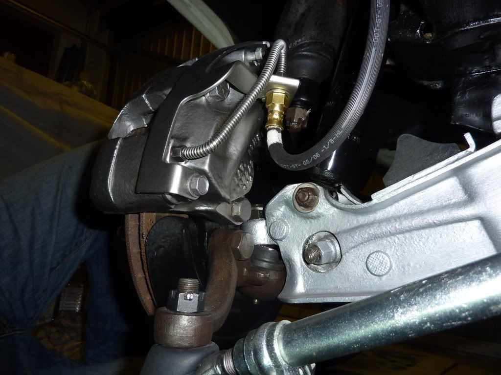

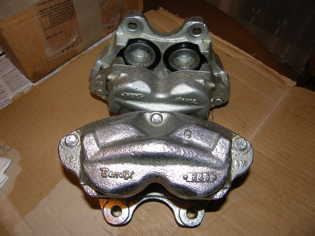

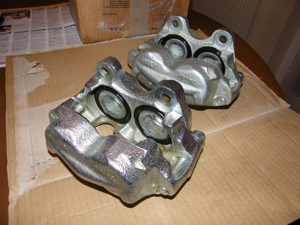

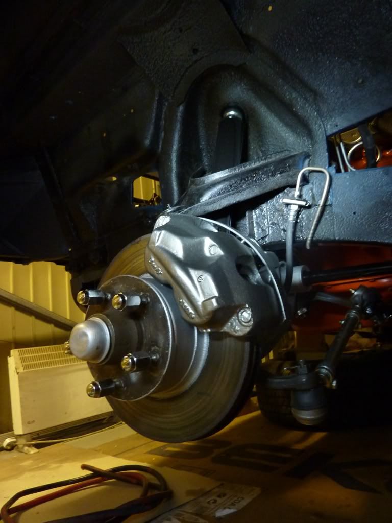

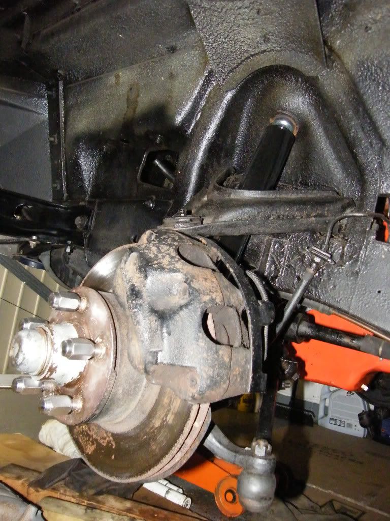

Front calipers have also been rebuilt and fitted with new hoses. Original 4-pot Bendix calipers were done by Past Parts in Bury St Edmunds http://www.pastparts.co.uk/ following a recommendation by Jon Conolly. Thanks Jon
Past Parts gave the option of either having them left natural (ie stripped & blasted), plated silver or 'gold', or powder coated silver or black.
As we wanted to try & get them looking natural but with some corrosion protection, we planned to paint them ourselves with one of the million different 'natural look' paints from Frosts, so had them plated first for extra protection.
This is how they came back from Past Parts. Any brown bits you can see are grease, not rust
Odd that the plating is 2 different shades as I'd have thought they would have got them plated together, but we werent too worried as they were going to be painted as well.
EDIT - Before pic added.

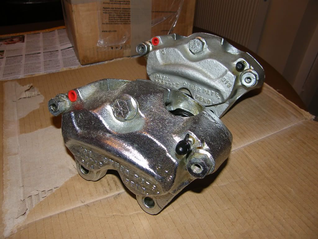

After - Rebuilt, painted & fitted

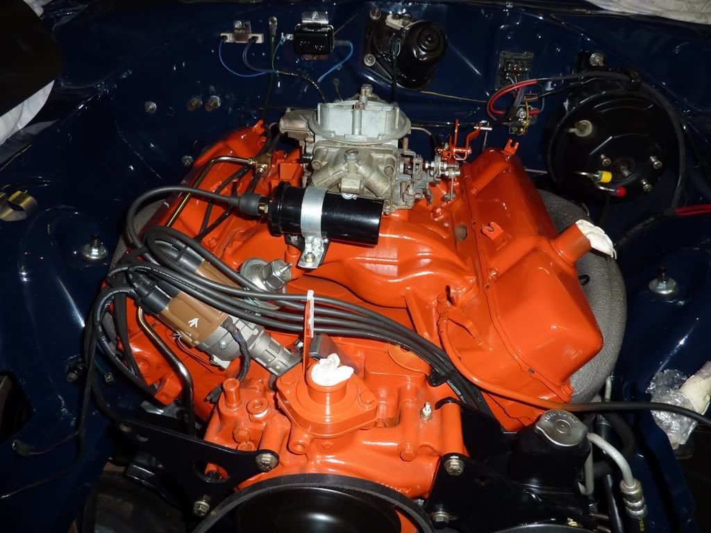

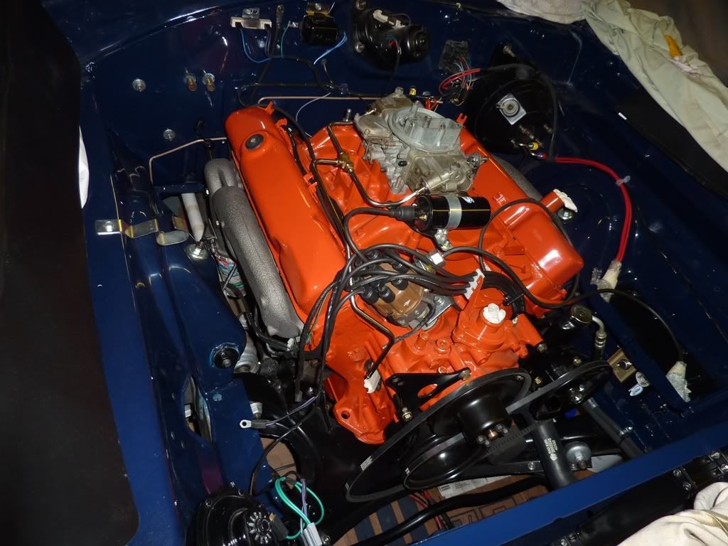

As I said before, now we have the engine paint, we've been able to finish off a few little jobs like painting & fitting the plug wire separators/brackets (from Year One) . We left the 2 off that fit under the head bolts (1 each side) as we didnt want to disturb the head bolts quite yet (they've only just been put on ferchrissakes
) plus acess is quite tricky now the exh manifolds are on. We'll leave them for a later date.
We've got a new fuel pump push-rod from Hughes but havent fitted that yet. Once that's back on, we'll refit the alternator.
FBO 'orange' box is now fitted under the battery tray; not quite as hidden as if it were inside the car under the heater, but that's one less hole we need to add to the bulkhead. We'll extend the wiring when we get the waterproof connector, and can use existing holes in, and loom/harness route around the rad support for the wiring.

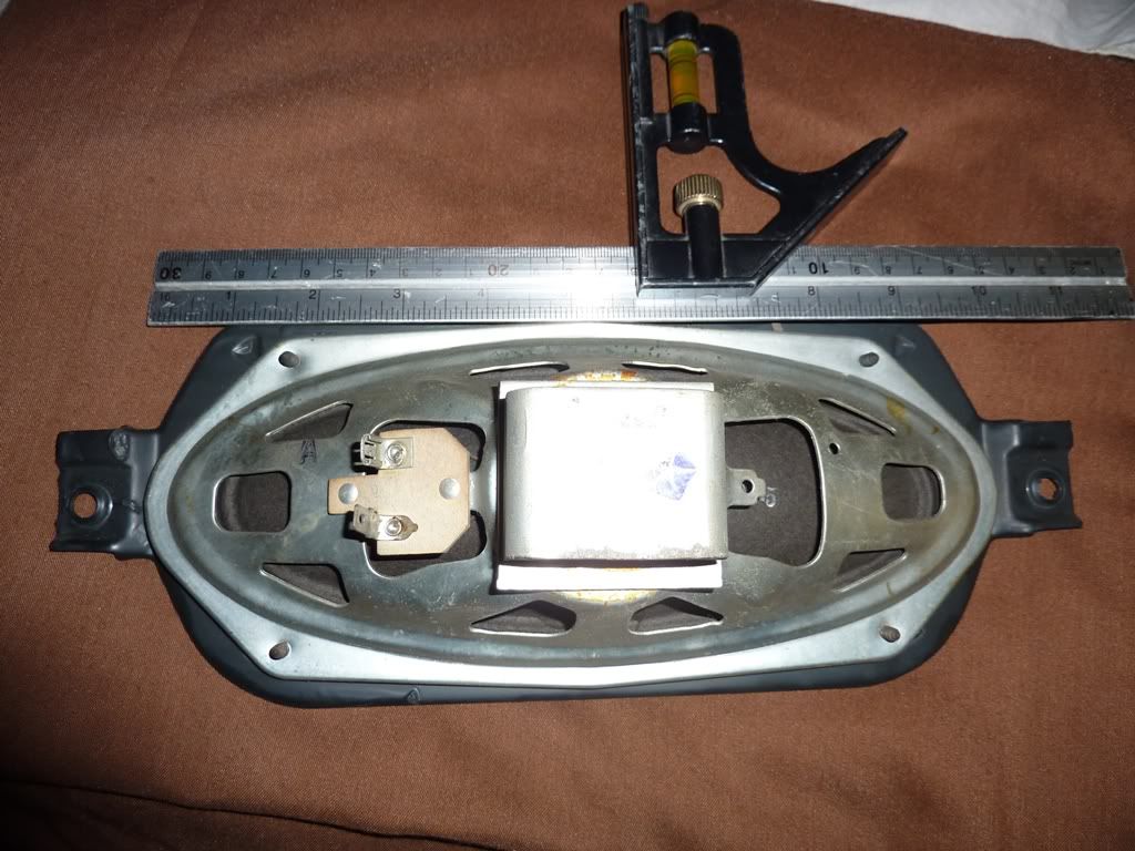

Few more little jobs done under the hood, but I'll get pics & do an update for that next time.

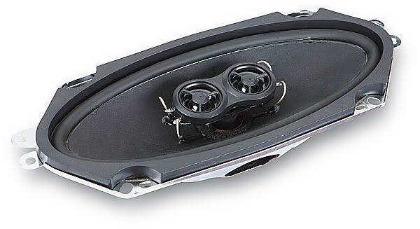

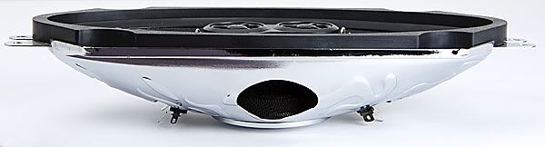

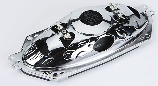

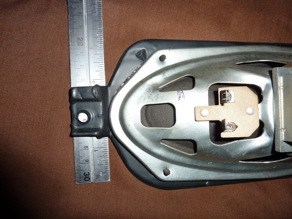

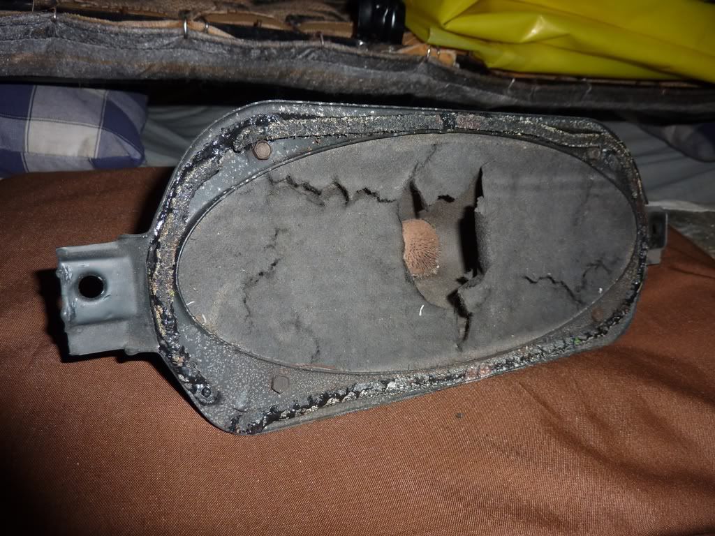

One thing that's been holding us up getting some of the interior back together is what to do about fitting front speaker(s)
We were looking at fitting a couple of 4" pod speakers I bought from the guy that rebuilt the radio, under the dash, but they're a bit too bulky, being pod speakers (ie 4" cubed, approx) so we started looking at whether we can utilise the existing single speaker in the dash.
There's a guy that posts on For A Bodies & For B Bodies who makes a plate that's the same size as the original speaker (4" x 10") and fits a couple of small speakers to give stereo sound but we've managed to find a company in the States that makes these specifically to replace the old single dash-mounted speaker.
http://www.crutchfield.com/S-0YAfrbQZuS ... html?tp=99
The bumpf says
"....The single R-410N 4"x10" speaker is designed for a classic car with only one speaker opening on its dash or rear deck. The woofer features dual voice coils, each one connected to its own tweeter. Your stereo receiver connects to both voice coils, so you get a stereo mix from a single speaker. In effect, you get two 2-way speakers in one frame, for modern sound in your vintage application...."
A bit more snooping on the net and I found a company over here that sells that make,. They dont stock the one we need, but theyre going to bring one in for us on their next shipment. We should have it in a couple of weeks. About £68 all in.
Okay, so it's not going to give the same stereo effect as if we'd fitted 2 speakers uder the dash, but that was looking like they were only going to be about 18" apart cos of all the other stuff under there (heater & controls, pedal assembly, glovebox etc). Should be good enough for what we want tho.
Original speaker removed:
New speaker from Retrosound:
Lets hope it fits...
The bumpf says
