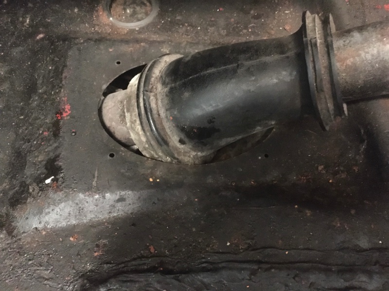

Whilst I’m in there, I’ve still got a much bigger ‘ole on the other side which I need to sort, where no one fitted a seal.

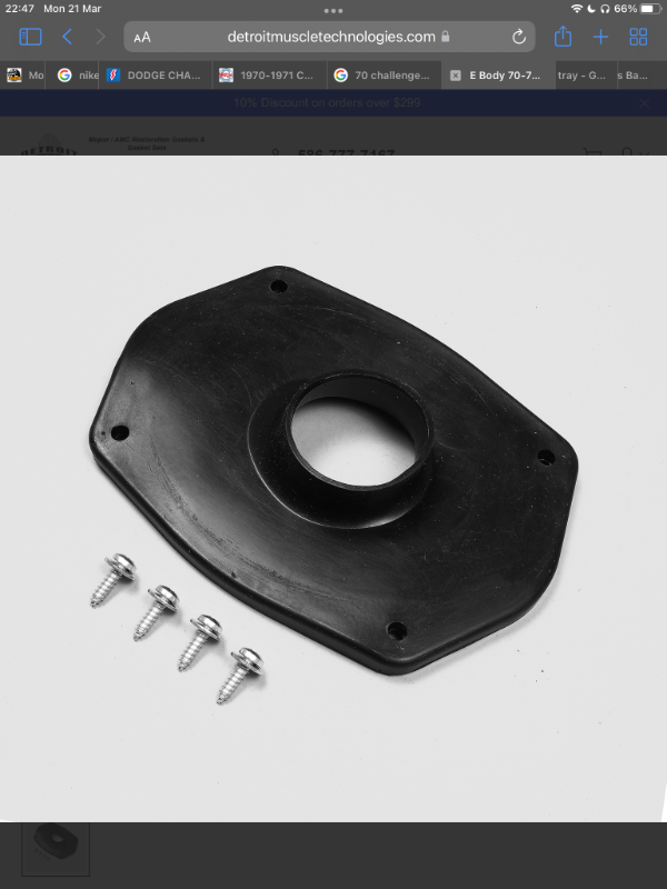

I’ve got a new filler neck to trunk seal, but bit wary about fitting it as never messed with a fuel tank before.
Been reading a lot of different opinions online and the manual isn’t clear really, quite a few seem to advise forcing the tube into the tank to be able to get the seal over the top of the filler neck away from the body. :-k No idea if I’m supposed to use any kind of sealant or what either. :help:

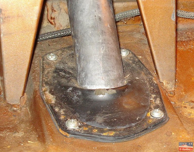

Anyone got a nice clear pic of how it should all look? And any advice gratefully received. I’d like to have dry clothes at the Nats this year if it Bananarama! it down. :D
Posts: 14537
Don’t know what that seal you have there is? There should be a donut seal that fits in the tank and a flat plate that fits to the floor around the filler tube.
I normally support the tank on a jack and lower it down, undo the filler tube from the body and then it’s it’s a case of wrestling the filler tube out of the tank while lowering it gradually. It can be something of a struggle. New donut seal gets fitted to the tank and a l good lubing up with petroleum jelly on the tube hole. Get the filler tube clean where it goes into the tank, slide on the new floor seal and the lube up the end of the filler tube. It’s then a case of raising the tank a bit at a time whilst forcing the tube in. Loosely fit the screws in the tube to the body before bolting up the tank. Fit the floor plate last once everything is in place. It’s easier with another person, one on the tank and the other fighting with the filler tube.

I was going to ask about the one that’s on there, it doesn’t look like any of the detail I’ve seen. :?
The new one I have is like the one below, which I believe is correct.
Was hoping to get this done during the week, but if it’s a two man job, might have to wait. :(
Cheers for the advice, sounds like I need to get the donut seal too, then. :-k

looks like our friend has used whatever was to hand as usual :roll:

Aha! Thanks for the link, Blue. Well, the good news is, I think I have one of those! Found something that looks like that in a pile of parts, but wasn’t sure where it went. Gareth must have ordered that with the intention of doing it at some point. :thumbright:
I’ll measure up later in the week and hope that means I can get it done shortly. 8-)
