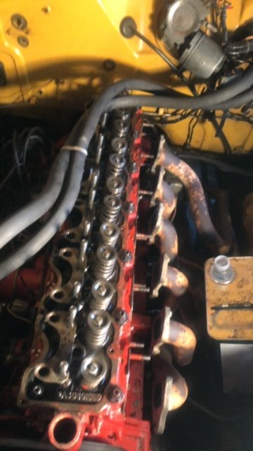

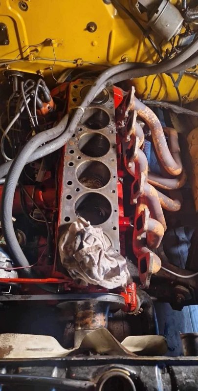

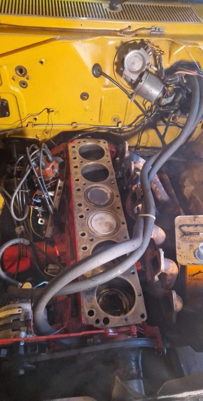

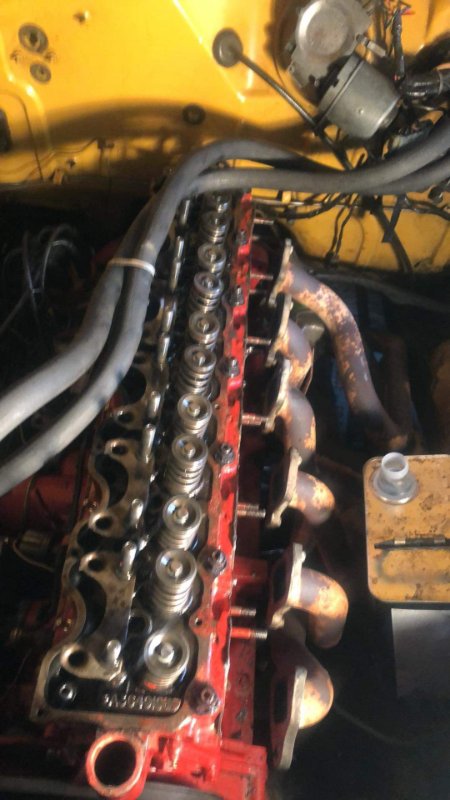

- back to where we started or is that the same photo i dunno
- IMG_0565.JPG (79.92 KiB) Viewed 30626 times

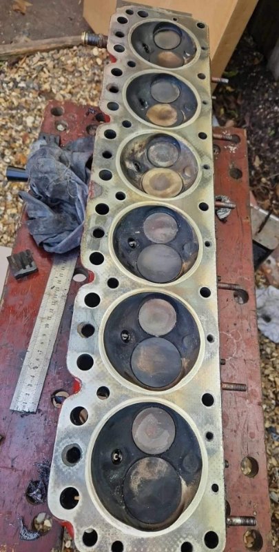

- clean? clean... not the chambers the gasket face. Not a hemi, but a Semi
- IMG_0564.JPG (97.12 KiB) Viewed 30626 times
- That'll do.... looks worse than it is
- IMG_0563.JPG (80.31 KiB) Viewed 30626 times
- after the first going over razor and steel ruler to remove stuck gasket face
- IMG_0562.JPG (88.6 KiB) Viewed 30626 times
- Start
- IMG_0561.JPG (48.79 KiB) Viewed 30626 times
- Not Happy but keeping myself amused, read the whole internet
- IMG_0555.jpg (39.04 KiB) Viewed 30626 times

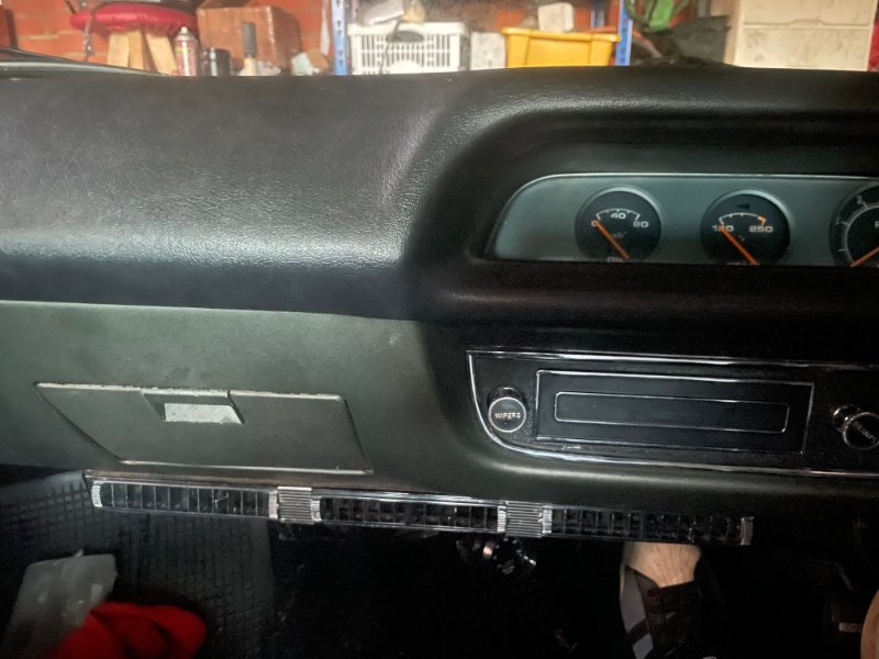

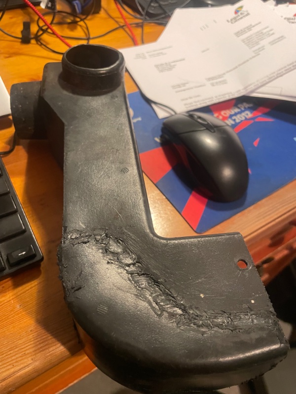

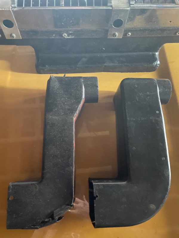

Trying to fix up the de mist and aircon unit vents
Plastic manifold on the car is the wrong one. It's too fat and won't allow fitment of the diffuser
The thin one necessary for the job is in a right old state
They are polypropylene. I.e. pretty awkward to glue
So I chopped up the fat good one, and plastic welded a chunk of it to the thin one
Ugly. Very ugly. But robust
ill sand down the mess later

Re: Dave999's Aussie Charger
you could now wrap it with self amalgamating tape for that proper 'belt and braces' finish, lol.

a long time ago (2003) in a galaxy far far away
i drove west from Sydney down the parramatta road and got lost in suburbia land...
i met a man who sold me an aircon/heater unit and the heavy weight metal and plastic vent/diffuser for a H51 RHD car
he also sold me a screen and some other gubbins a load of bits of dash lighting etc
i did some work in my underground sydney garage, which involved turning the aircon box into a box of spares which i have never used.....
the aim was always to get the push button unit and the under dash stuff working even if i didn't have the under hood stuff to go with it
at least i'd have demist and an ability to switch off the heater..
well finally finished that job 20 year later
the repaired plastic manifold (above) went on
i could then fit up the diffuser under the dash. its heavy...!
remount my lambda gauge on the bottom of it
next i fitted some small plastic vacuum T pieces that i got from china into the red and white vacuum pipes, replacing what was crumbling, and re plumbed in the tubes through to the engine bay
whacked the black one onto a vacuum port on a carb
and started it
mouthful of 20 year old leaves later all good
all vacuum activators are lazy
one might not work
but i can now have hot feet hot face or hot screen....
success

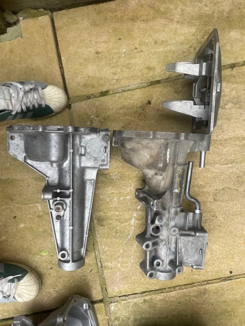

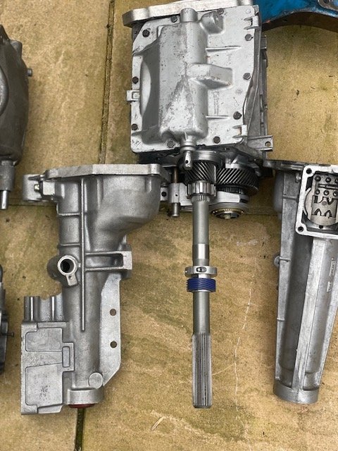

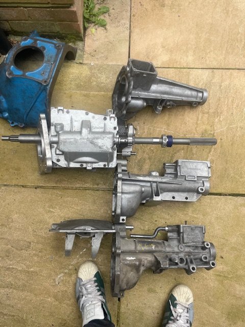

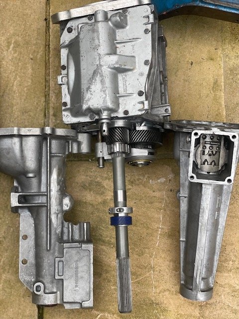

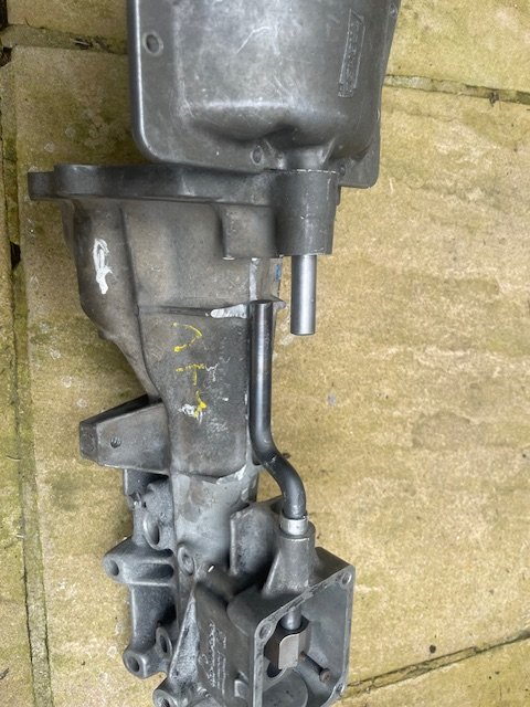

here are some pictures of the stuff i nearly did but then didn't
i.e a lot of messing about
illustrated below

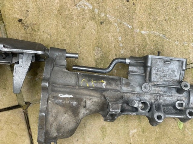

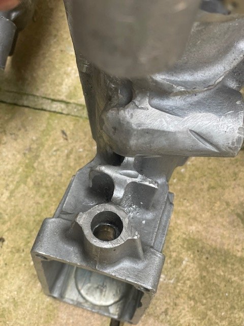

An australian t5 tail housing, modified by removing the shift rail tunnel and putting nice bushes and seals in the cut off ends left behind, and a nice bent shift rail to clear the cross member.
BUT the speedo housing/cable/drive and cross member wanted to share the same space when installed
SO
I modified a chevy camaro t5 tail housing in the same way. they have the speedo drive in a different place.
used the same bushes and seals and a nice bent shift rail
Much the same housing as the aussie one apart from a chevy shifter gate/detent plate and a stupid offset by 25 degrees rear mount.
All looking good, got the thing more or less ready to go.....NICE.
But the tail housing tunnel is so narrow and it has a flat roof from halfway down. it can't contain anything but an original chevy gear, mounted on an original chevy output shaft with a tiny spring clip. I don't have a Chevy output shaft on a Ford T5. Hence the aftermarket gear and adapter i have won't fit the tunnel this far back.... aaaaaaargh the replacement gears only fit in if they are further up the output shaft like on a ford box.
SO
i got Chevy S10 housing same shifter as the camaro, well at the base a least. but this time right up front.
put in box and then you can cut a hole in the tunnel in front of cross member.... all will be well. Honestly it will.... The speedo gear adapter fits, along with a chevy gear, and doesn't lock the output solid once the tail shaft housing is bolted down.
Yay!
put it in

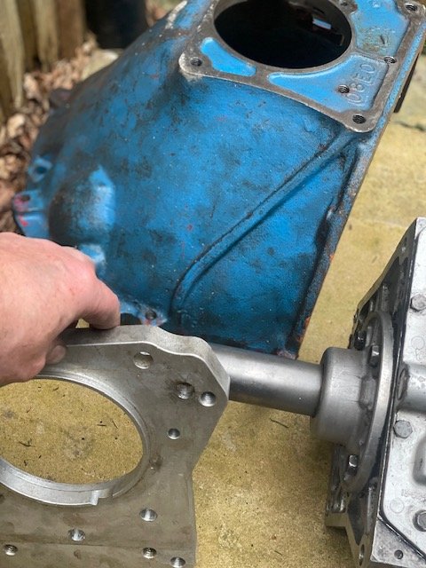

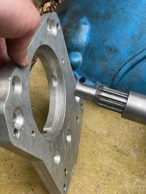

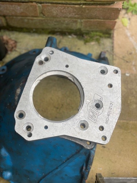

the fat 19mm bellhousing adapter i purchased to get the australian tail housing to line up with the rear mount is too thick.
i need the box forward 8-10 MM hence need a steel bellhousing adapter of 6-8 mm
it pushes the s10 shifter box back into the double skinned section just in front of the cross member hoop....

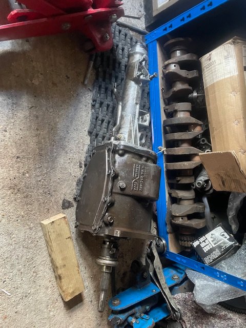

because i'd pulled out the close ratio 4 speed back in february
I decided on a change
I refreshed the wide ratio 4 speed
cleaned it all up, inside and out, layshaft pushed back lowered secondary gears pulled out input shaft, bearing off and cleaned, inside input shaft rollers checked greased up and back
checked all the gears main and cluster
checked clearance on the syncros
all good.
took shifter housing to Cramers in watford to be re-bushed 3 weeks ago... heard nothing...as per usual..... so swapped the one off the close ratio box across, which i didn't want to do they kind of wear into the job they do ally housing with oilite bushes mix n match is not good.
aligned it on the wide ratio box. new plastic button and saddle on the gearstick (like a type e ford rocket box shifter) and shoved the wide ratio box in
SO
SO
Yay!
put it in

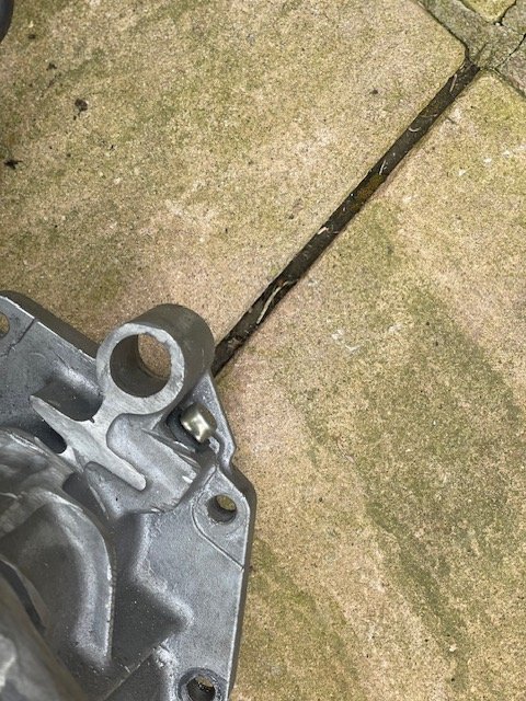

- The Cut off Shift rail housing on the Aussie Tail front
- IMG_0733.jpg (114.17 KiB) Viewed 13600 times
- Cut off housing Aussie tail rear with the speedo drive hump in front. Right in the wrong place
- IMG_0734.jpg (60.67 KiB) Viewed 13600 times
- Fat adapter has Ford dagenham pattern for bell and Ford T5 for box. i bodged it onto a 3 speed bellhousing for an Aussie 3 speed box
- IMG_0735.jpg (82.06 KiB) Viewed 13600 times
- 3 speed bell and other side of adapter
- IMG_0736.jpg (75.99 KiB) Viewed 13600 times
- Aussie housing left T5 middle S10 housing right
- IMG_0732.jpg (93.72 KiB) Viewed 13600 times
- Aussie housing illustrating frustrating speedo drive bulge
- IMG_0731.jpg (93.57 KiB) Viewed 13600 times

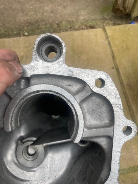

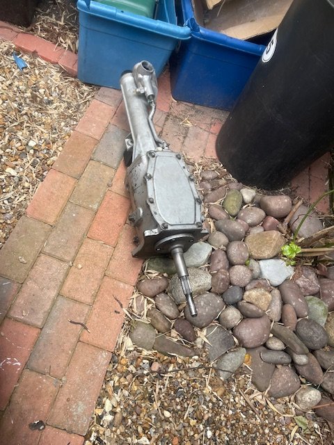

- Borg warner single rail australian 4 speed close ratio with shifter cup removed. This is A small, Steel cased Toploader. good for 285-350 Ft/lb depending on ratios and it fits an Early A Body auto trans, floor/tunnel with no modification other than a hole for the stick... why am i making my life so hard :)
- IMG_0744.jpg (158.15 KiB) Viewed 13600 times
- spruced up wide ratio borgwarner single rail 4 speed with shifter cup added note kinked linkage which was inspiration for the T5 plan in the first place
- IMG_0745.jpg (110.35 KiB) Viewed 13600 times

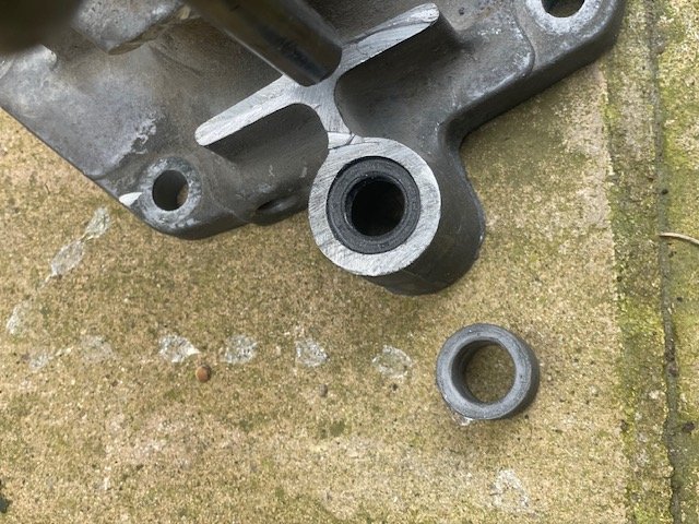

- Aussie housing with the nylon bush i made and the seal installed. the scroll section next to the main tunnel is flat. so this is a world class housing
- IMG_0740.jpg (67.29 KiB) Viewed 13600 times

- adapter in place
- IMG_0737.jpg (54.45 KiB) Viewed 13600 times
