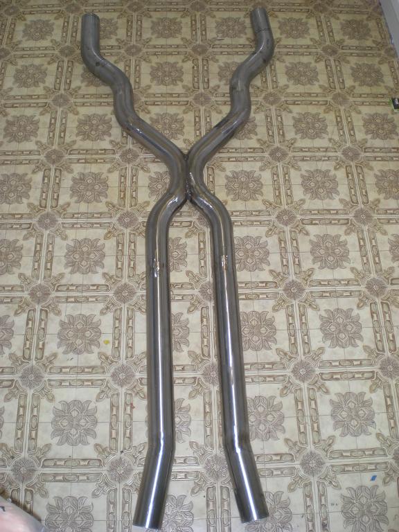

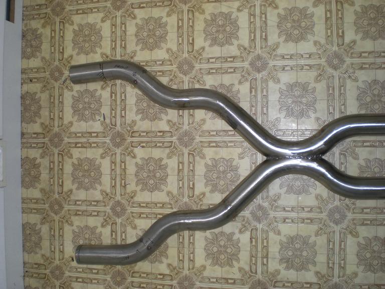

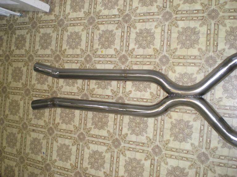

MY exhaust stops before the rear axle so I'm not making the over axle pipe at the moment but when I do there is a place near Heathrow that sells the bend that goes over the axle so that will make it easy. I also have my old over axle pipes which will help with the routing of the new over axle pipes. The other reason I'm not making the over axle pipes yet is because I want to finish the rear anti roll bar first to make sure it won't interfere at all.
I'm a CAD operator at work and we have a plotter that has a 90 meter roll of paper so can print almost anything. It helps to draw it first to save on trial and error.
ANTON
Posts: 2046
Location: Sutton,Surrey
Post by ANTON »
Well it's all welded up ready to be test fitted to the car which I'll do during the week and then I can Bananarama!.
The last two bits are only tack in place so they can be cut to length and have the reducers welded on once the exhaust is on the car to make sure it is straight and positioned correctly.

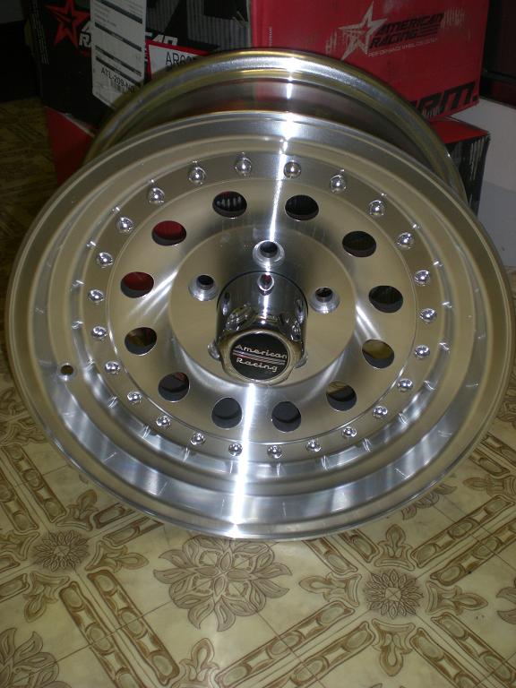

Got a nice surprise today my new wheels arrived and in a couple of days I should have my new wider(275) rear tyre's too.

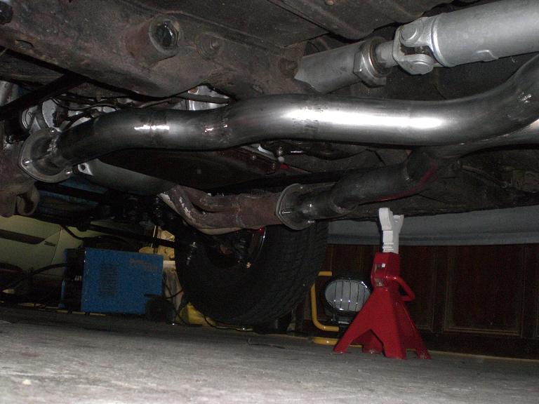

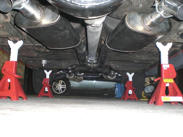

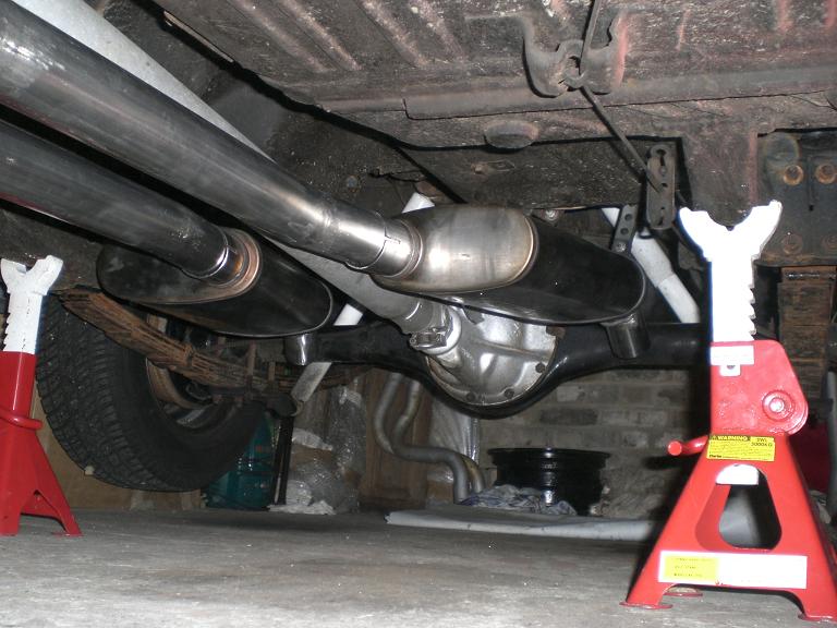

I have chrome on steel wheel at the moment but I always wanted ali wheels and now I have them. I put the exhaust on the car today and finished fitting it to the car and it is all welded and once the welds are cleaned up it can go on for good. I'll take some pictures when it's done.
ANTON
Posts: 2046
Post by ANTON »
Well I have spent the last couple of evenings in the garage fitting up my new exhaust and it is all complete now. It sounds excellent and I will upload a video so you can all hear.

nice job 8-)

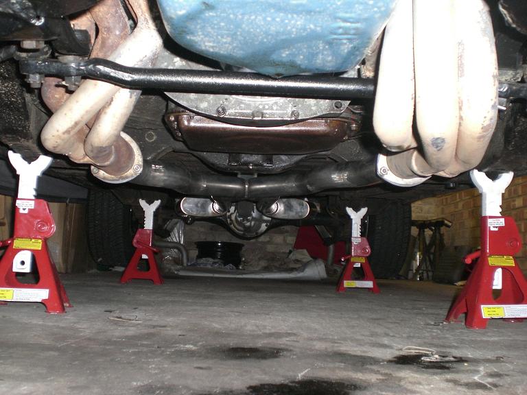

Anton , don't know if its the way the pictures is !! but becarefull , look at the driver side axle stand rear , looks like its close to the front of the rear chassis rail might slip up & dent , go through the floor
