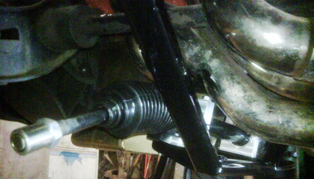

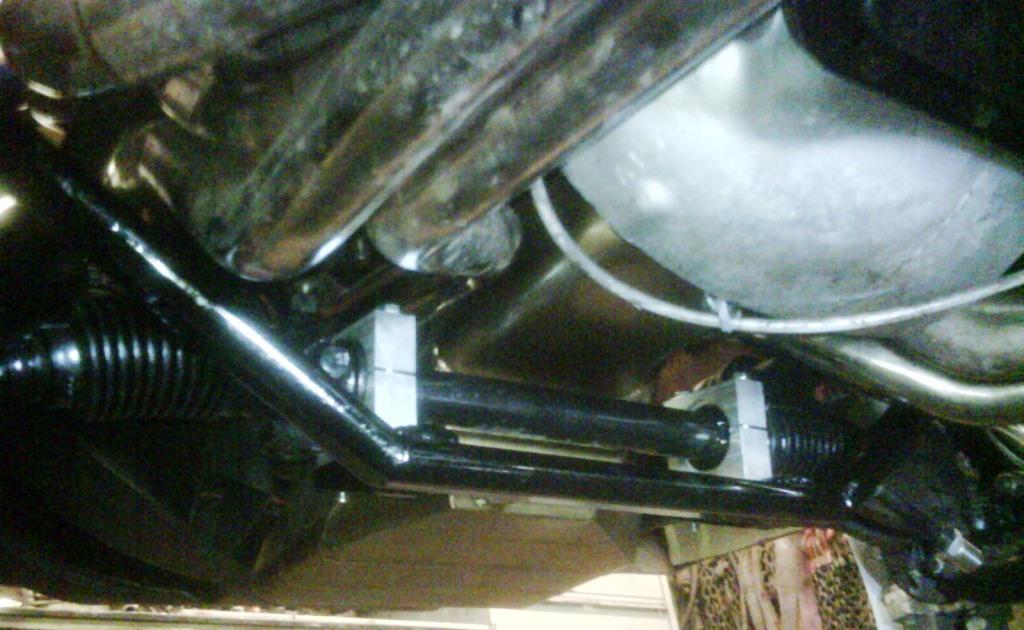

Mustang 2 rack and pinion wouldn`t fit due to being a " pusher " v`s a " puller ". Could have fitted it way out front and turned the bottom ball joints around so they faced forward and picked up on those, but would have been a P.I.T.A.
Have now got a Lotus rack and pinion narrowed which sits on an oval section steel tube dropped frame welded onto each chassis rail. Final connection will be via rose joints and have the option of top or bottom mounting on the existing ball joint aperture to get that final 1/2" of up / down adjustment.
Have made an adjustable suspension travel limiter also ( not in photos ) to allow the suspension to travel anywhere from 2.5" to it`s maximum of 4.5" to try to limit the overall arc of bottom ball joint travel. This can be completely bypassed if it hinders the launch.
Plenty of weight has come off and everything is in the right plane at all stages of front suspension travel.
Will try it out at HRD`s

That's when the Ackerman angles go out of the window.Jon Connolly wrote:Mustang 2 rack and pinion wouldn`t fit due to being a " pusher " v`s a " puller ". Could have fitted it way out front and turned the bottom ball joints around so they faced forward and picked up on those, but would have been a P.I.T.A.
Good solution, do you think there would be enough sump clearance for a BB installation?
Keep at it!!
