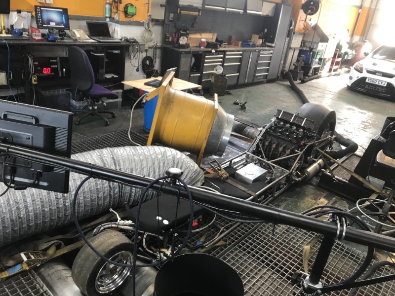

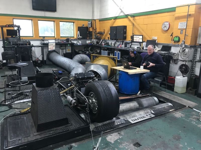

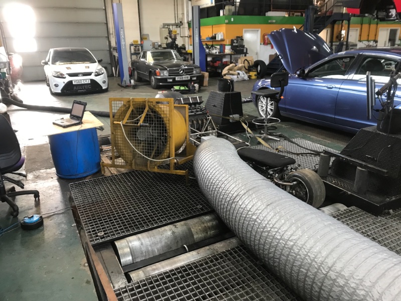

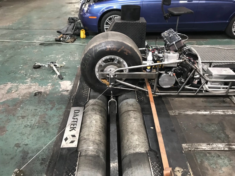

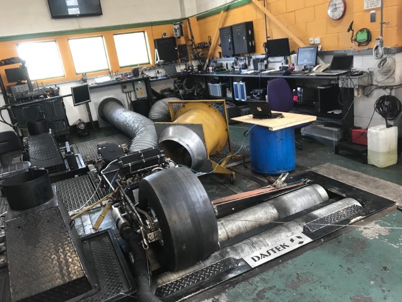

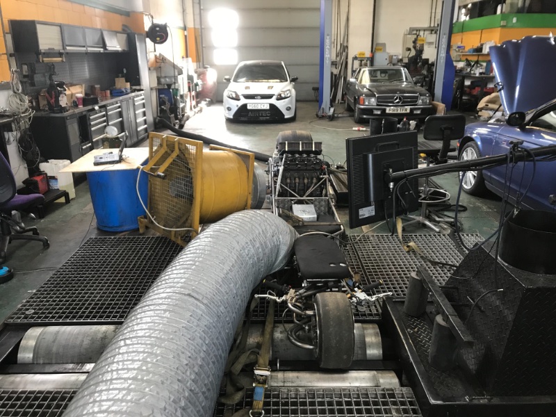

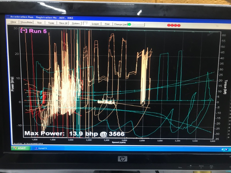

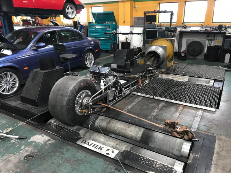

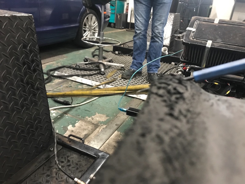

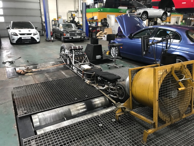

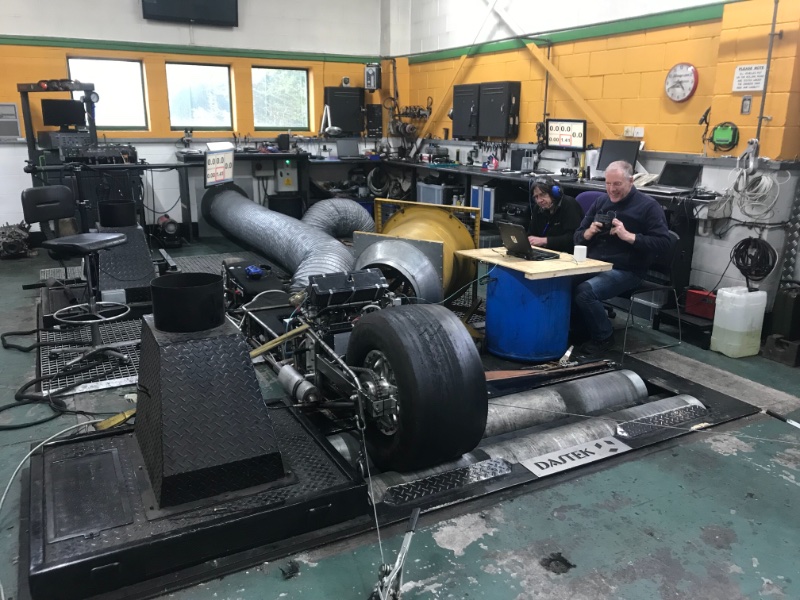

The dyno loads the engine in a strange way which requires a special dyno clucth set up. I wasn’t aware of this nether was this mentioned in any documention. This caused the clucth to melt and leave the building at 14bhp

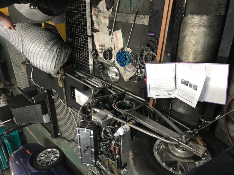

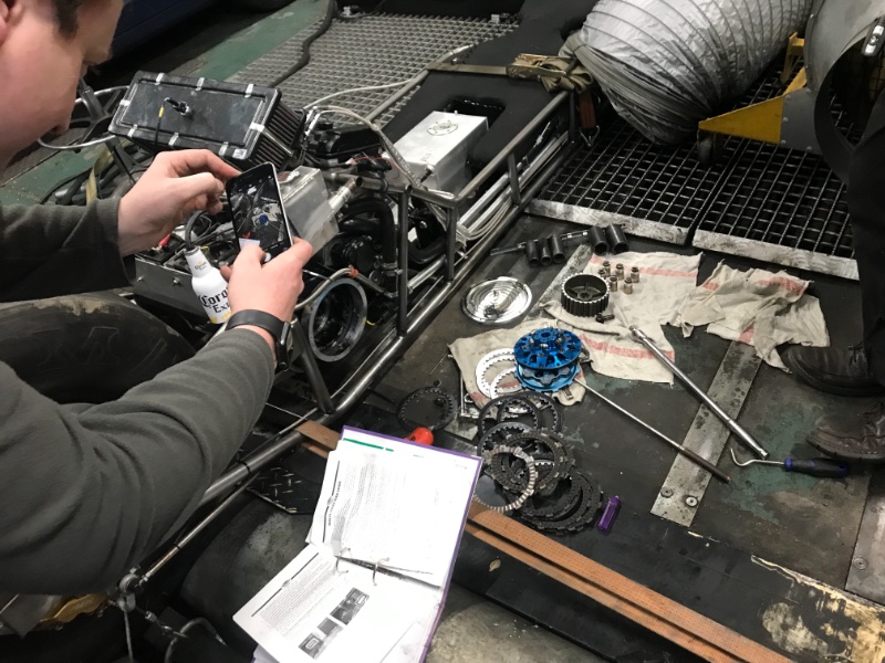

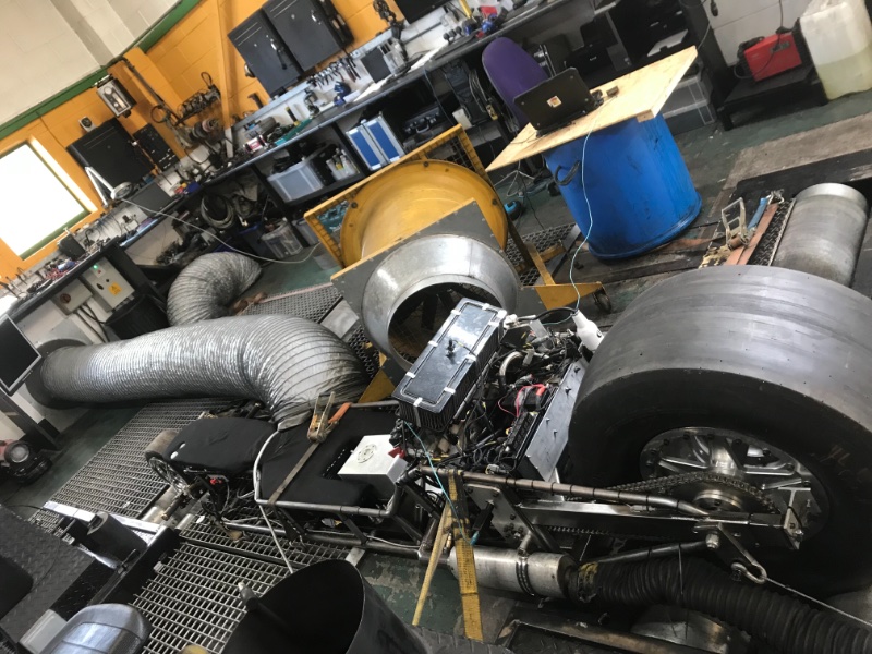

Spend the complete night on the lathe “making the clucth assemble lighter for racing” - :roll:
Managed to find a new set of clutch plates
Dumped the oil and got the sump off to get the rest of clucth out. Flushed the motor a few times and filled it back up with fresh oil. Adjusted the clucth to lock fully at 500rpm
Started it up and all seemed good .....

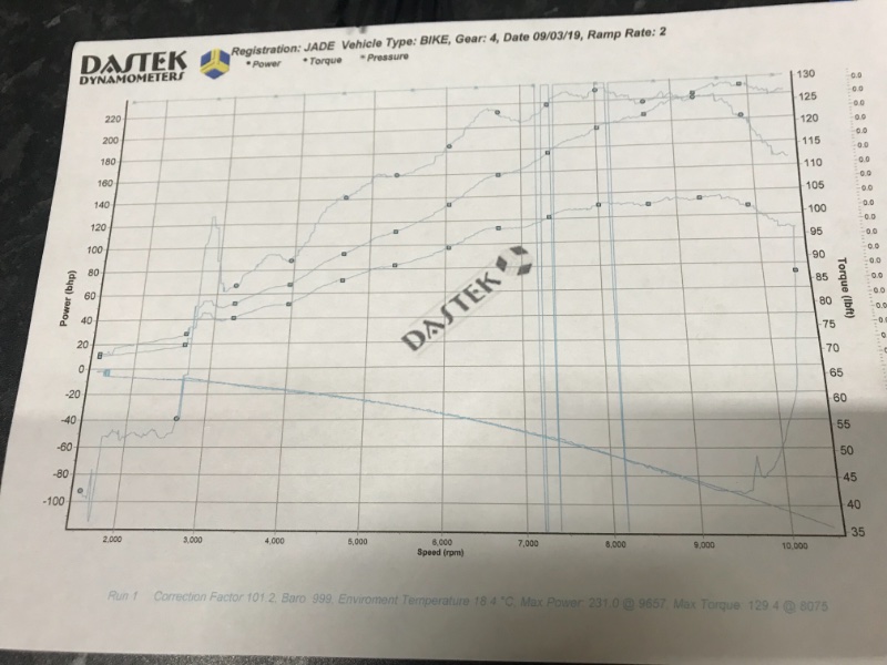

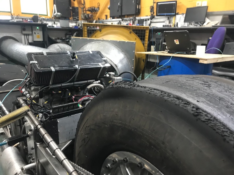

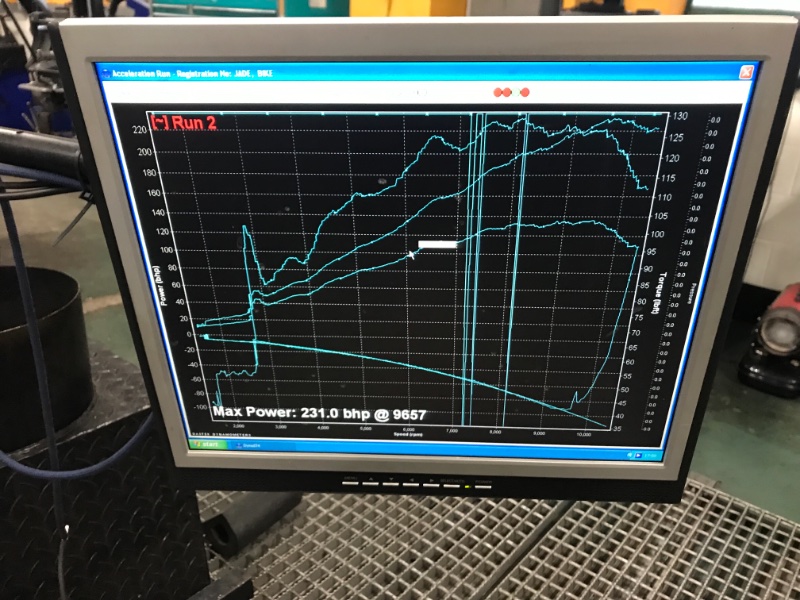

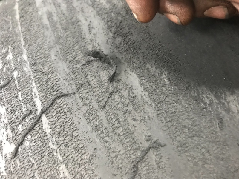

Bike made 230hp on the dyno after hours and hours of fuel and timing adjustment.

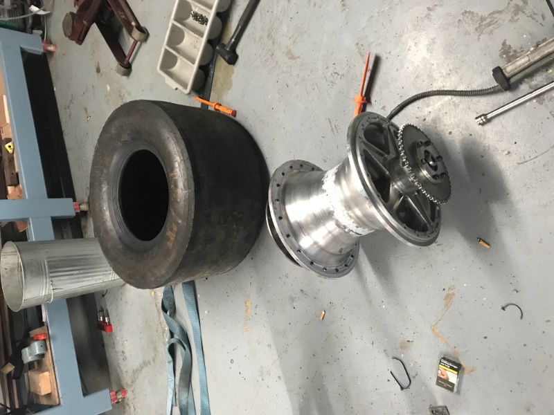

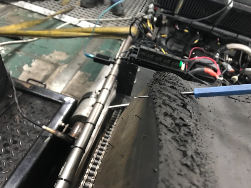

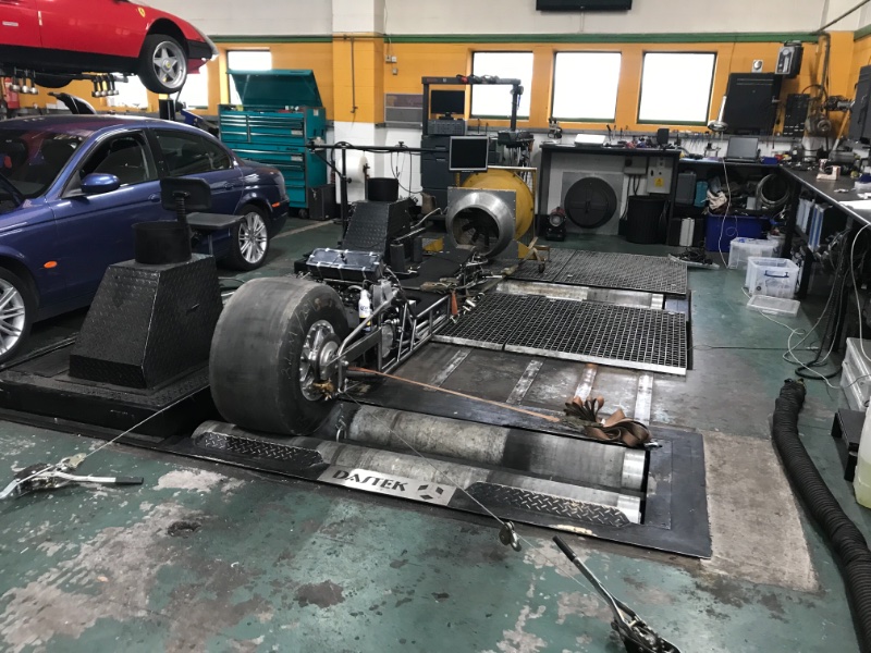

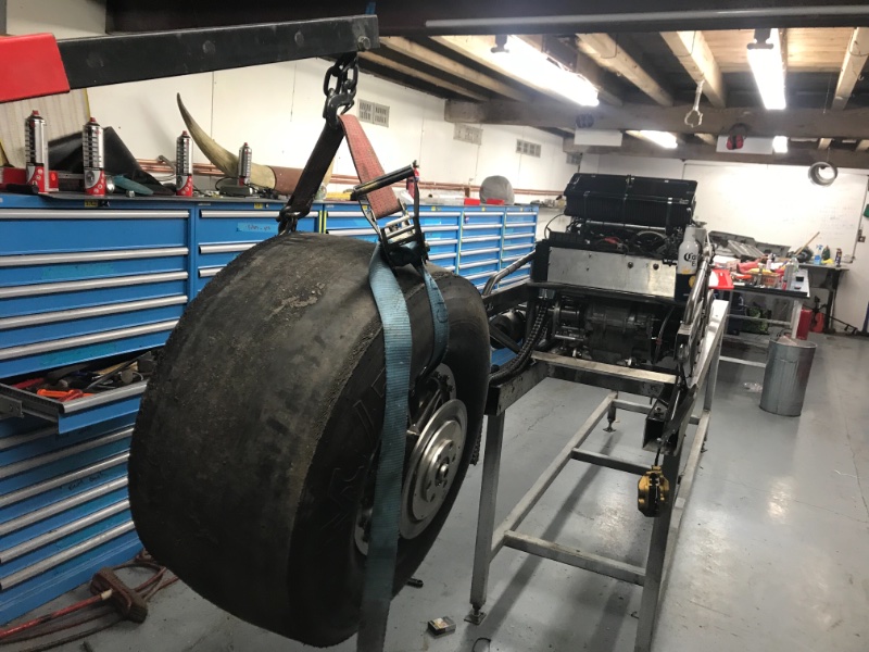

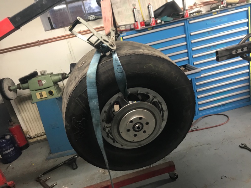

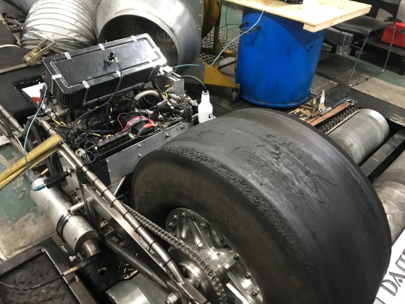

On the last few high power runs at 11,000rmp the tyre developed a bulge :x
We watched the tyre very carefully adjusting pressure and load all day. It’s very strange and look more like manufacturing defect

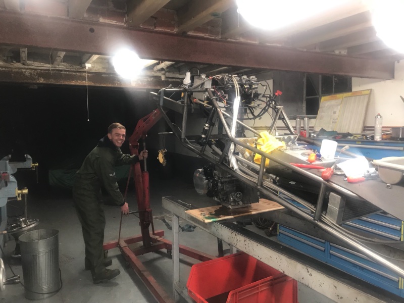

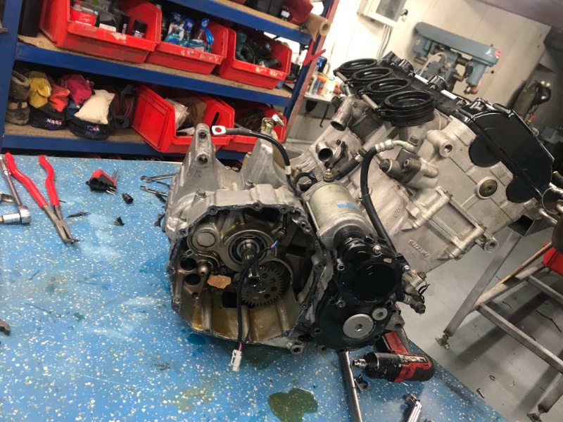

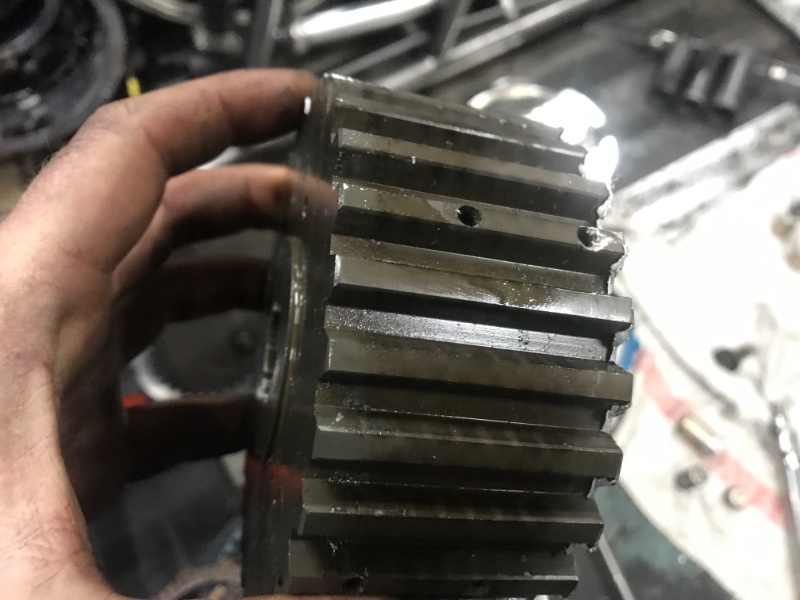

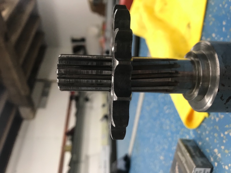

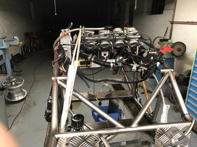

Re: Fifty shades of Jade

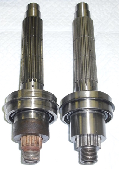

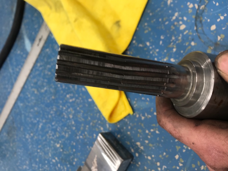

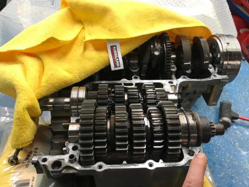

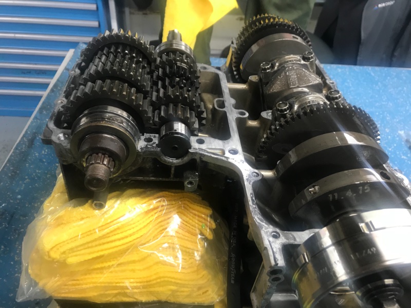

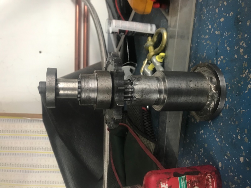

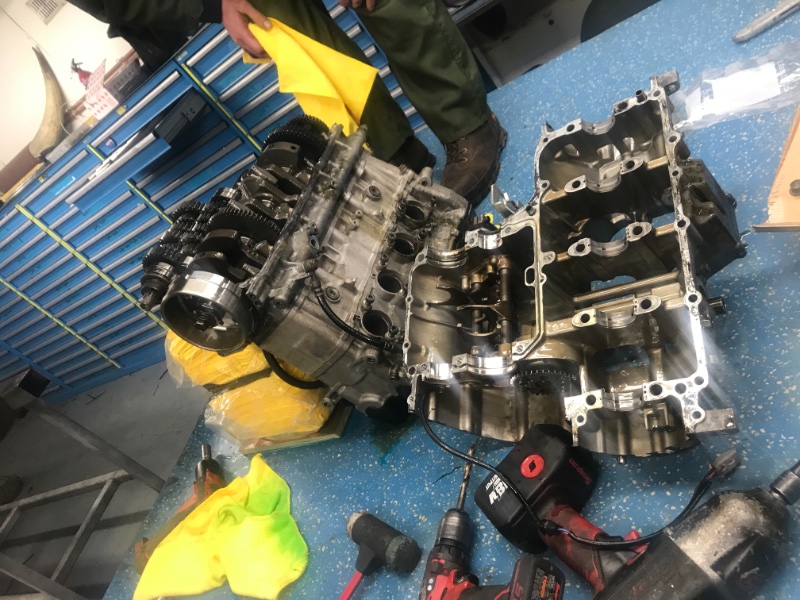

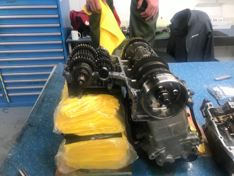

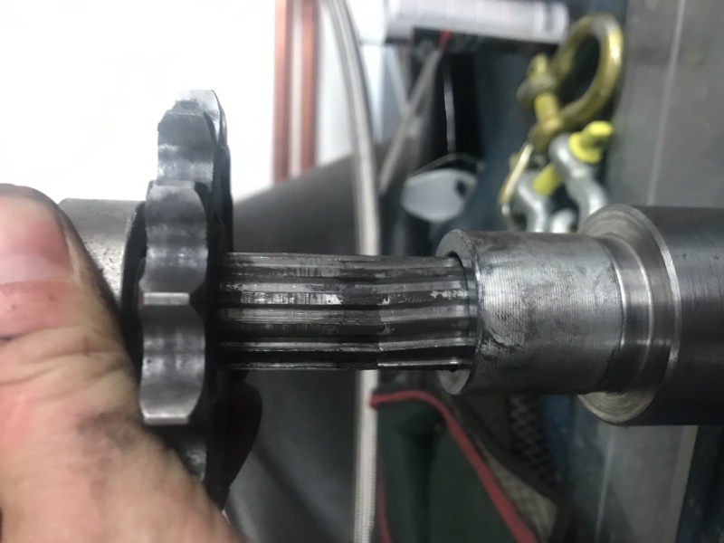

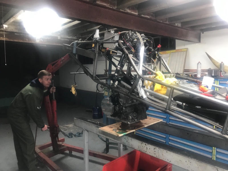

So the standard busa output shalft is renound for being an issue but was hoping not to have to replace this till higher HP

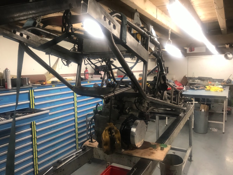

Engine out split crank casing everything out :pale:
FML

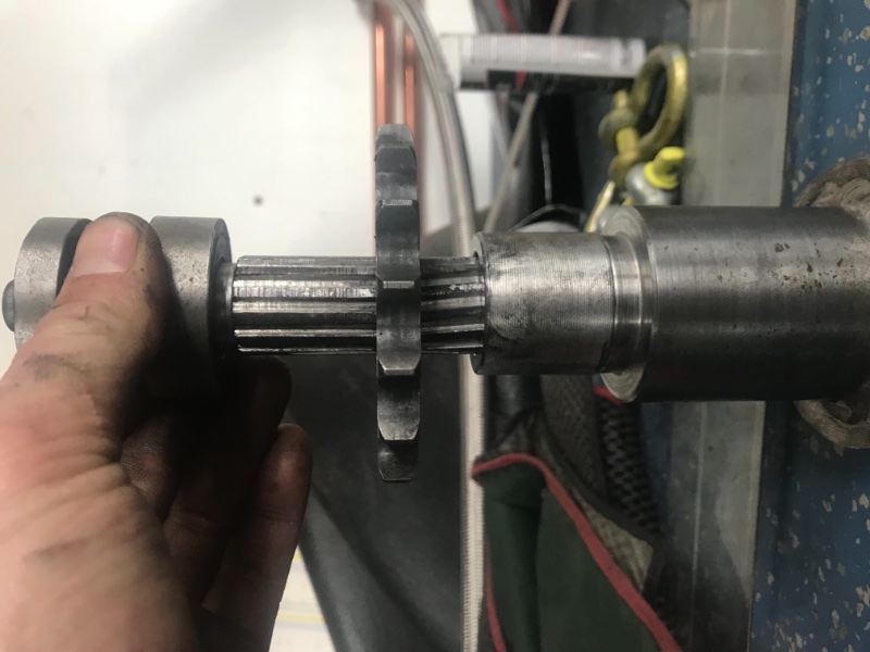

Note the larger output spline size
