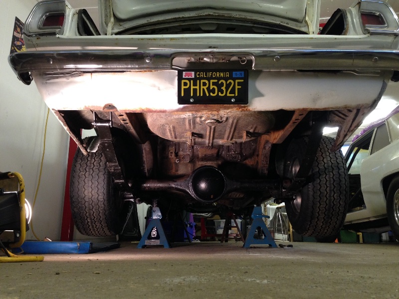

Quick mock up to make sure I can read a tape measure, narrowed E body 8.75 case with Strange shafts. 28 x 10.50 Mickey Thompsons on 8" rims fit nicely with no other mods, phew! All removed again and back on with the scraping....
