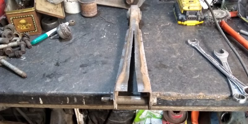

I now have all the running gear installed in the car , this is axle number 3 #-o 8-[
Ford 8.8 narrowed with Ford explorer ends welded on, as the explorer shafts are 31 spline and wouldn't fit in the tubes :-k

that's pretty, will you box the upper and lower arms for strength/stiffness? it's a common trick for gm a body cars to help with handling.
TIB3300
Posts: 631
Location: Sheffield
Re: Cortina MK3 with V8 Dodge 318
Post by TIB3300 »
mygasser wrote: Wed Aug 25, 21 9:05 am that's pretty, will you box the upper and lower arms for strength/stiffness? it's a common trick for gm a body cars to help with handling.
Hiya Neil
I have added a 4mm flat bar along the lower arms on the inside of both, I did think of boxing them, but didnt in the end.
As I wanted to see if all worked well first :thumbright: I do have a spare set of arms I could make up :thumbright:
