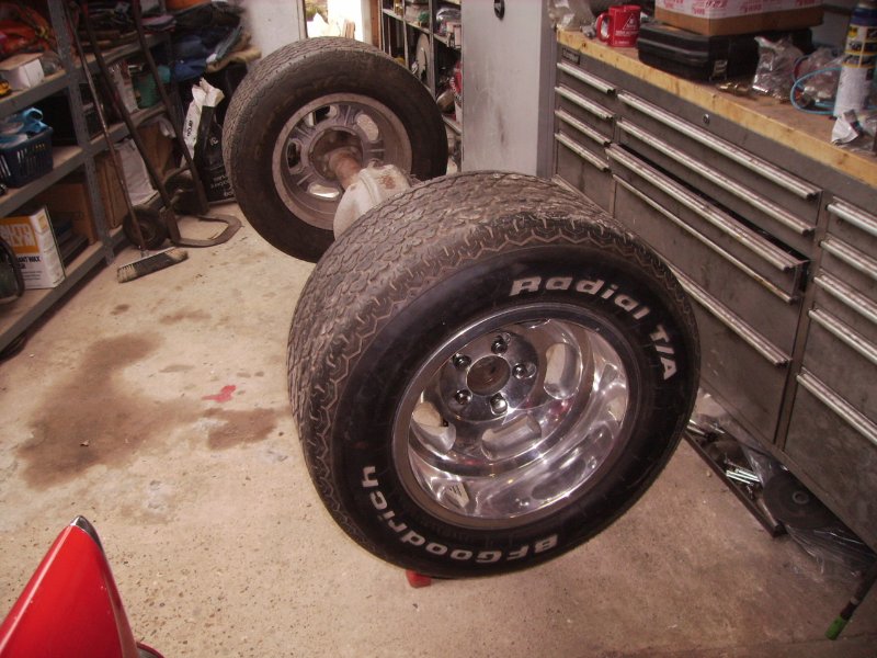

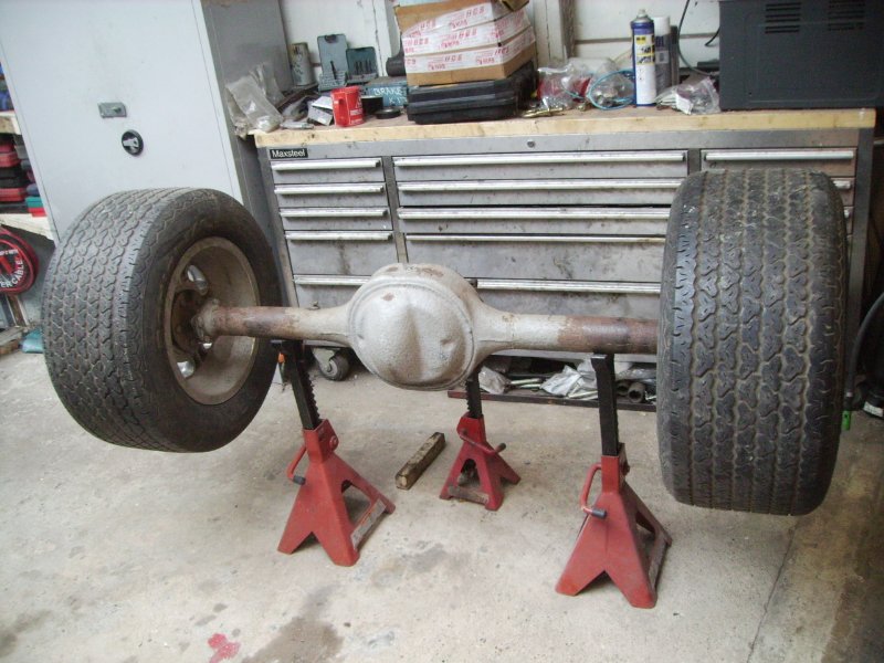

ok here's some pics, now don't keep on at me [-X

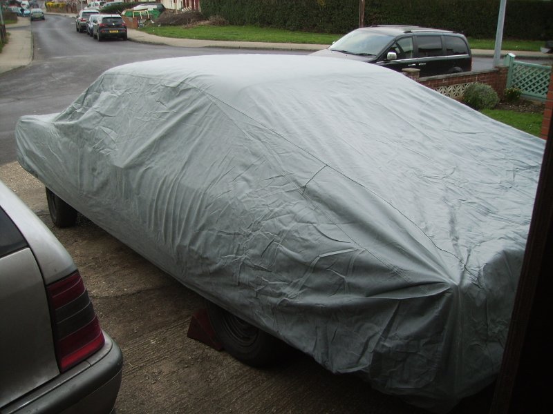

i got the wheels mounted to the axle and i've got some measurements of overall width which is 67" and distance between the tyres at 42". i can add a little once there's a disc each side between the halfshaft and wheel but only about 3/16" per side. the valiant's outside under it's new cover as i've got that anglia back in for exhaust, gauges and a couple of other jobs. these jobs all pay for my car so....
