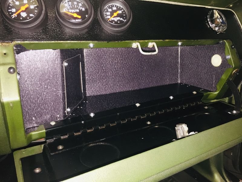

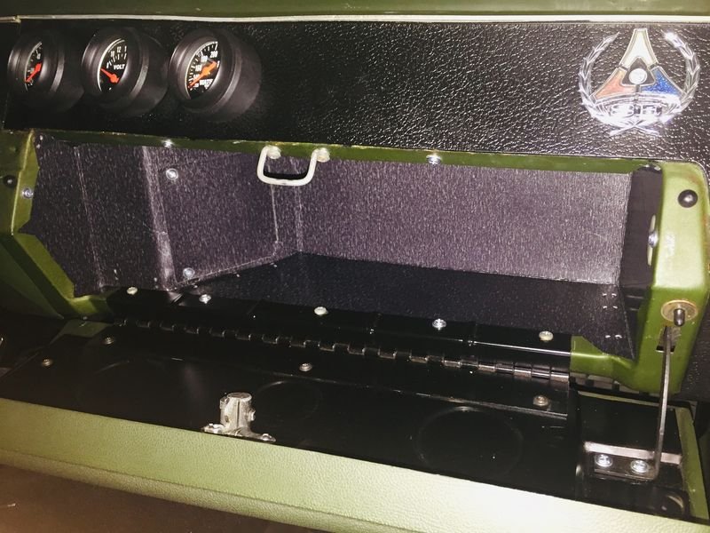

passenger door wasn’t shutting quite right
should probably change the hinge pins
but decided in the interim to lift the door a little by adjusting the top hinge
needed access to the top hinge inner bolt
to facilitate this, I decided to remove the glove box liner
which instantly turned to dust
a new glove box liner was procured from ..
https://www.ebay.com/str/musclemaniac5
my nephew very kindly hand carried it over from Texas, good lad
I should point out he was coming over anyway

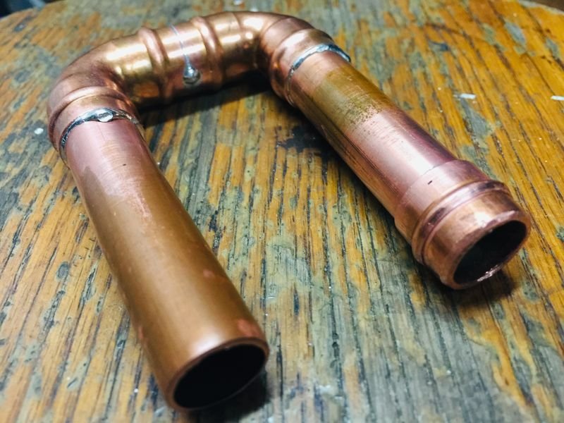

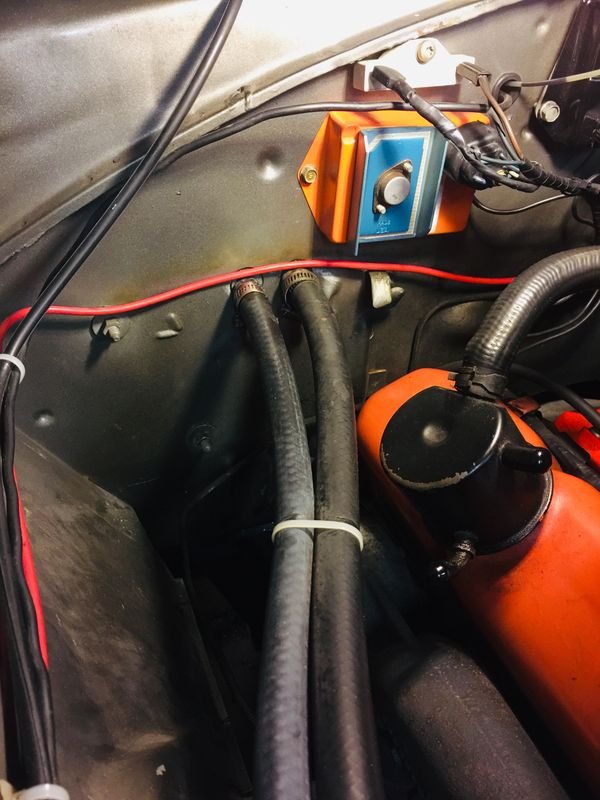

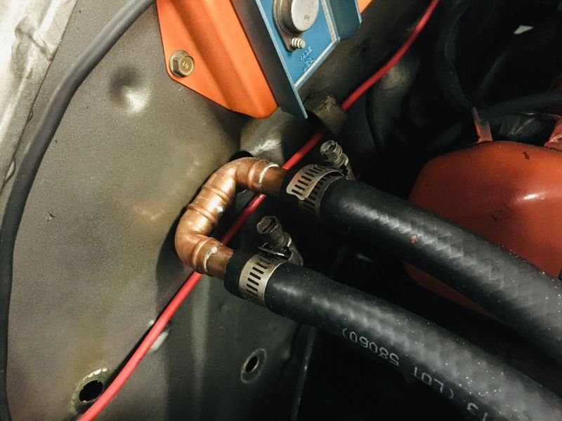

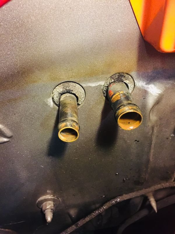

A couple of weeks ago I set to
Firstly under the hood …
Drained the coolant
disconnected the heater hoses
Lashed up a loop pipe so that I could put the coolant back in, in case I needed to run or move Charger before the heater was repaired
Drained the coolant

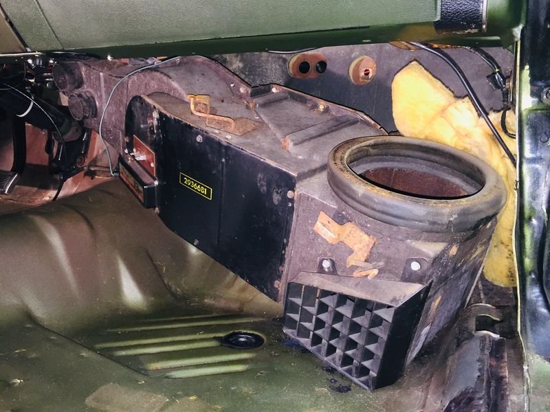

Re: Si's '70 Charger 500

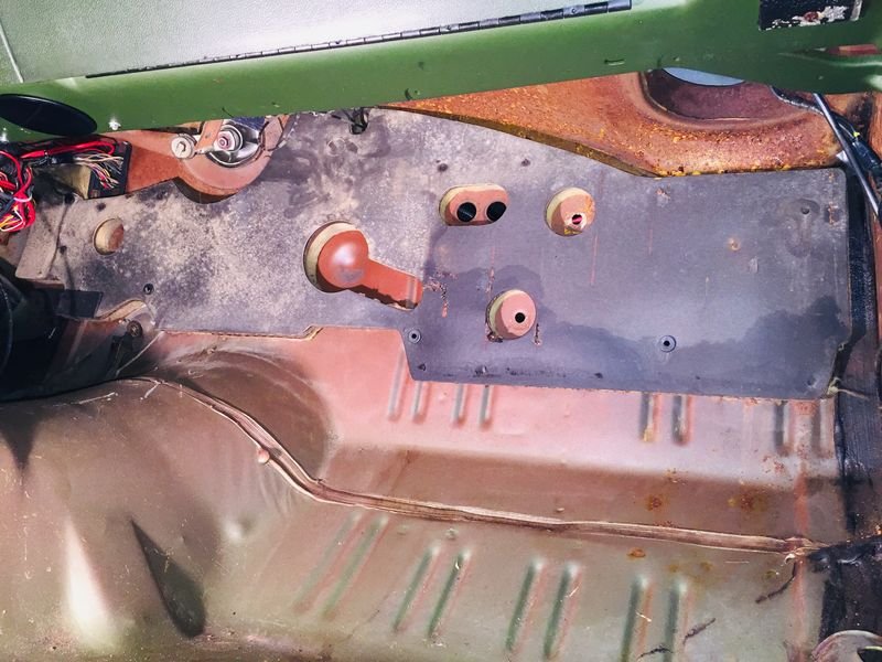

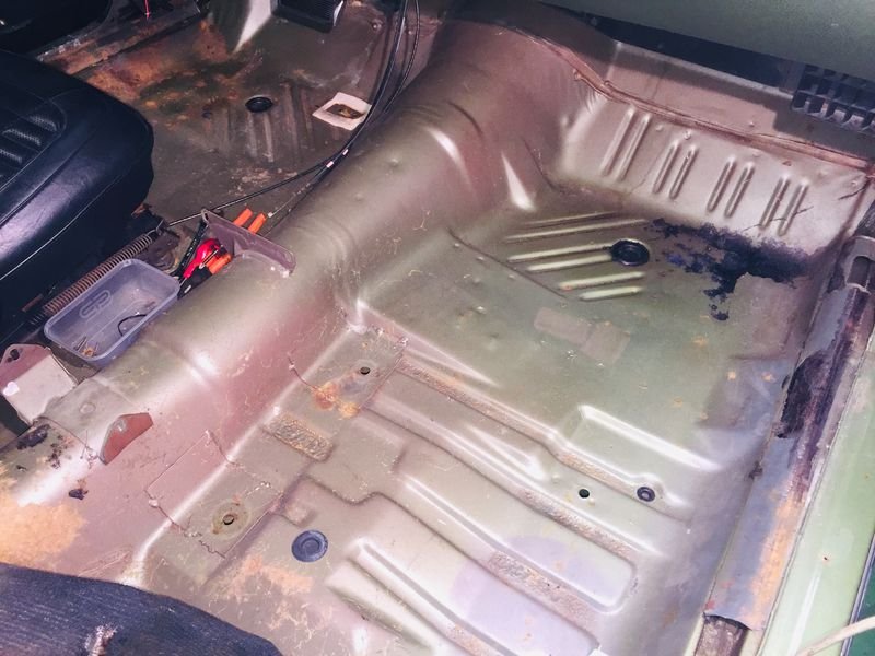

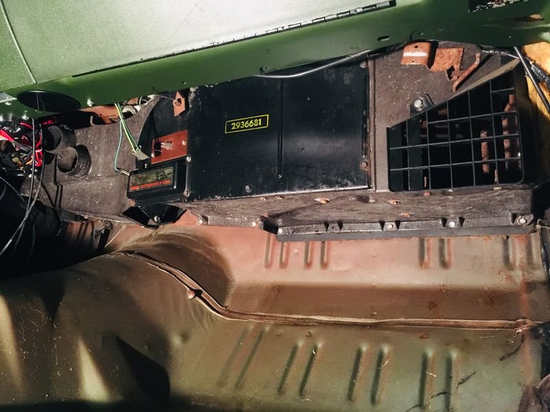

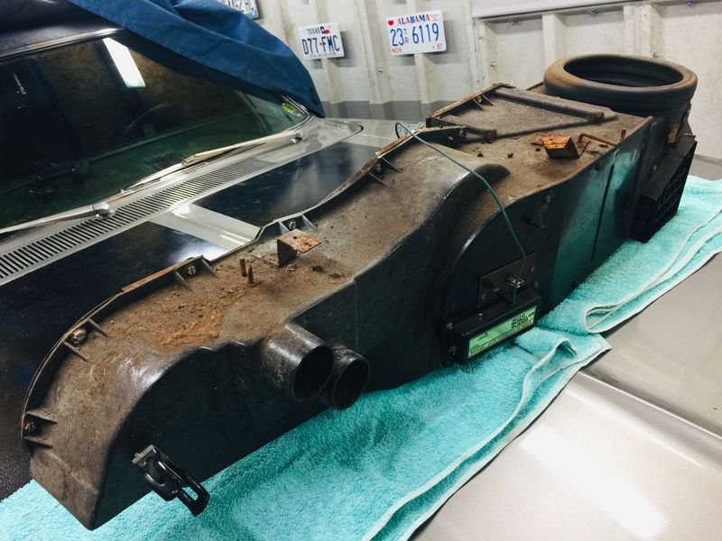

There’s three bolts through the firewall that secure the heater box, removed without issue
Then inside the car, out with the seats
Lifted the carpet
The carpet and underfelt on the passenger side are trashed
Soaked in antifreeze
I could wash the carpet and replace the underfelt
But the carpet is pretty poor, not a loop carpet as it should be and very thin
Have ordered the correct carpet and a couple of other bits and pieces from Classic Industries
Currently on their way over via STS
The floors are in great shape
Light metallic green is the original color
Some light surface rust that I will treat
Reaching up under the dash disconnected the fan wiring, control cables and heater box support bracket
Heater box removed without issue
Lifted the carpet

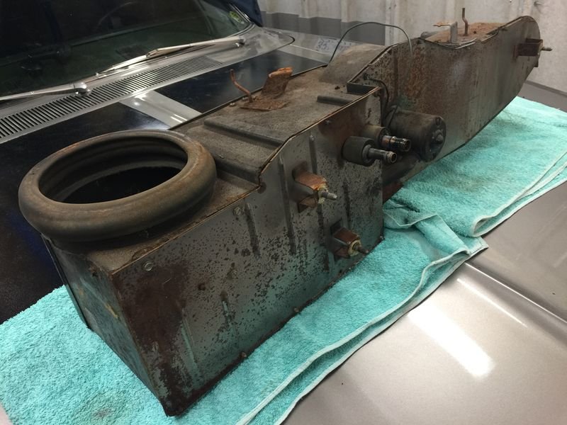

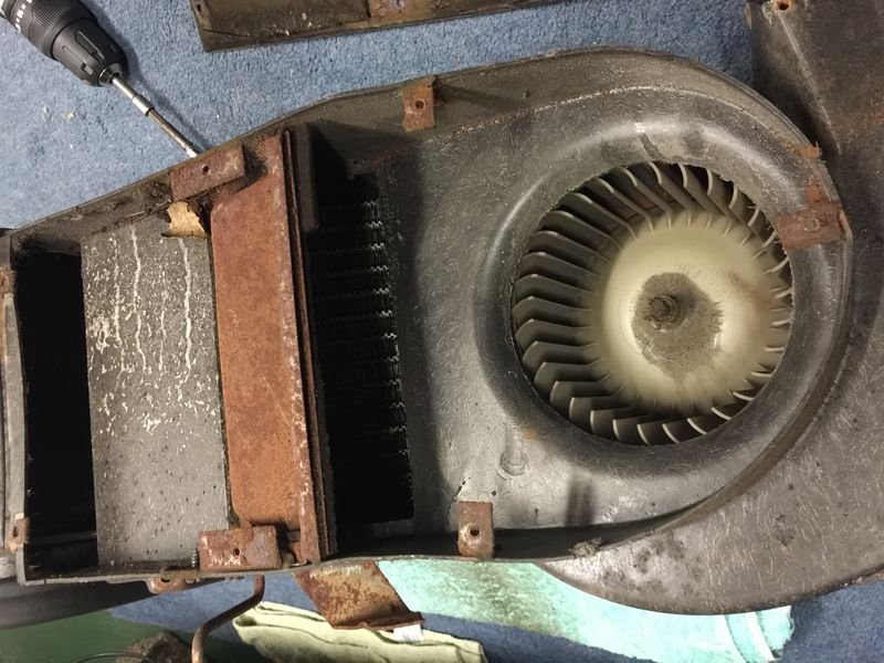

There was a couple of other issues with the heater aside from it leaking
It didn’t particularly emit a lot of heat, except on a hot day
Both defrost tubes from the heater box to the dash vents were missing
The heat / defrost flap was seized solid
The temp control flap was stiff to the point the cable had jumped off the lever
Good news; the fan worked great at all speeds
So as well as getting the heater core out, a complete strip down was on the cards

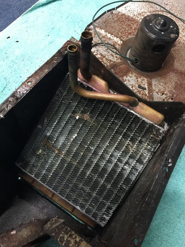

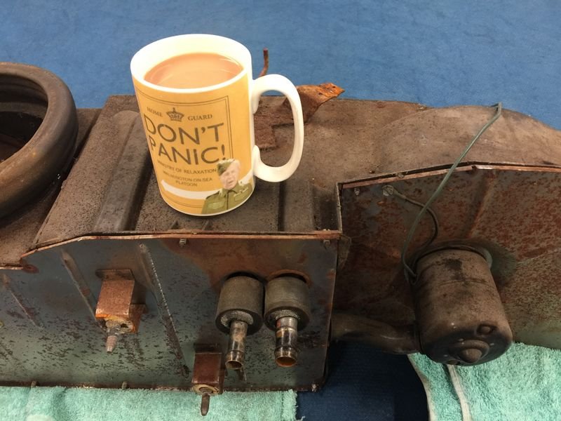

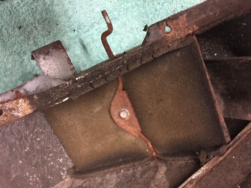

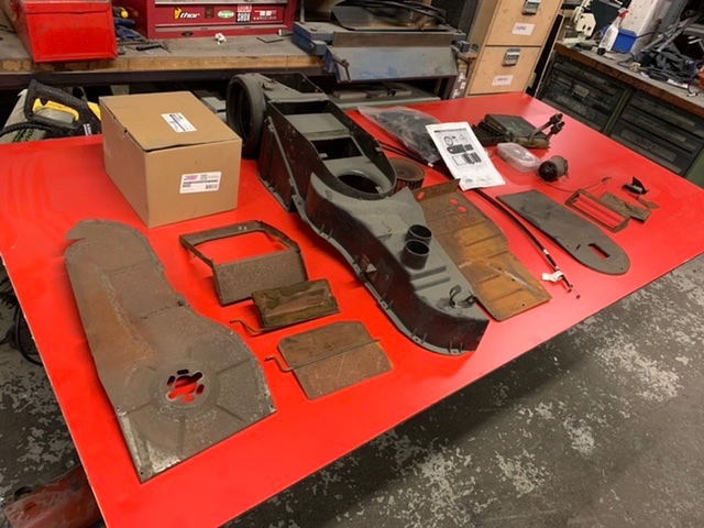

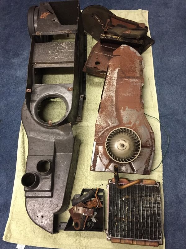

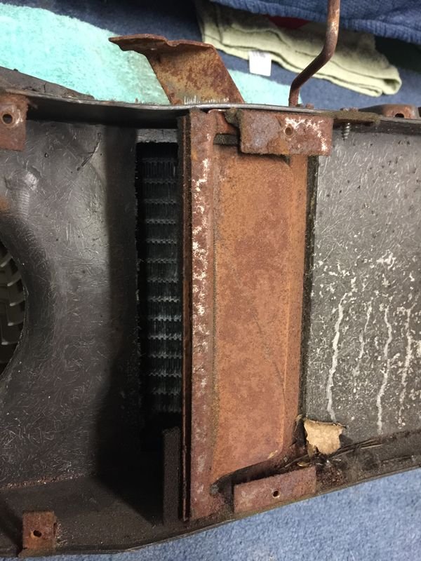

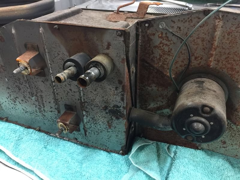

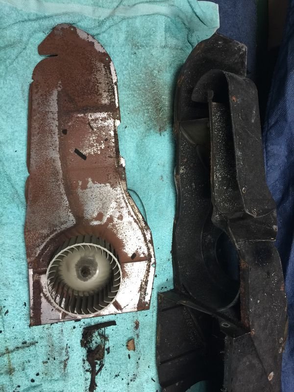

heater box came apart easily
tell tale signs of leakage can be seen on the heater core
all the pieces ready for a good clean

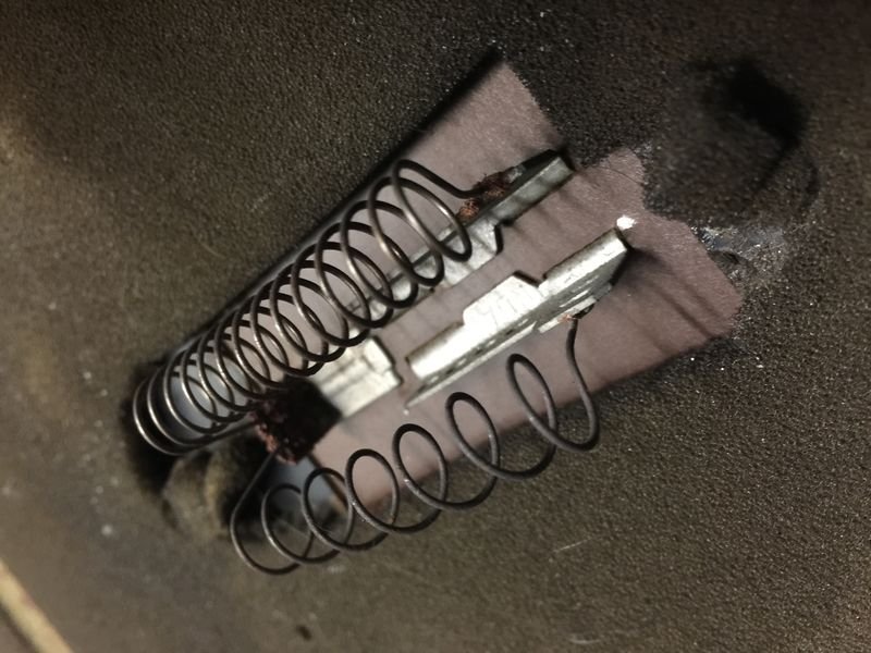

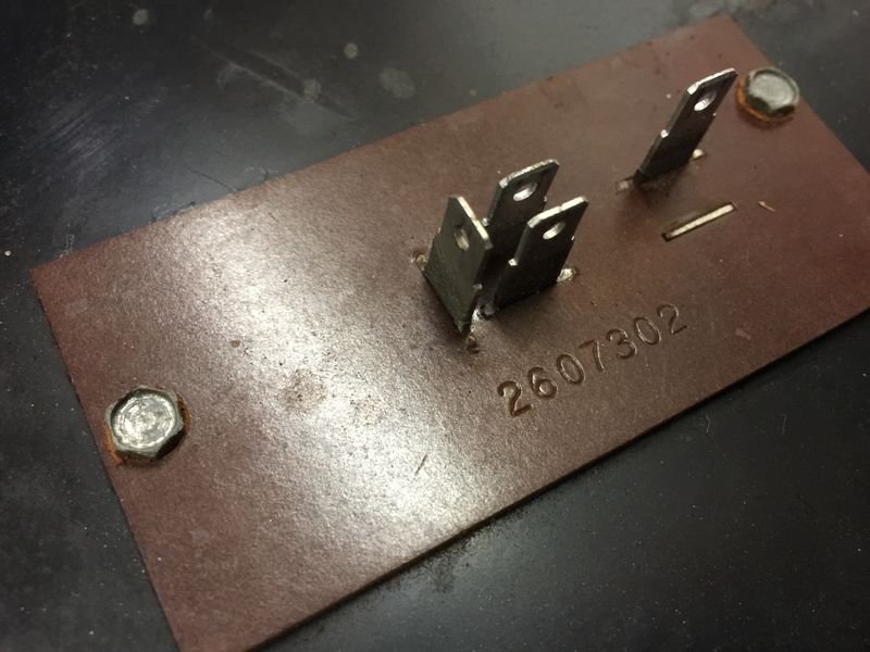

heater FCU (Fan Control Unit)
fan motor resistors are in good shape, fan runs at all 3 speeds
- IMG_1782.JPG (76.52 KiB) Viewed 11696 times
- IMG_1781.JPG (93.78 KiB) Viewed 11696 times

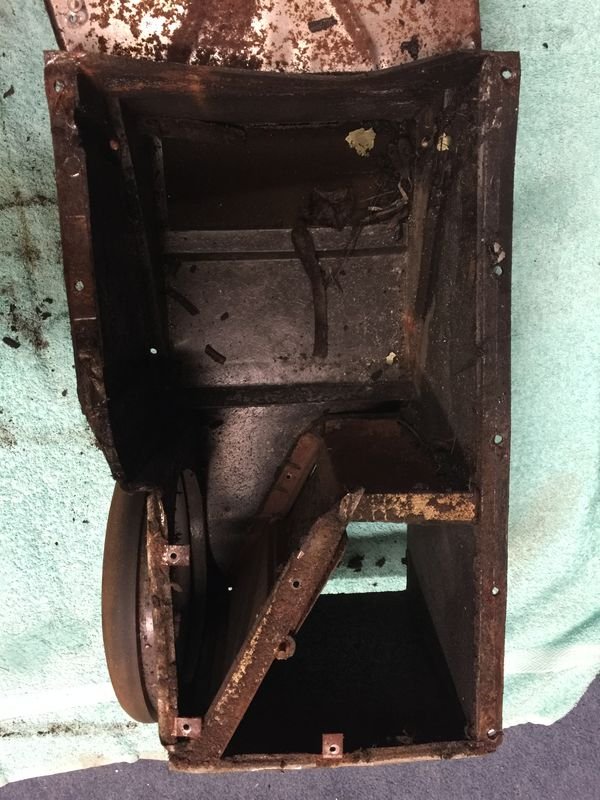

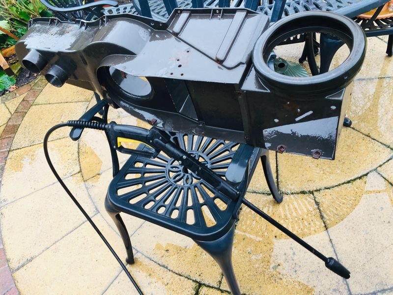

empty heater box gets a power wash
- IMG_1822.jpg (125.28 KiB) Viewed 11696 times
