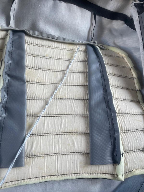

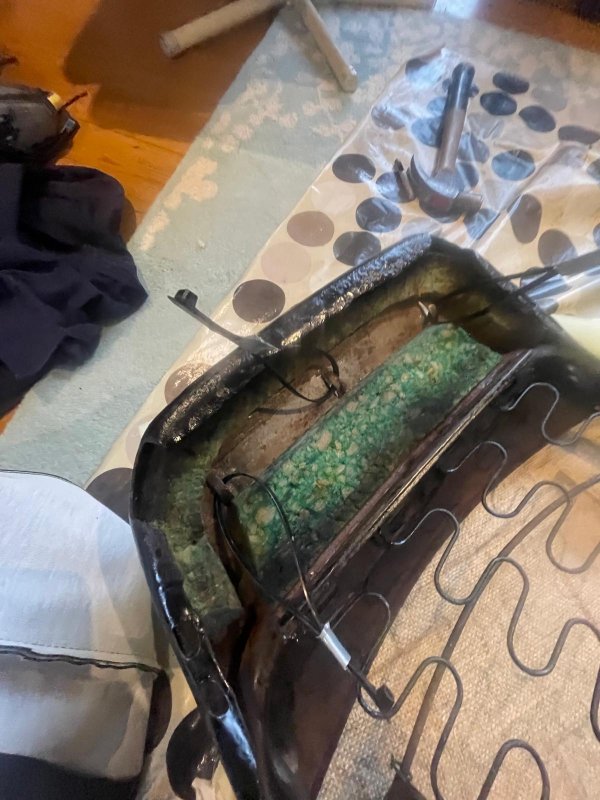

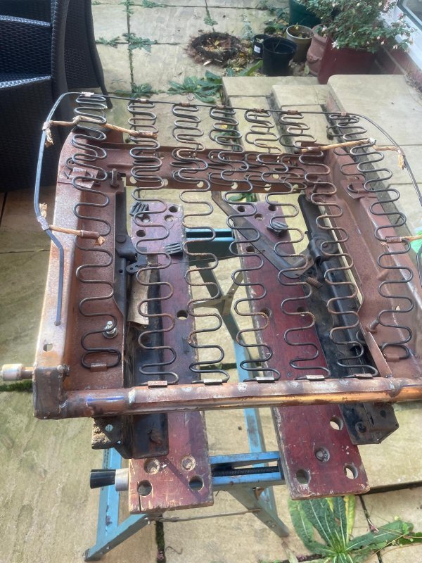

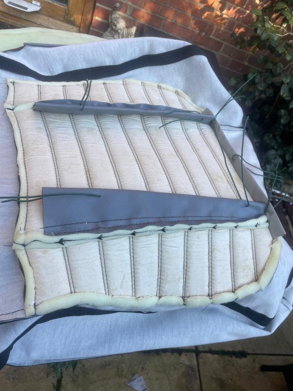

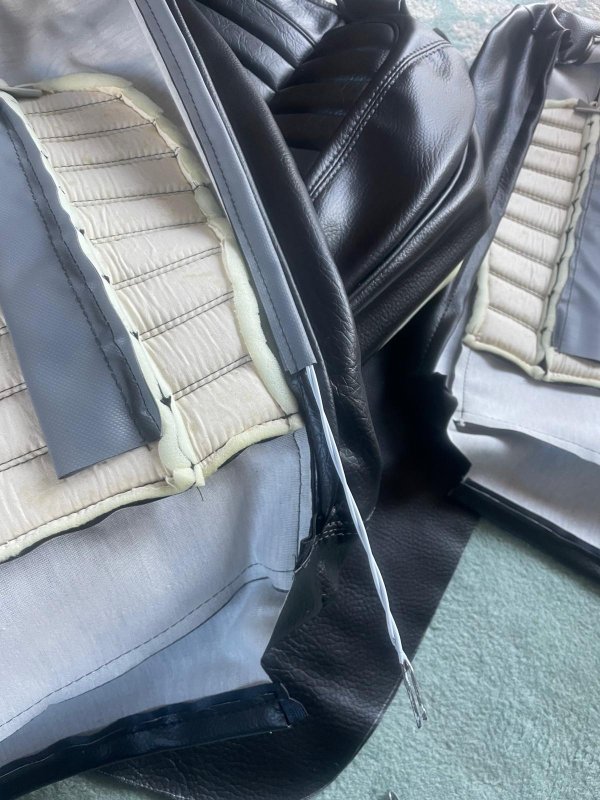

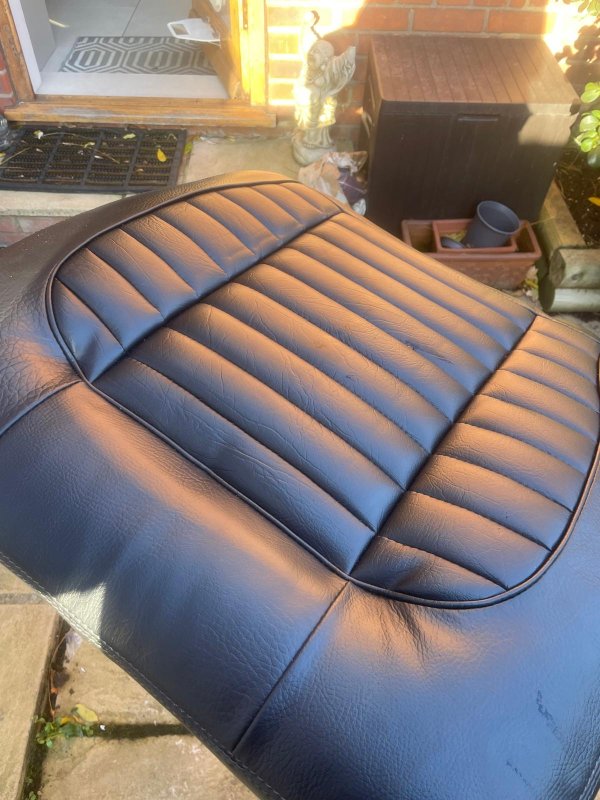

do a couple of hours at a time and walk away when frustrated
job done or should i say 1/4 of the job done

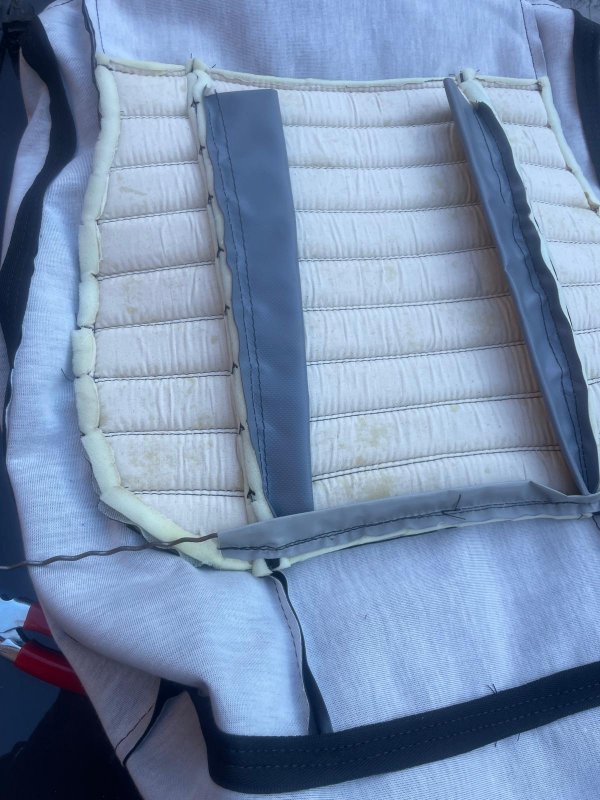

done  but before application of gentle hair dryer

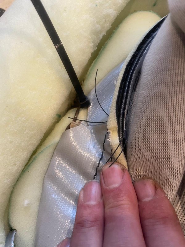

Listing wires in listing wire tunnels and garden wire applied
Listing wire being shoved in front tunnel

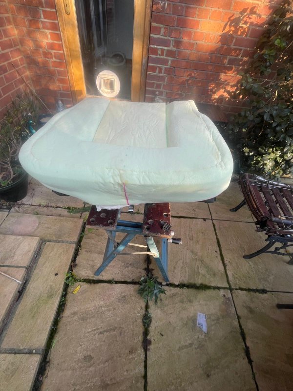

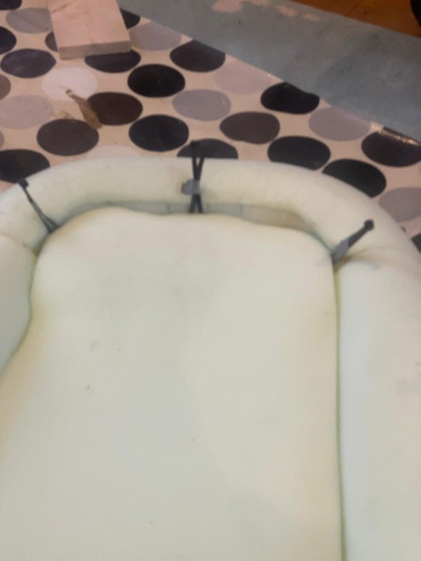

centering the foam
centering the foam

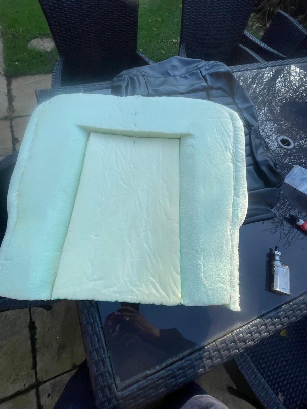

new foam needed the contour valleys clearing out
stuck down foam and then decided to de rust  so did it again  :)

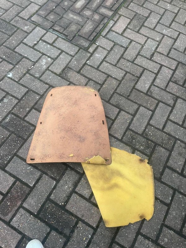

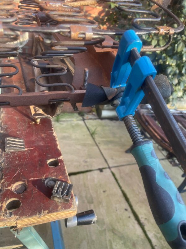

seat pan  flat spring steel spring support and springs.  this was the good seat.  The springs and flat spring steel support on the drivers seat were snapped and exceedingly rusty.shows the "stays"/"tethers between spring 1 and 2 each side
homemade coat hanger listing wires for seat side skirt area
as above
as above

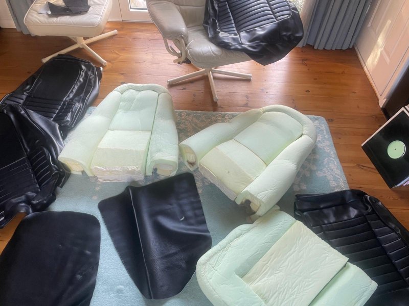

after a few hours unpacked... expanding after being vacuum packed for years

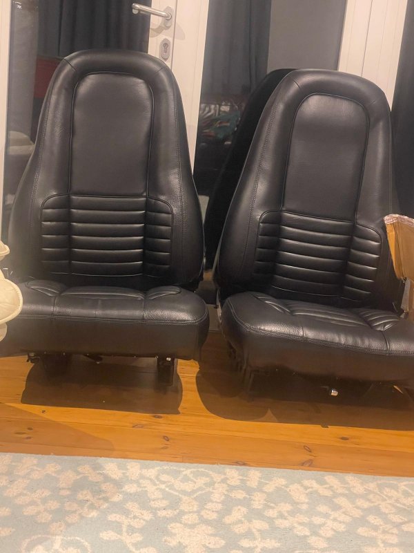

Posts: 7202
Re: Dave999's Aussie Charger
That looks good, Mate!
Would you do it again, knowing what you know now, or would you ask an upholsterer?

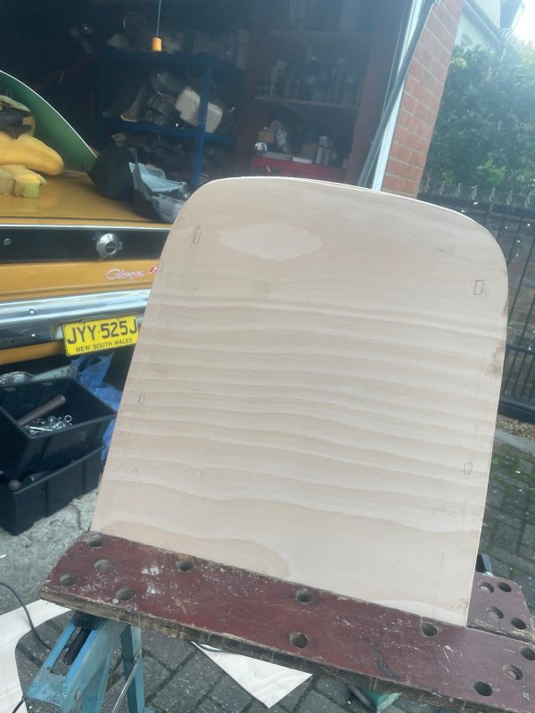

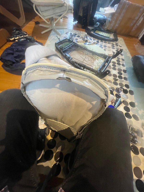

Notes on seat back
1) heavy
2) the rear of the head rest area is plated over, making access very awkward.
3) sort out the seat back, button area in the foam before putting the skin on
4) you need cable ties
5) you will need to cut a hole for the seat back catch at the door side bottom of the skin, don't just hack right through cut a slit and pass the catch and its cable through, you will need to remove the mounting for the seat back catch cable to pass the lot through the hole and the latch is held on with a circlip.
6) having the seat semi reclined before removal makes more space for wrapping the bottom corners properly during installation
7) The seat recline pull lever is on a shaft with a welded on lever or e-clipped lever on the inner end. These break when the outer lever gets stepped on or someone pushes it rather than pulls it. weld it back on, bend the hog ring rail nearby to refit the assembly, then bend it back. Do not get weld in the lever "stop" area. Reset length of pull wire so that the lever is taught but not partially activating the recline mechanism.
8) the bottom flaps at the back of the seat go around the outside of the recline frame. there should just be 1- 2 inches of the cross bar and the mounting arms sitting in view when done.
9) my seat skins used rip stop style tarpaulin like the bottom of a vango tent from the 70s, for the listing wire tunnels. robust as hell. the originals used cotton/calico.... not robust as hell.
method,
1) pull off the back...if it uses the auveco trim panel fasteners some will die in the process, or you will destroy the masonite board
2) start removing all skin edge hog rings

new stuff
1) Repair the seat back, sort out the cable for the seat mechanism and fix the recliner levers.
You also have seat spring stay chains from the hog ring rail to the outer most springs at mid point up the back. if missing make some coat hanger loops that are not in tension when nobody is sitting on the seat.
2) Remove nasty degraded horrible foam around the pressed loops in the front of the head rest section.
3) use same technique as previously, clear out the listing channels in the foam, fold and mark with on the hessian side where the channels are.
4) appraise your listing wire situation
5) mark centre on top and bottom of frame, skin and foam
The tombstone profile in the seat back that maintains the semi bucket shape of the seat is created with either of the following
* a 2 foot long curved listing wire that fits into a listing tunnel right around the section in the cover..
* 3 shorter listing wires, one across the top and longer ones up either side
how you prepare is dictated by your listing wire configuration
long curved wire
straighten it, clean it up as smooth as possible and manipulate it up one side through the curve and down the other side, leaving about 1 inch sticking out at the bottom end of each side..... this is not an easy task.
2 long and 1 short
place onto back of skin following the listing tunnel
cut listing tunnel so you can fit 2 long sides and 1 short cross listing
Both cases
Cut a V in the listing tunnel so you can see the wire in the exact middle of the top
place this V on the centre pressed hog ring mount on the frame and cut a V in the listing tunnel so you can see the wire adjacent to the outer pressing/hog ring mount at either side. do this without the foam in place.
press the listing into the foam and centre it

5) you should have your listing wires in the cover, you should have v section cut in the top of the listing tunnel
6) do the skewer and garden wire routine on the rest of the listing tunnels from top to bottom, where is dictated by 1 long or 3 separate listing wires
7) assembly routine changes here from what you did with the seat base
8) put 3 cable ties around the 3 pressings for hog rings in the seat back head rest area
9) loop up ends and tape together to make an easy to grasp pigs tail so you can use the cable tie later
10) put foam onto seat back and pull the rear down until the hood of foam covers the steel backing of the head of the seat, it should reach the edge of the steel at the back.
11) moved no. 11 to later but called it 11 to confuse people
12) check base of bolsters near the bottom of the seat back are not hung up on hog ring rails, the sides should reach the bottom of the frame sides
13) pull each cable tie up through the holes in the hessian to the front side in the listing valley in the foam and then hog ring the foams calico top and bottom. to maintain its position. then do the sides.
14) force the top listing into the channel in the foam
15) centre it and cable tie though your listing tunnel V cuts in 3 places
16) with the skin centred manhandle the seat back with foam on and cover flapping around, to stick you garden wire through the hessian and around seat back springs.
17) use wires and mole grips to draw the listings down tight
18) use the cable ties at the top to do the same. swap 16) and 17) order if necessary
19) from the front side use your manual hog ring pliers to clamp through the listing tunnel V cut, around the listing wire which you can see in the V cut, through the hole in the hessian to the pressed loop in the seat upper head rest area. really awkward to do. check it is all centred. Middle one first. Kneel on the Bananarama! if you need to. approach from top side or lower side whatever is easier.
20) draw the listings down tighter with your wire twists and hog ring them in multiple places to the seat springs through the hessian backing and listing wire tunnel
21) get you arm in up from the bottom to pull up the edges of the contour foam in the middle to make it look even and nice, especially over the curve of the tombstone section.. same routine as seat base for exactly the same reasons
22) you should have a seat back with a perfect centre contour, in the centre of the back and the bolster /head rest /bottom flapping .

Masonite seat back boards
1) strip off vinyl and manky old foam
2) buy some 3.6 mm ply from wickes
3) used old board as template
5) stick 2-3 mm thick foam to board (peal off pre glued stuff is easiest)
6) lay board on new vinyl
7) add heavy books to squash foam
8) spray edge of board and vinyl with contact adhesive
7) wait 5-10 minutes
8) fold over and glue edges, with a little bit of tension applied
9) fit stupid auveco trim panel fasteners
10 swear a lot while fitting to seat, you have six of the fasteners to fit into hand drilled randomly placed holes, where the positioning is dependent on the size of the bit of scrap welded to the frame.... and the tim clips do not like to be undone once applied
Done
do it all again for seat no. 2
I Have to say, once done the seats are firm, in an almost modern car sense
i had to remove some spacers so my head didn't get too close to the roof
driver fatigue greatly reduced
i'm higher so i can drive with my elbow on the window sill
i no longer have to learn how to walk again after driving.
i have much better angle into the clutch and i'm not fighting the edge of the seat, i was basically sitting in a bucket previously. so i don't get shaky leg when stuck in traffic.
the seat base on the drivers seat was just held together by the skin the spring steel spring support was snapped....its so much better now.
well worth doing
Believe a proper trimmer and upholster has things a bit like small anvils or shoe lasts on their bench so that can apply force in appropriate places to push listing wires down to springs and avoiding the need for garden wire in many of the areas i used it. i.e probably many better ways to do this.... rather than what i made up as i went along.
if your seats are knackered give it a go...
seat back pattern aligned with seat base pattern...careful centre marking was done
cable tie in use. still a long way to go
cable ties
cable ties
