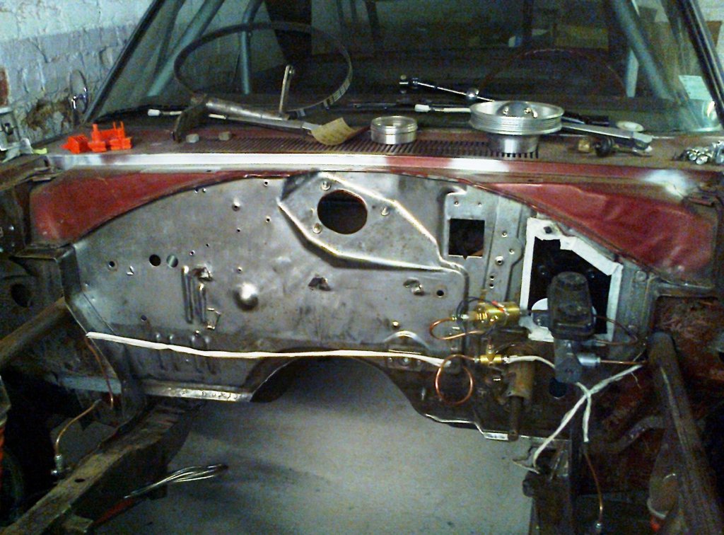

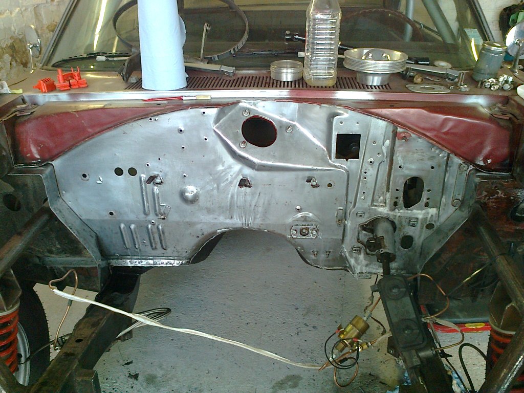

I've only gone and bare-metalled me bulkhead :roll:
It'll get the DE-OX and POR15 treatment tomorrow.
I'm gonna paint it body-colour, it doesn't have to be a great finish, so i'll use an aerosol.
Main thing i'm after is rust protection so... should i first hit it with Zinc primer, Gravitex stone-chip or something else?
looks great I'm painting mine the Ivor way check out his website for info.
What did you use to get it to bare metal does not look like a grinder job :? :thumbright: :thumbright: :thumbright:
Posts: 8368
Wire cup brush in a grinder for the accessible bits, various smaller wire brushes in a drill for the more fiddly bits, then Nitromors to finish. Hard going but effective :thumbright:

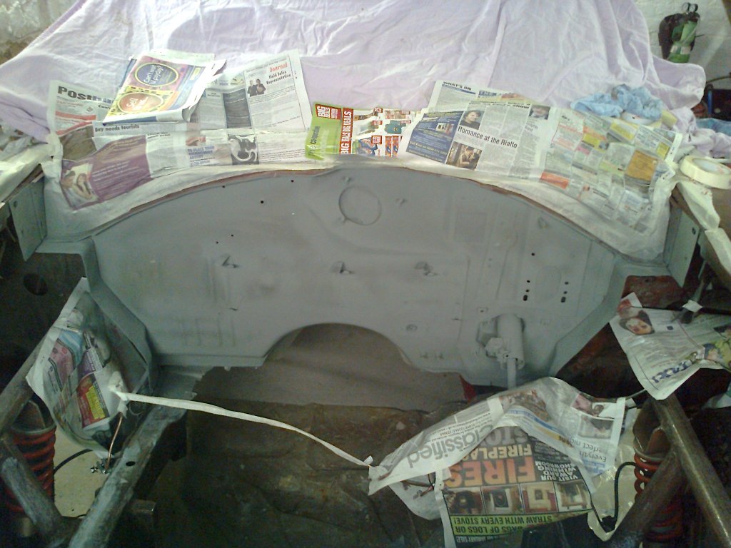

Well with Antons encouragement i've done it properly now :roll:
Por15'd and zinc primered. Just have a fan heater warming it up ready for some colour today :thumbright:
Oh and i found some grey Scotchbrite Ivor!
Bulkhead Zinc primer on.jpg (140.94 KiB) Viewed 1028 times

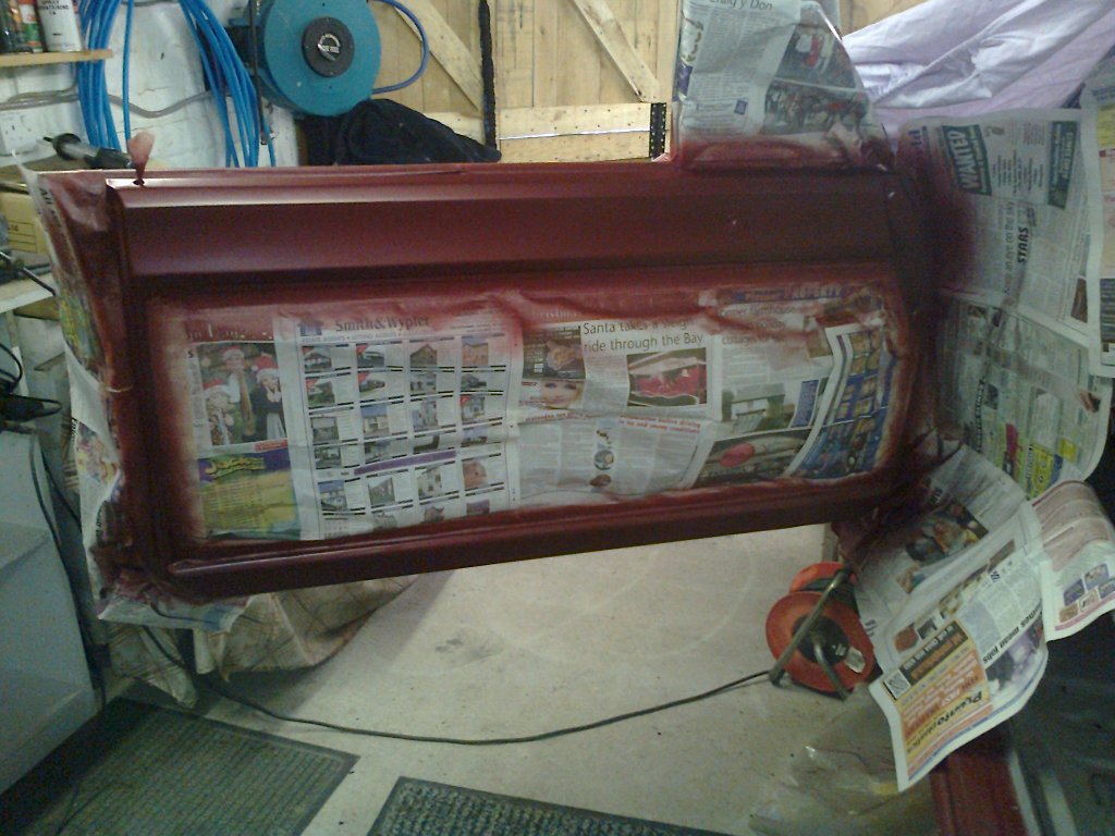

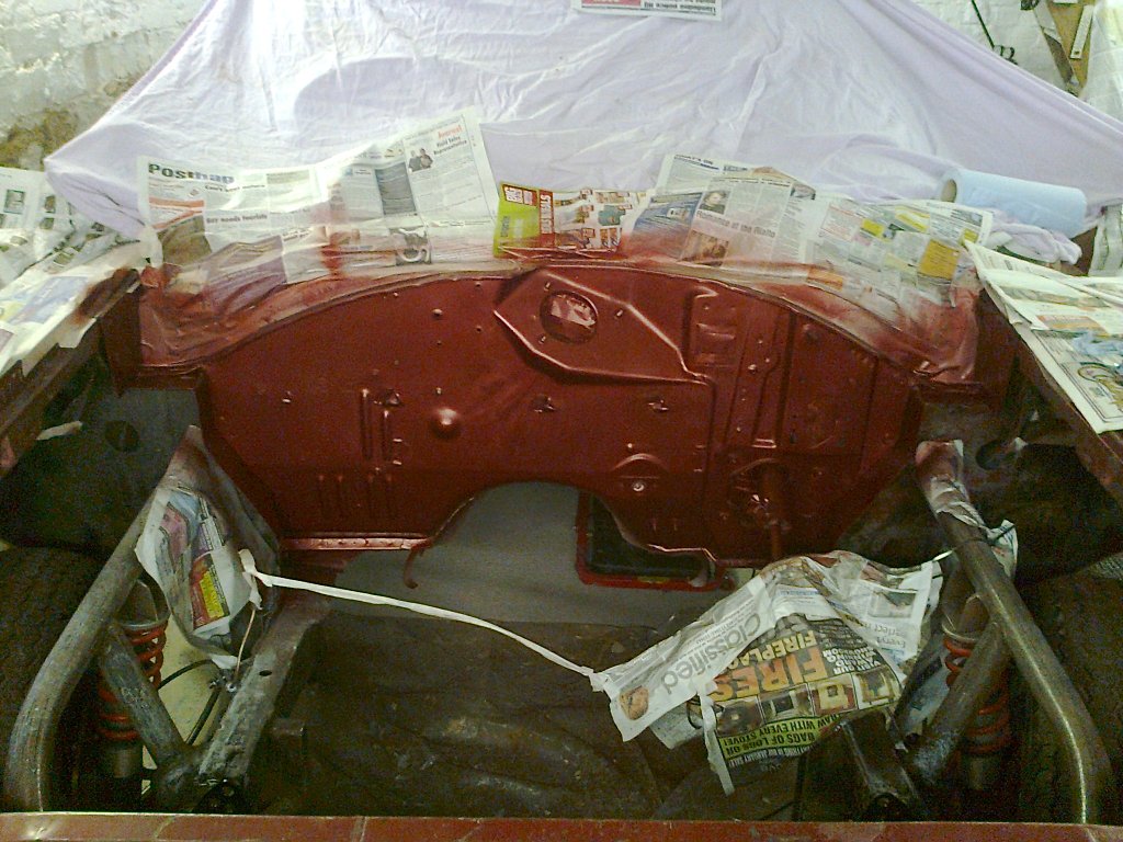

Posts: 8368
Coloured, did the inside of the door too inbetween coats...
Drivers door coloured.jpg (146.49 KiB) Viewed 1003 times
Bulkhead coloured.jpg (180.07 KiB) Viewed 1003 times
