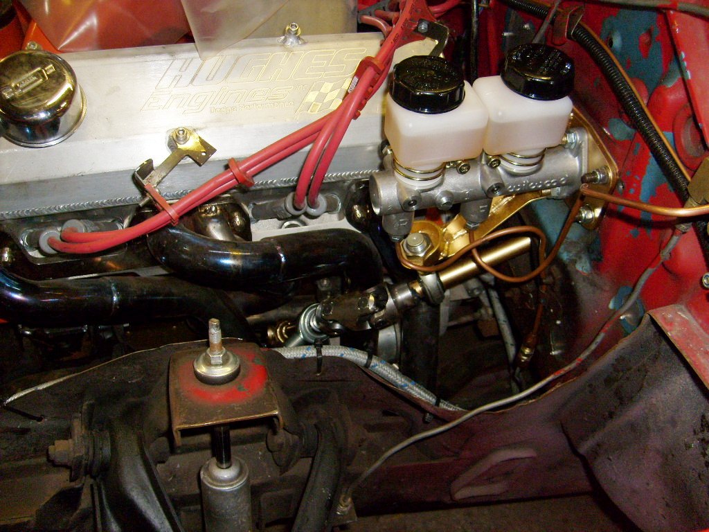

Jon, a stupid question, but with no inner fenders tieing in the frame rails to the top of the bulkhead / rad support how are you constraining vertical movement and twist in the frame rails?
Only asking on the strength of the most recent pics. :)

Am still using an original unmodified heavy duty k frame which ties the chassis rails together. The front valance / radiator support is still mounted on the frame rails and the wings are still supported at their front and back edge and along their entire top length via the original return edge.
The unibody floor is untouched .. I have only cut out the boot floor.
Car drives fine and no twisting to date ... don`t forget this is a short lightweight low powered A body

Ahh, so a hole has been cut in the fenders as opposed to removing them. The top return must be just outside the pic.
Low powered? Joke, right? :lol:

This is what it looks like with the final 1.5" of front suspension travel locked out and wheels in the air ... I can easily disconnect it if it fails to transfer weight to the rear.
My thinking behind this is to keep the wheels pointing / leaning where they should be ( rather than something like Tig`s front end on launch )
Will have to see if it works or not ??? or where the ultimate setting between weight transfer and steering is ??
