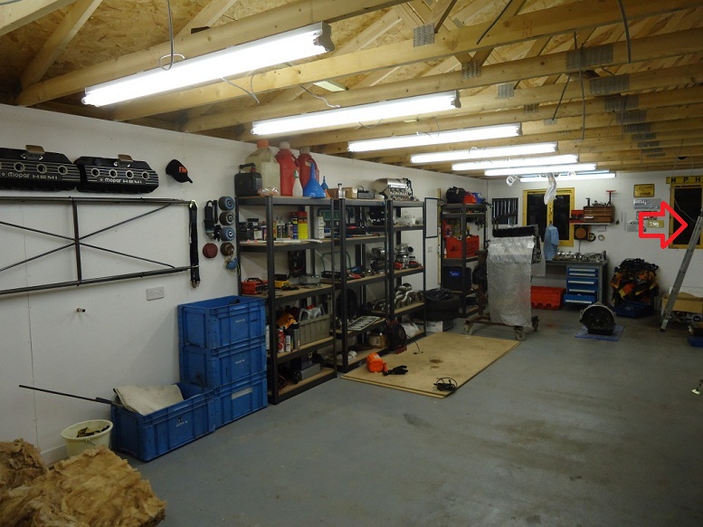

What`s the ladder for :? :? :? ...................to climb over your wallet ;)
Dart Vader
Posts: 3532
Location: Swindon MMA180
Post by Dart Vader »
So he can peek in windows? :D

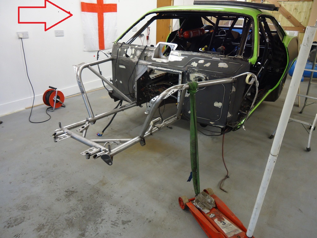

I managed to get some work done on the front chassis & bulk head in between the adverts.:D
Moved the ladders in shot again, to ensure Andy doesn't miss them. ;)
I have mainly been removing surface rust from chassis, from where the car was sitting in the damp old garage.
Made a few plates made for filling a few unwanted holes, once there in, can start priming & painting after a clean up.
Got a bit bored on chassis cleaning, so drilled a few lightening holes here & there, to break up the boredom
If you're wondering about the jack, its to used as ballast, to hold the front of the car down. Whole car is virtually balanced on the 2 rear axle stands, I took axles stands out for the photos.
Nice to see that you`ve got my "PICTURE" on your wall :thumbright:
By the way "MARKIE"............................ that`s one "BAD ASSED MOPAR"!!!!!!!!! Shame about the paint :cry: :cry: :cry:
