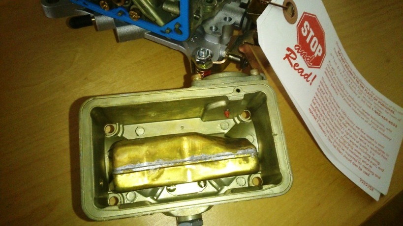

difficult to see but does the needle valve, where it touches the float, drop off the edge of the bump and get caught up?
try making that bar between the float unit and pivot pin completly straight then readjust the float height.

Shouldn't the spring stop the float bottoming out in the bowl?
GJUK
Posts: 2486
Post by GJUK »
db wrote:Shouldn't the spring stop the float bottoming out in the bowl?
The spring does not do that at all at the moment. Its next to pointless.

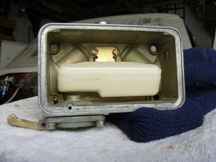

the needles does not seem to foul on the float stem.
Posts: 8368
This is where mine sits.
The spring is a totally different design to yours so no point showing a pic of that but yours must be assembled wrong to sit so low.

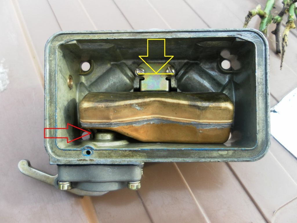

GJUK wrote:This is where mine sits.
Is the red rubber check valve fitted - red arrow? I can't see this. This acts to prevent fuel flowing back into the fuel bowl when the accelerator pump is operated If not there should be a ball bearing affair there instead that does the same thing. The red check valve should be in your rebuild kit
You can check your float level dry, just turn the float bowl upside down and adjust level until the gap (Yellow arrow) measure 3/8"
dustymopar
Posts: 1448
Joined: Tue Aug 01, 06 6:39 pm
Location: Chelmsford
Post by dustymopar »
BTW, the check valve has a long end on it to stop the float bottoming out

Interesting. I can not see that is in there at all.
Let me check the box and see if I can find that spare.
Well spotted.
Jon

You will need to take the diaphragm pump & diaphragm off to check. Your friend might not have replaced this as you have a 50cc pump there and 30cc diaphragms generally come with a standard kit ;)
Posts: 14426
Double pumpers use a check ball, Vac. secs. use the red rubber ;)

Sorry chap, I would disagree. Here is a brand new one here direct from Holley that has the red rubber umbrella. I have seen many older units with this too.
dustymopar
Posts: 1448
Despite all that, looking at both your float bowls, the bowl floor is slightly raised in the pump area so guess you have bearings in both ;)
My money is still on the needle valve :mytwocents:
