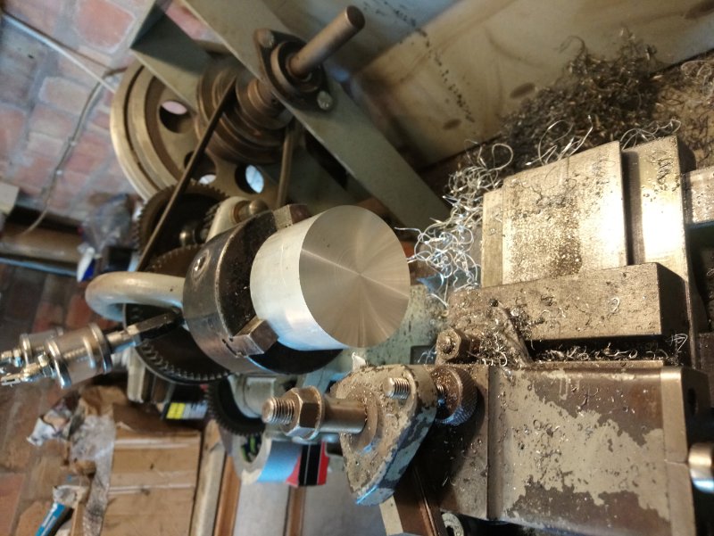

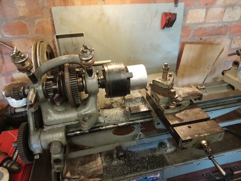

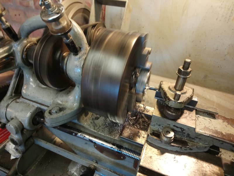

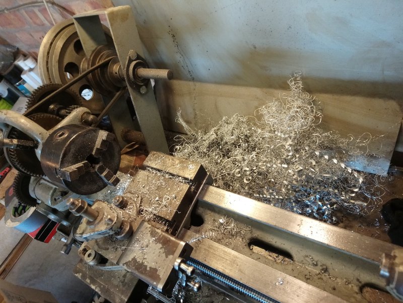

Another spell on the lathe today.
My year of Charger was supposed to have had a rubber "Rag Joint" between the Pot Coupler and the steering box, this was long gone and had been replaced with a bodge of 2 discs probably made out of conveyer belt. This meant the column had been moved down closer to the dash and the steering wheel rubbed on the column.
Research online found them to be hard to get and if found rediculously expensive. On some stateside forums there were suggestions of using a Hockey Puck as a substitute, apparently it is the same size, I did buy a Puck. Also found a firm that sold an Alloy coupler for $120+shipping, so I turned my own instead.
- DSC_1016.JPG (102.71 KiB) Viewed 3477 times
- DSC_1015.JPG (103.09 KiB) Viewed 3477 times
- DSC_1017.JPG (127.08 KiB) Viewed 3477 times
- DSC_1018.JPG (103.39 KiB) Viewed 3477 times
Re: Lots of Love Needed (A Tall Order)
Good job! Nice little lathe, Drummond ?

Cheers

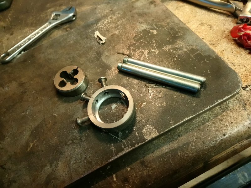

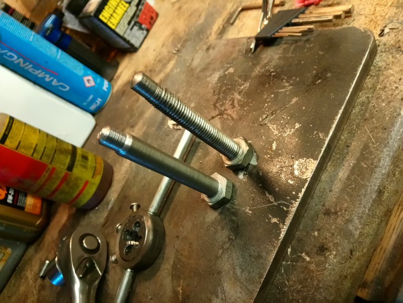

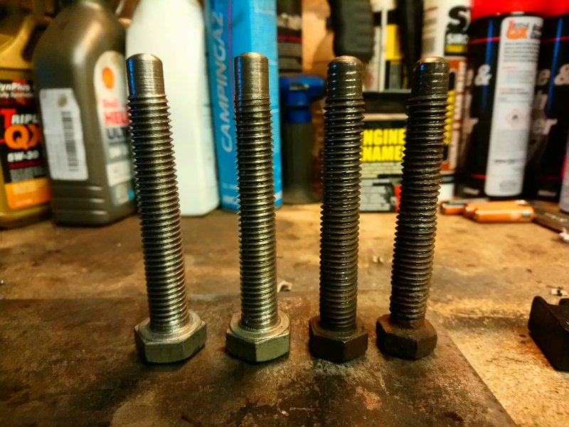

Trying to get everything sorted for the trip north next week and Pete's advert for a torsion bar adjuster in the "Wanted" section jogged my memory, I had a feeling one of my bolts wasn't too healthy.
So back onto the lathe and turn down an 10.9 tensile M16 bolt of a suitable length to the required diameter and rethread to 9/16 unc. Since I didn't possess 1 1/2 inch Die holder I had to make that as well.
