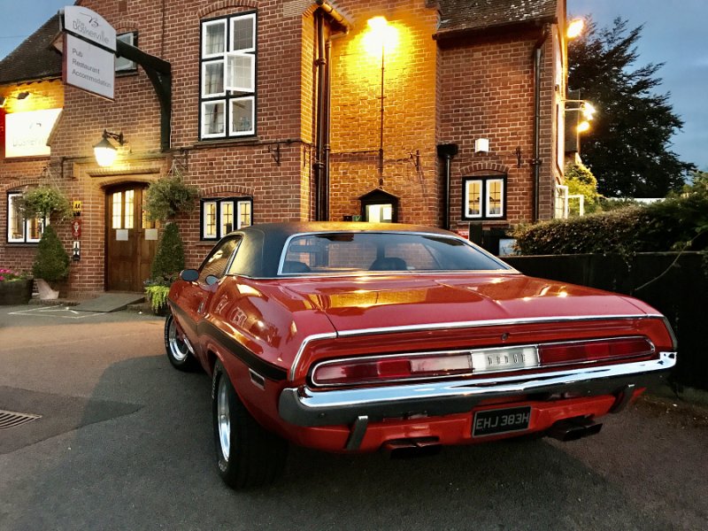

Couple of jars down the local to celebrate being 48 today.
