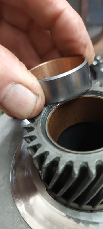

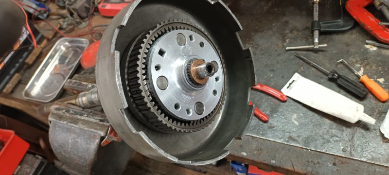

Got a bit more done , strip and inspect , check clearances, all good. Next the valve body , and the TF2 re program kit.

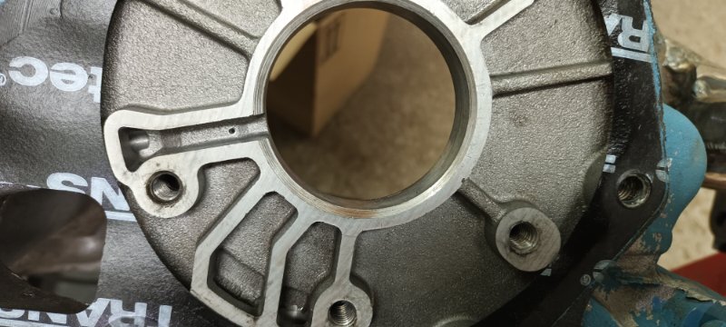

Done the sprag oiling modification.

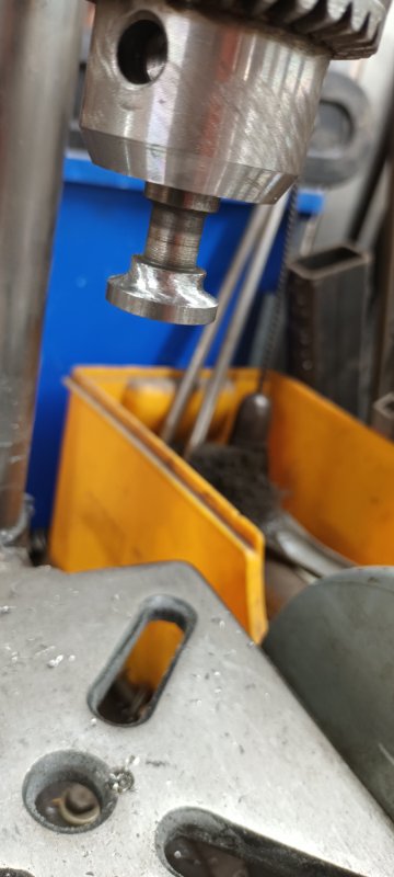

Tomorrow I've got to make up a tool to compress the front band servo.
Posts: 14582
Re: Johnny's Dart repairs
That wasn’t so bad was it? You can use a G clamp and a socket to compress the front servo, thats all I used for years, in fact my present tool is just an improved version of that.

My g clamp wasn't big enough , so I knocked up a pusher out of some scrap, that worked.
Getting there now.😁

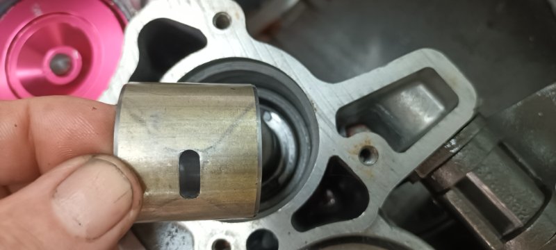

What's with this !
This came apart with this bush on top , and no springs on the accumulator, any ideas as to why this was done ?
