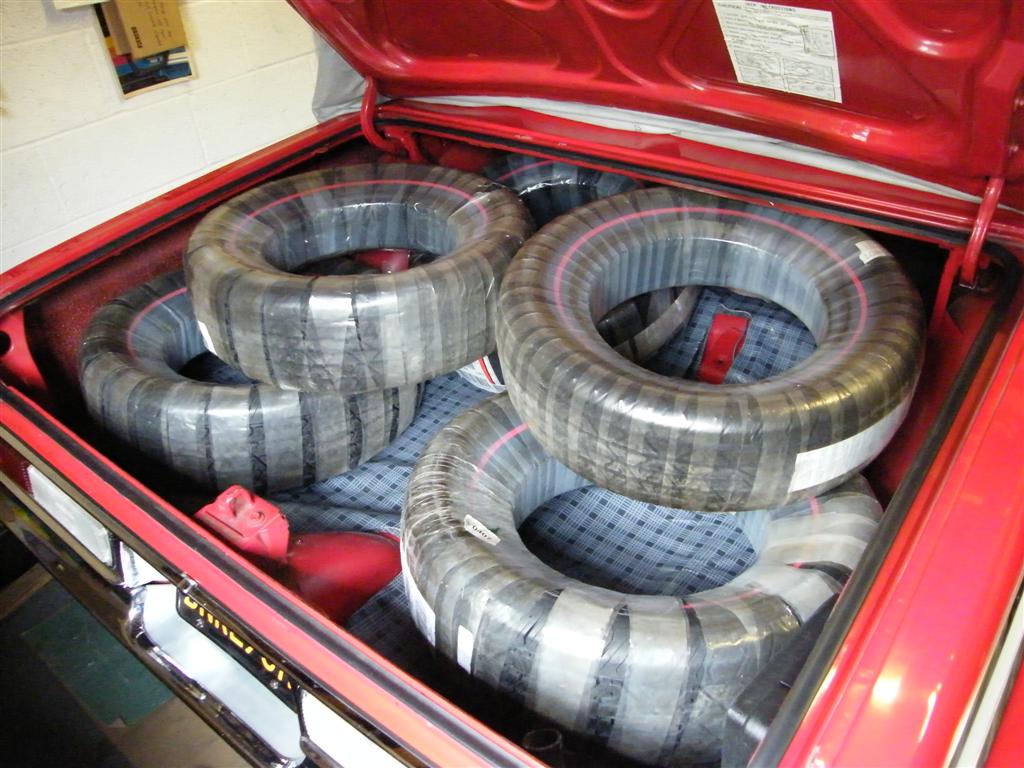

One successful job that was accomplished today was to collect the tyres we ordered from Summit, from Ron @ STS Imports.
215/70x15 & 235/70x15 BFGs. Not exactly the widest tyres that will fit under a b-bod, which i know we'll get slated for, from some areas
but they are the widest you can get in redlines. Or at least proper redlines that are legal to import, with proper red lines that arent just stuck onto plain tyres (eg Diamondback)
Not quite ready to fit them yet so for now they'll stay out the way in the Polara's trunk.
Yes that's 5 tyres in there. Try that in your cuda/challenger

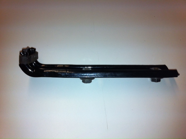

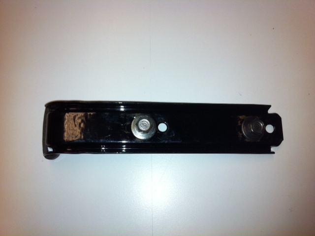

Hey Guys
All looking great.
It looks like the widow up position stop is missing from the front door it mounts tot he door in those two diagonal slotted bolt holes. if you need a picture of what it look like let me know and I will take one of mine.
If you don't have it and you wind the window up too far and close the door you could smash the glass. The stop to adjust the down position is on the regulator by the window winder the nut with slotted screw in the middle.
All looking great.
yes a pic would be useful. But when we wind the window up with the door open, I'm sure it stops at the right position - ie not too high. We've had the car for nearly 27 years so thought we'd have smashed the glass by now if there was something missing
Unless Stu lost it while he was fiddling around

With the emblem,how about carefully drilling the backs of the rivets off then with a depth stop drill the emblem to take self tappers from behind?
1965 Belvedere 2 426 Wedge.
Here are the pictures of the stop bracket you seem to be missing.
When I don't have this adjusted right my window will hit the rubber stop at the top of the quarter window and them the back of the window will go up a bit higher and snag on the stainless steel trim above the door opening.
