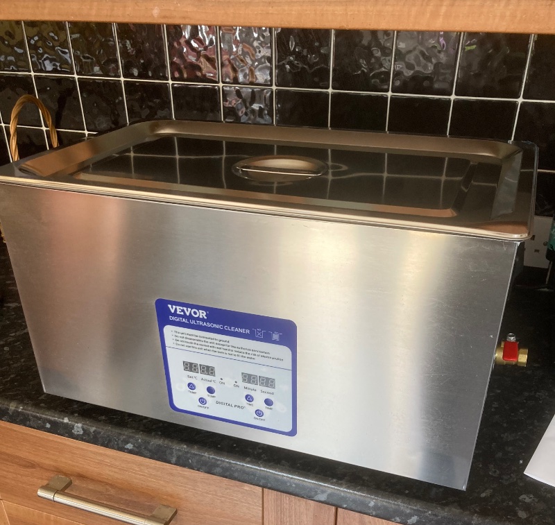

In the meantime, this just turned up!
Didn’t realise I’d ordered the digital one by mistake.
No idea what I’m doing now, but will be playing with bits of old carb as soon as I figure out how it works.

looks the same but different to mine
every batch Vevor gets is slightly different
its cheap and competant chinese stuff...
as long as you don't read the instructions which will be in chinglish you'll be fine.
suggest you swap to a UK kettle/computer lead with a UK plug.
its a metal thing with water and eletcricity in it
the lead and adapter that is sometimes supplied has no earth pin connected...
its illegal to sell them like that so you are within your rights to have a go at VEVOR if they didn't send the right lead
PS the right hand side is a timer for the cleaning routine
the left hand side is the heater
the display above heater settings works if heater is on or off which is useful for keeping an eye on temp increases caused by untrasound
most relevenat when doing LP records (no more than 35* otherwise they go all bendy)
not that relevant with a hunk of aluminium
you just need one o these now and you can clean your old shawadywady LPs

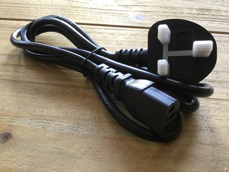

Thankfully, it arrived with the correct plug, so all good.
You are right about the Chinglish, my personal favourite is “When the item is smeary of extraordinary dirty”
- image.jpg (148.69 KiB) Viewed 2089 times
yep, i've seen chinese plugs with a bit of bar soldered in where the fuse should be
- Stu
- Posts: 7191
Well this one definitely has a fuse in it, but it’s a moulded plug so will have to see what happens…
Currently, I’ve had to pitch it outside as the crazy strong Chinese shipping chemical smell was killing me…
yes that lead will have been added in the UK
it came so quick it must be from UK wharehouse
somone will have taken it out of the box added a lead and checked it worked.
i.e better to pay £5-£10 more from VEVO than just get from aliexpress
its the times when the ship direct from china that you get shonky bits
