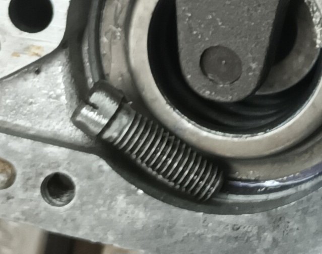

I can't find a place for this home made ,ground down screw, it was in the pot of parts I removed from the rear servo.
Is it a home made blocker, if so do I need to put it in ?
Posts: 14582
Re: Johnny's Dart repairs
That looks too short to be a blocker rod, can’t think what that would be for!

Blue wrote: Thu Jun 04, 26 5:32 pm That looks too short to be a blocker rod, can’t think what that would be for!
Bugger, I was hoping you would have an idea , I wish I'd taken a photo now 😕

Yes always soak new bands and frictions. That bolt certainly doesn’t belong in the front or rear servo’s

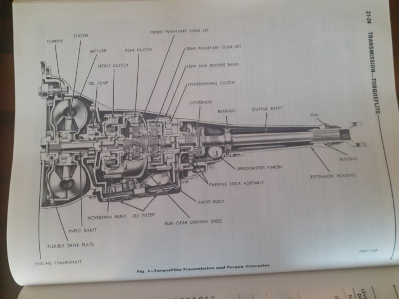

Just had a look through the 3 books I have that may assist. The assembly manual just shows the trans as a 'bolt in' unit without any exploded diagrams. The Torqueflite book has hundred of photos but nothing obvious on first glance. My factory manual has the cross section diagram but nothing in the way of an exploded diagram. Im wondering if a factory parts manual would help?? They have very detailed diagrams. I have one on disc somewhere but nothing to read it on. Im sure you can access them online via a website that was posted somewhere on here.
Out of interest, what does the head look like? Cant quite see if its got a slot, philips or flat bolt just so I can see if it matches anything as Im going through the books with a brew.
Screenshot_20260604-183823_Samsung Notes.jpg (51.6 KiB) Viewed 277 times
